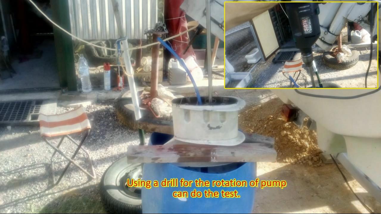

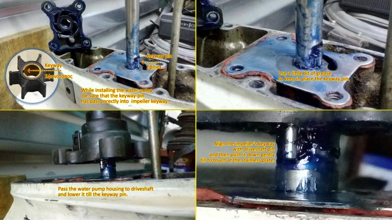

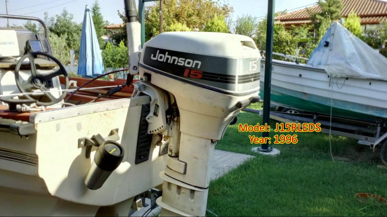

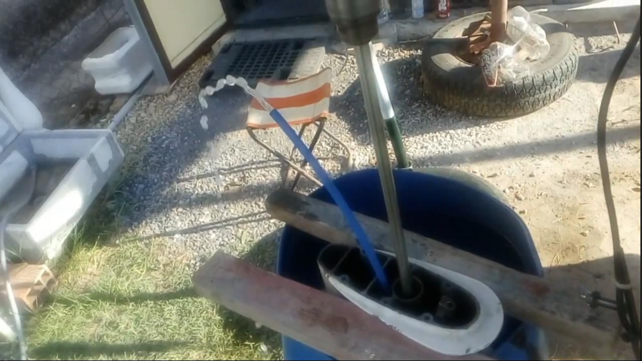

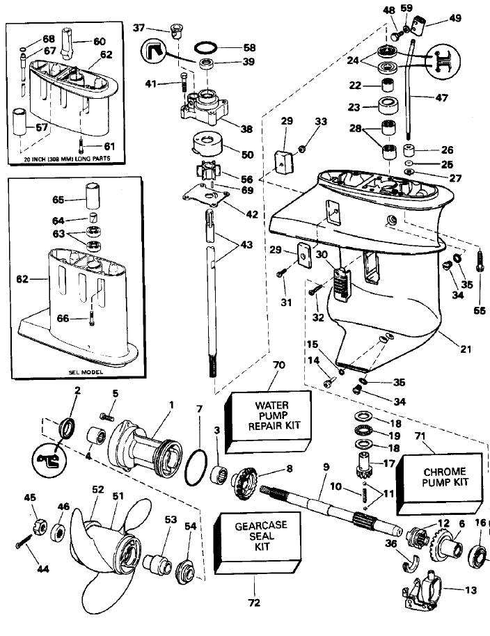

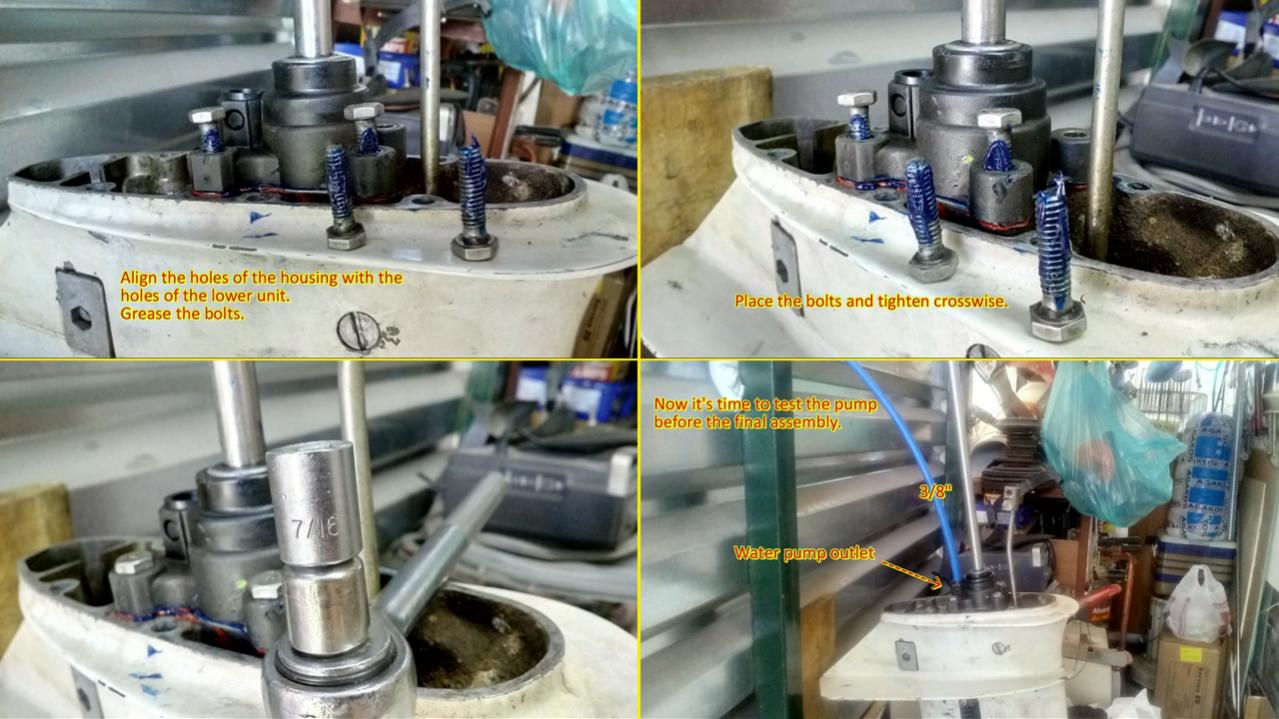

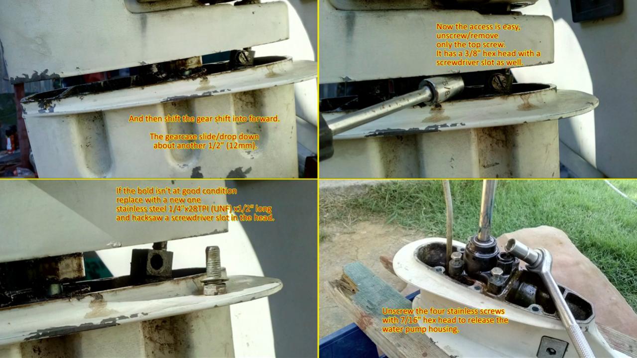

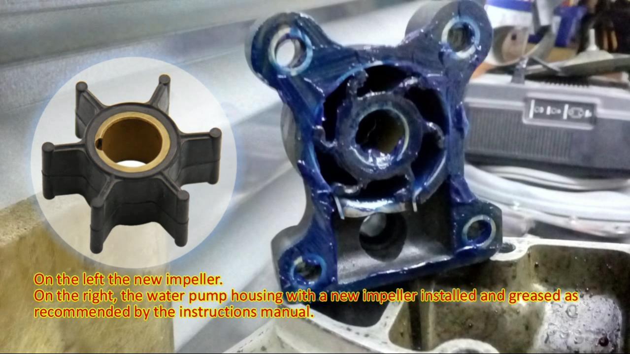

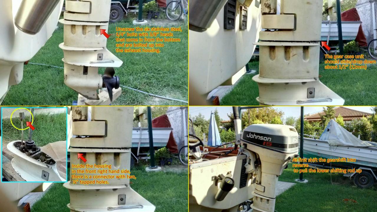

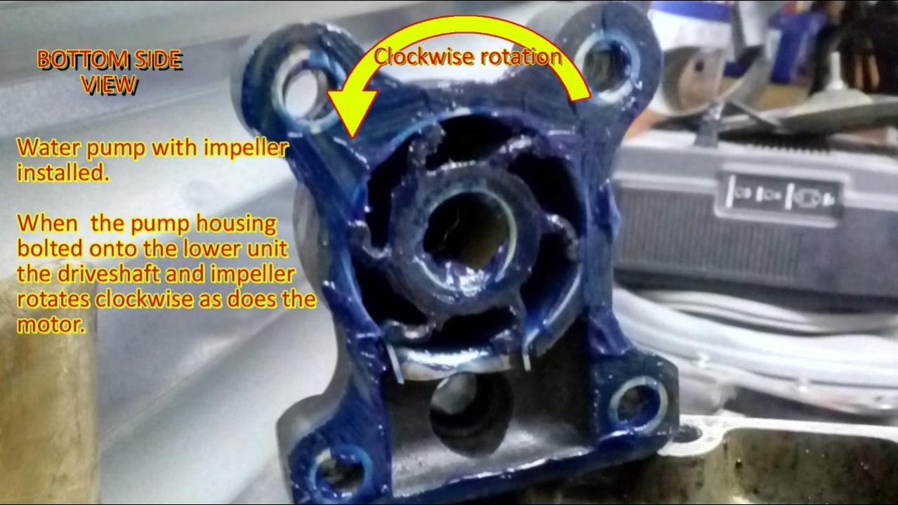

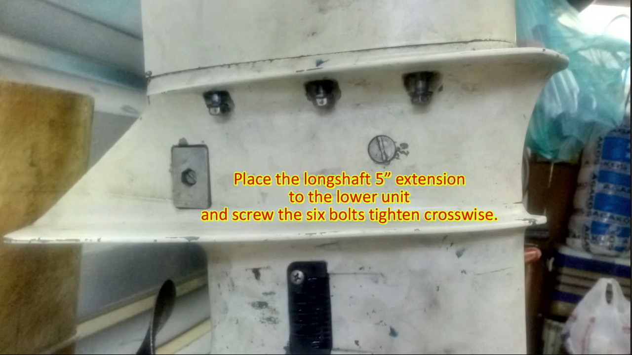

Johnson outboard 15hp water pump rebuild - Impeller replacement.
The procedure is the same for all Johnson/Evinrude 9.9 ~15 Hp 1974~2007 2-Stroke models.
https://youtu.be/mXbTa_dQ2kQ
Attachment 21085 Attachment 21086
Attachment 21087 Attachment 21088
Attachment 21089 Attachment 21090
Attachment 21092 Attachment 21091
Attachment 21093 Attachment 21094
Attachment 21095 Attachment 21096
