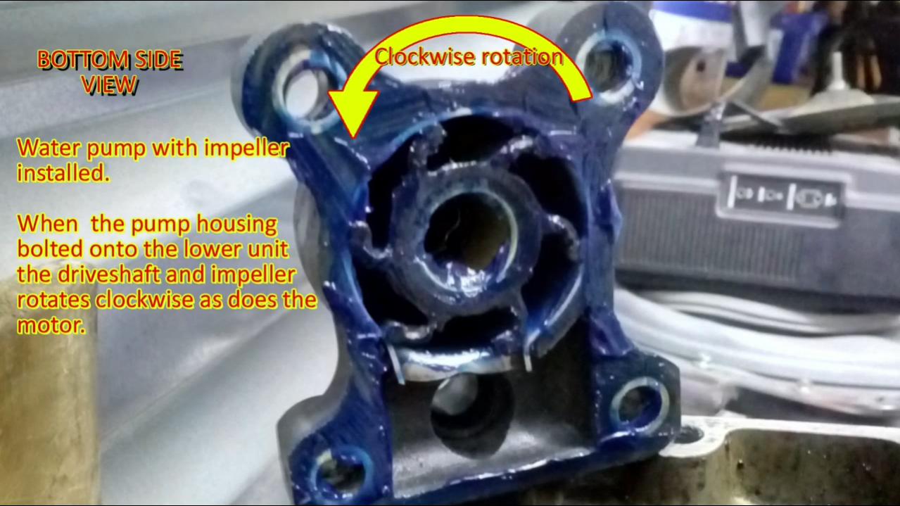

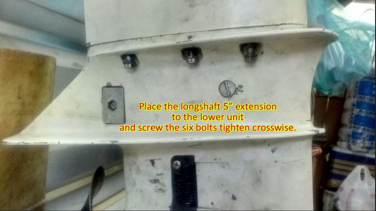

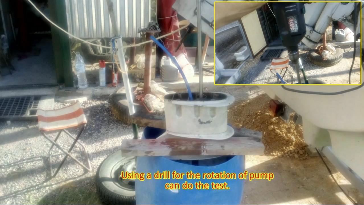

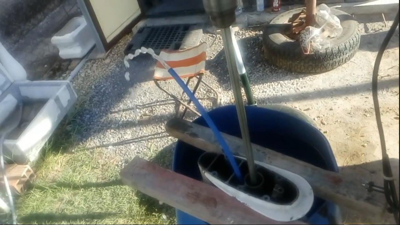

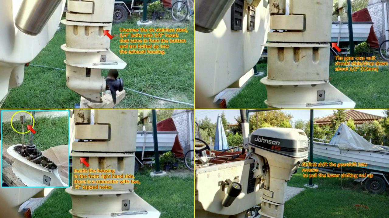

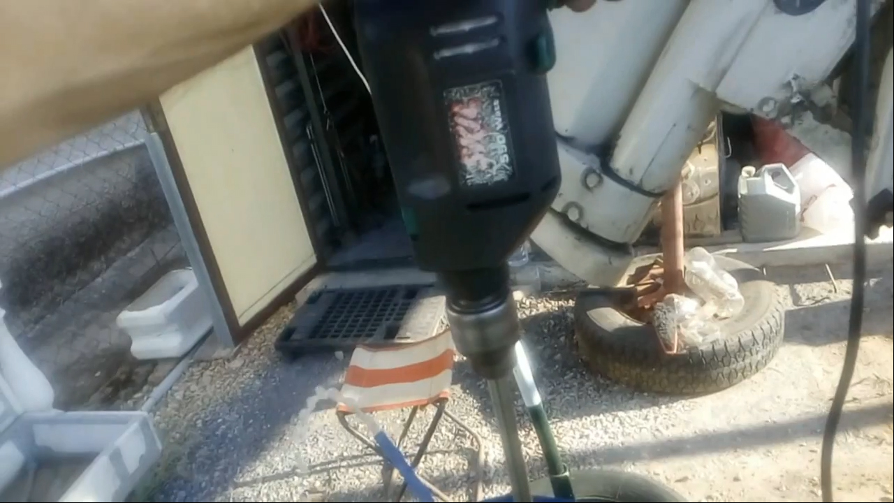

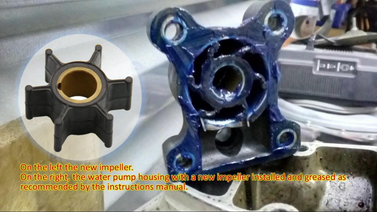

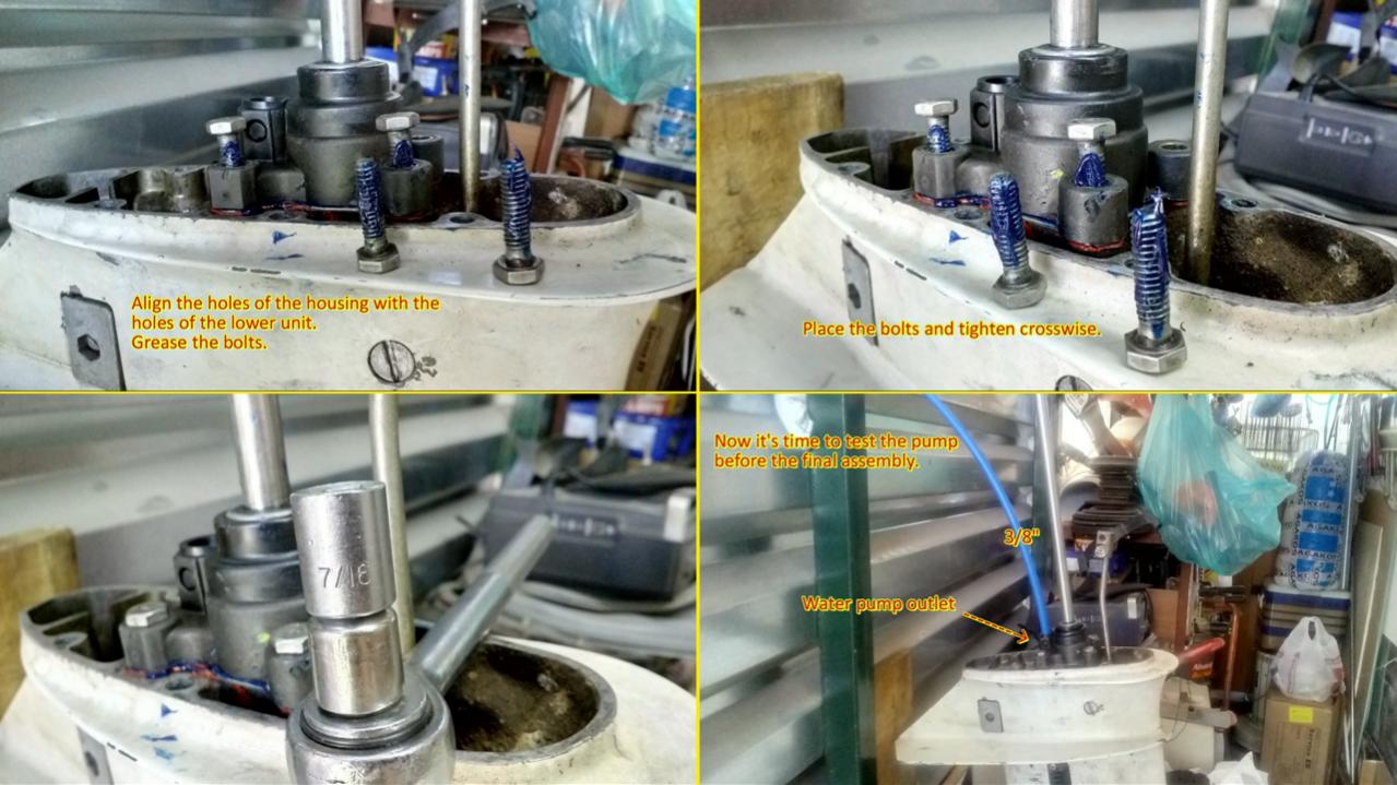

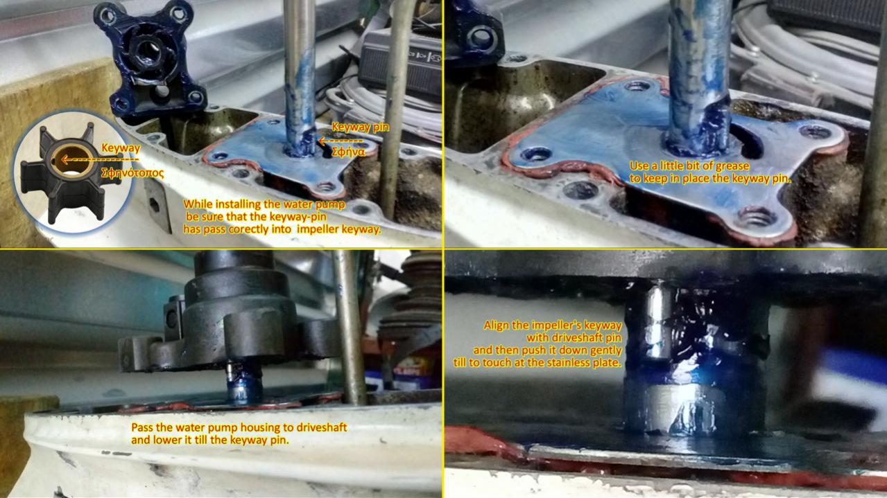

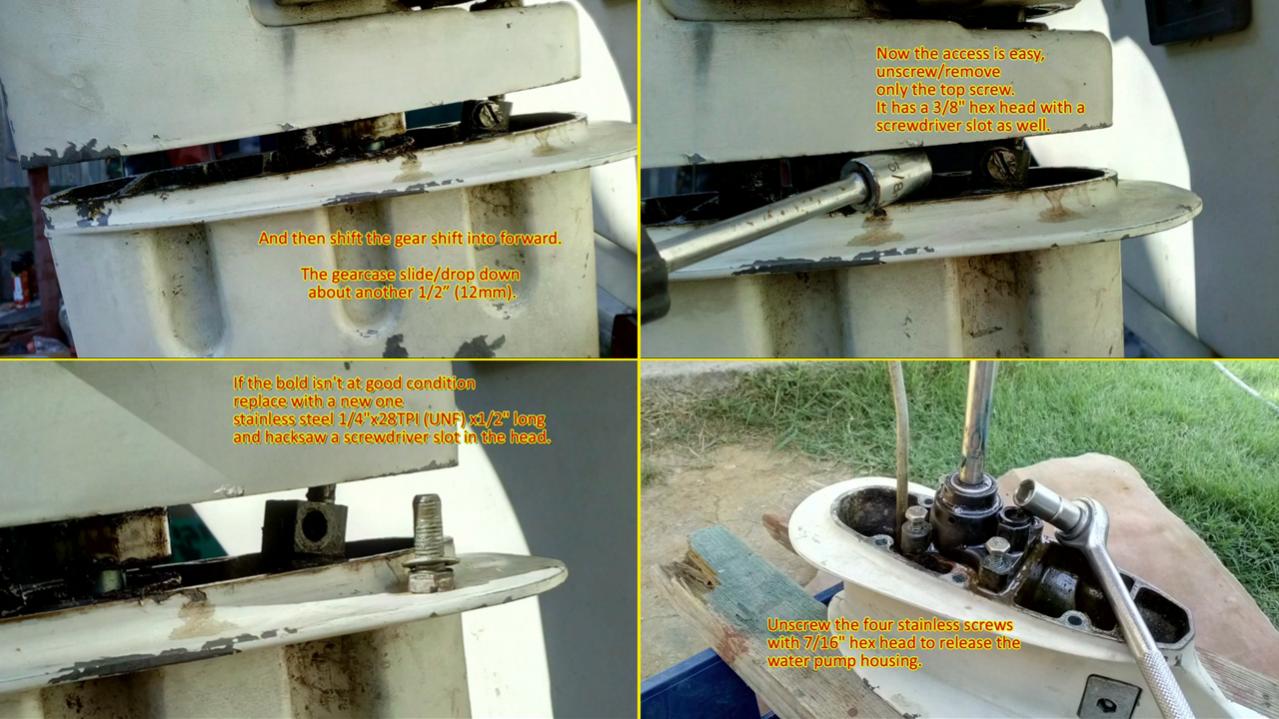

    Johnson outboard 15hp water pump rebuild - Impeller replacement.
    The procedure is the same for all Johnson/Evinrude 9.9 ~15 Hp 1974~2007 2-Stroke models.
    Johnson 15Hp 2-Stroke Water Pump Repair-0.jpg Johnson 15Hp 2-Stroke Water Pump Repair-1.jpg
    Johnson 15Hp 2-Stroke Water Pump Repair-2.jpg Johnson 15Hp 2-Stroke Water Pump Repair-3.jpg
    Johnson 15Hp 2-Stroke Water Pump Repair-4.jpg Johnson 15Hp 2-Stroke Water Pump Repair-5.jpg
    Johnson 15Hp 2-Stroke Water Pump Repair-7.jpg Johnson 15Hp 2-Stroke Water Pump Repair-6.jpg
    Johnson 15Hp 2-Stroke Water Pump Repair-8-1.jpg Johnson 15Hp 2-Stroke Water Pump Repair-9.jpg
    Johnson 15Hp 2-Stroke Water Pump Repair-10.jpg Johnson 15Hp 2-Stroke Water Pump Repair-bj15rleds-1996.jpg

    I have 2 engines like that a 9.9 and a 15HP - 1979, and didn't think to the drill test of the water pump !
    I will soon test that, when making maintenance, and also put the gearcase under pressure to verify it. My engines are quite old and I never did that test described in the OMC manuals.
