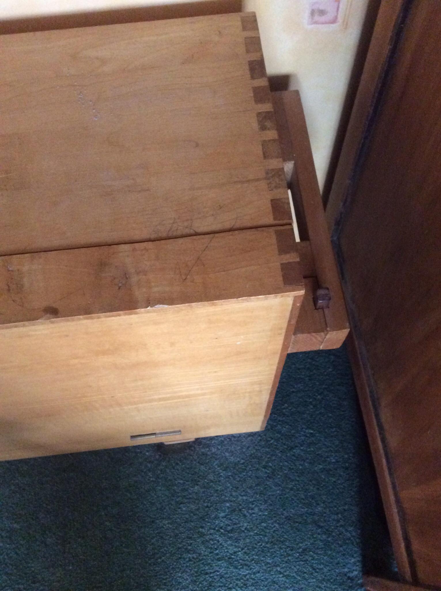

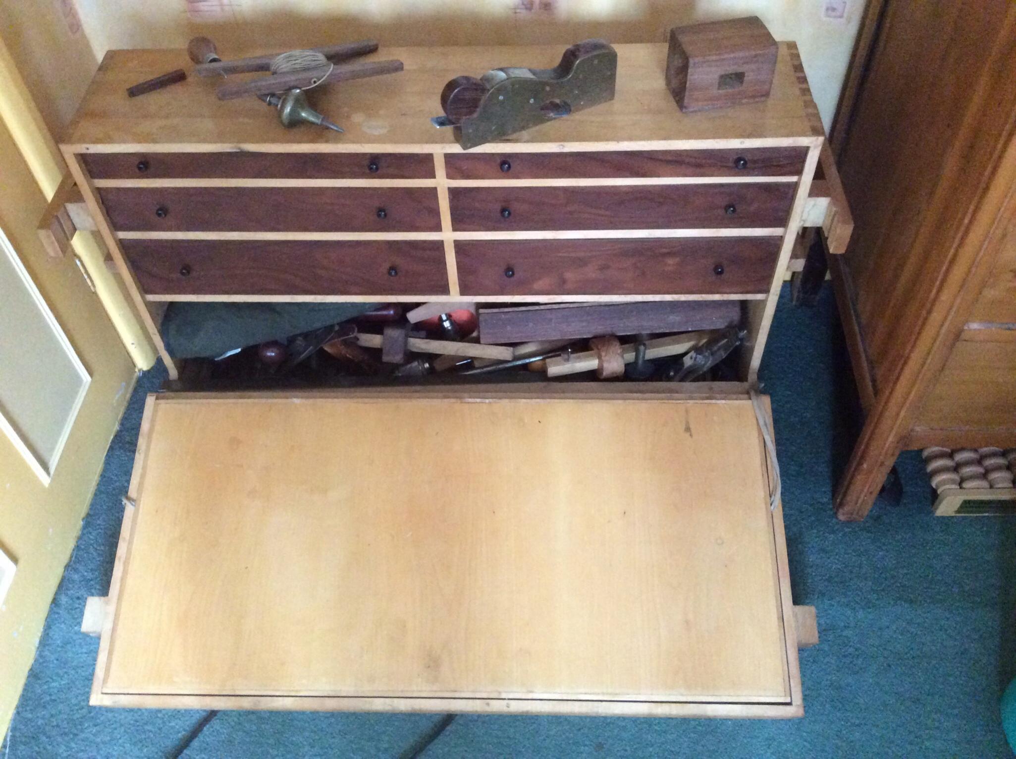

And eventually I had two toolboxes. This was the better of the twoAttachment 7749
The drawer fronts are iroko, salvaged from a bank.

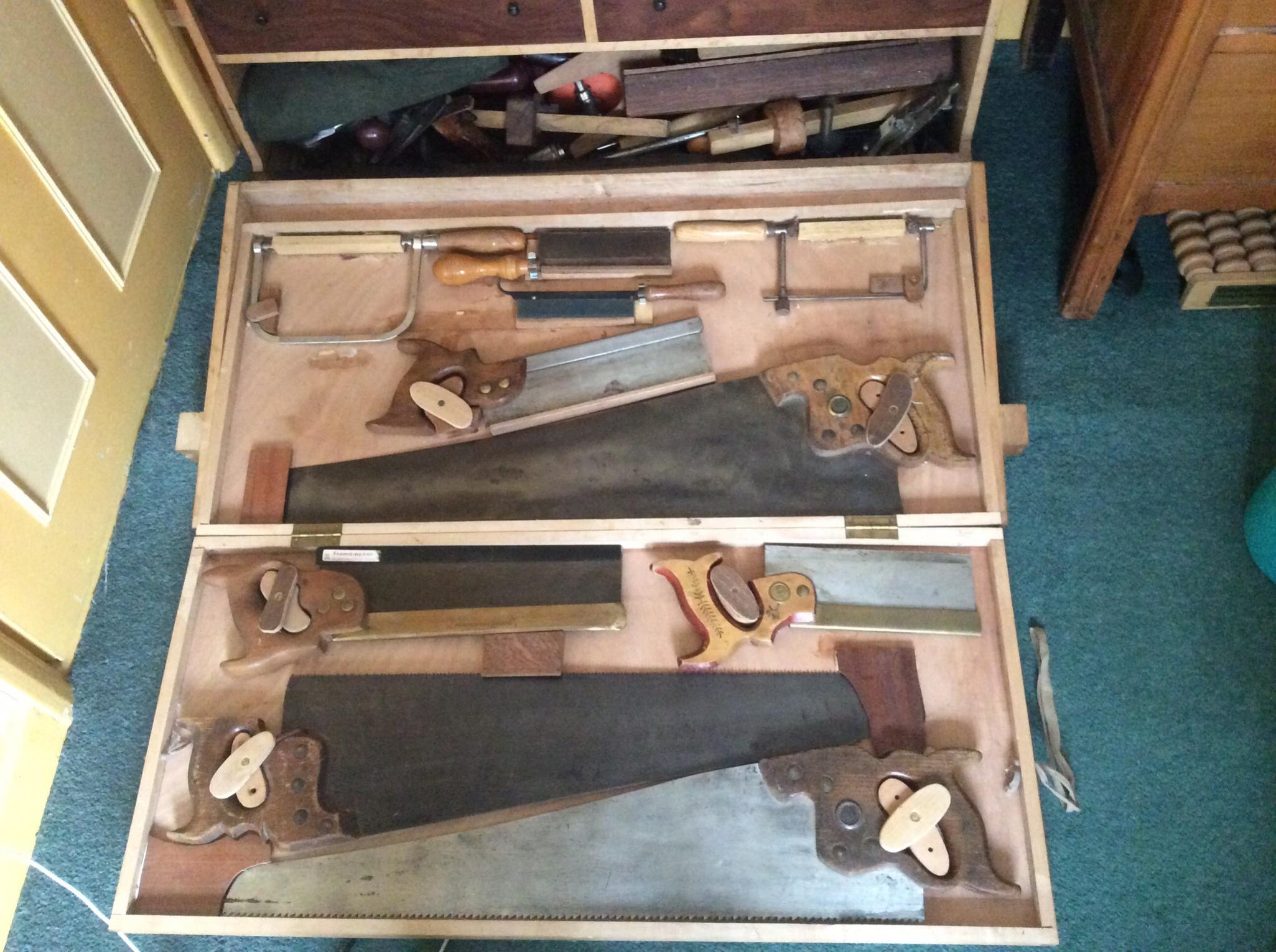

Here is the saw till which folds into the front lid.Attachment 7750
Originally, I made carrying handles which would lock into the side handles, and would also act as support bars for a temporary worktop, but I have always kept the box at home. It is chock full now. This shows the side handle and rosewood wedge to close it shut. Attachment 7751

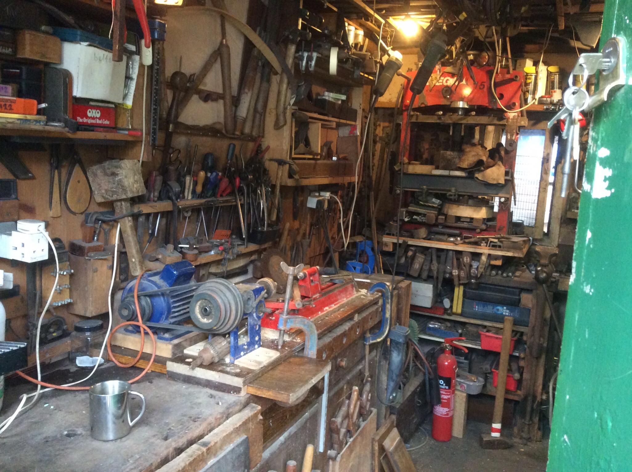

The box contains my best tools and I seldom have to come indoors to get anything now, in fact I don't do a lot of joinery any more. The other box is now a cupboard for ordinary bench planes on the wall of my workshopAttachment 7752
