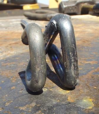

Just another paint stir'er
Yep just about everyone has made their own version of paint stirs

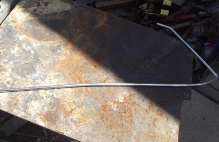

I usually just grab an old 5/32 or 3/16" welding rod and bend a couple of bends in the end of it then toss it when I'm done

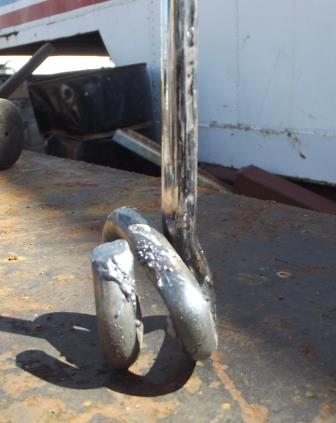

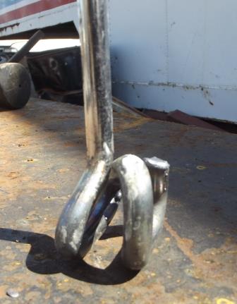

Well this one I mingt keep a while
It is made from a scrap piece of 5/16" chrome rod with a double paddle bend on the bottom

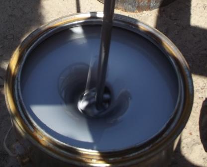

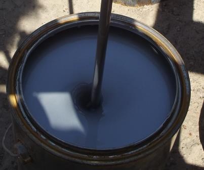

when plunged all the way to the bottom of a 1 gallon can of paint and spun in my 1/2" 675RPM drill it will create a vortex cavity nearly all the way to the bottom. then when held just under the surface instead of slinging paint all over the place it still created a downward vortex Absolutely the best paint stir attachment I have ever owned.
