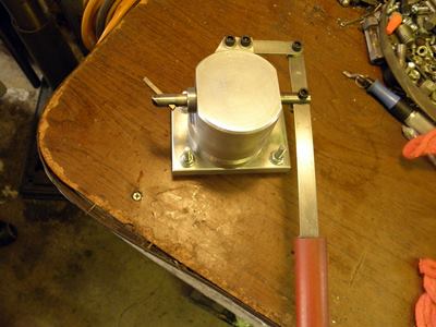

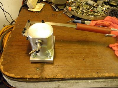

Key way cutter Lathe.
This Cutter fits on the Cross Slide to cut Key Ways on round inside diameters.

Do you have any dimensional plans for the key way cutter?
Hi Augercreek, No I made it so long ago. but check out Isimura on the builders front page number 7 on the list he has one
I think that is where I got the plans.
How is the cutter used? Pushing or pulling the tool bit through the bore? Where do I find Isimura? On this site or where?
Old age and senility are at play here! Mind can't connect with eye balls I guess! Or could it be being not computer literate?
I think that capainleeward is referring to Ishimura's Keyway Slotter tool.
His original post, containing building instructions, can be found here: SLOTTER
Ken
Yes I found it when I came to my senses!
Nicely machined keyway cutter capainleeward. This would be perfect for soft metals.
