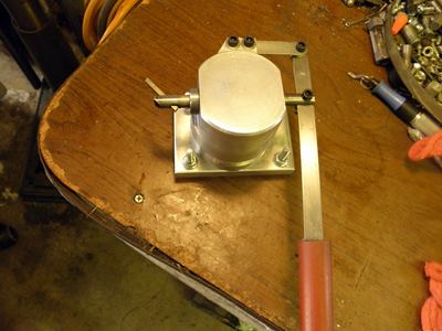

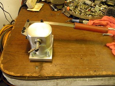

    This Cutter fits on the Cross Slide to cut Key Ways on round inside diameters.

    Do you have any dimensional plans for the key way cutter?

    Hi Augercreek, No I made it so long ago. but check out Isimura on the builders front page number 7 on the list he has one
    I think that is where I got the plans.

    How is the cutter used? Pushing or pulling the tool bit through the bore? Where do I find Isimura? On this site or where?

    I think that capainleeward is referring to Ishimura's Keyway Slotter tool.
    His original post, containing building instructions, can be found here: SLOTTER

    Nicely machined keyway cutter capainleeward. This would be perfect for soft metals.
