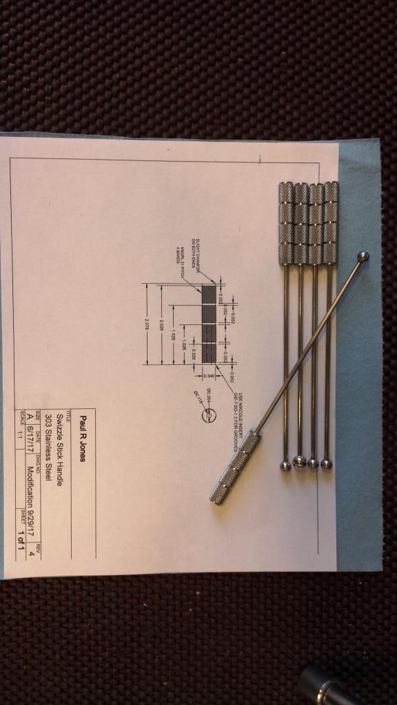

    This is another part to my "Kitchen Tool" series for stainless steel tools I made for my wife and friends.
    The following photos include all new stainless handles for drink stirring rods/swizzle sticks. I made a series of 16 handles for the stirring rods using 3/8" diameter 303 stainless steel rod. The 3/8" diameter stainless steel rods were reduced to 0.364 diameter before knurling the 21 pitch knurl (by the way I used the Android app Kurling Calculator to calculate the pre-knurling diameter).
    Dimensions to the stirring rod.
    Kitchen Tools - Stainless handles and rods for drink stirring rods/swizzle sticks.-stainleess-steel-303-handle-parts-stirring-rod.jpg

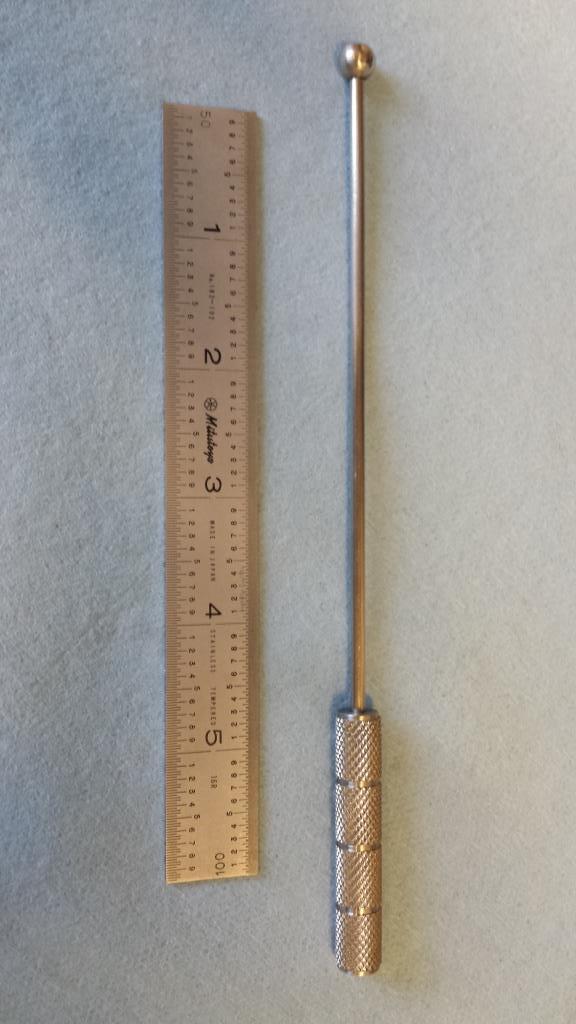

    Plans and examples of the 303 stainless steel stirring rods.
    Kitchen Tools - Stainless handles and rods for drink stirring rods/swizzle sticks.-plans-examples-stainless-steel-303-drink-stirrinig-rods-swizzle-sticks.jpg

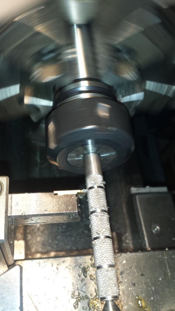

    Kurling the 21 pitch into the 0.364 diameter 303 stainless steel rods
    Kitchen Tools - Stainless handles and rods for drink stirring rods/swizzle sticks.-kurling-21-pitch-into-0.364-diameter-303-stainless-steel-rods.jpg

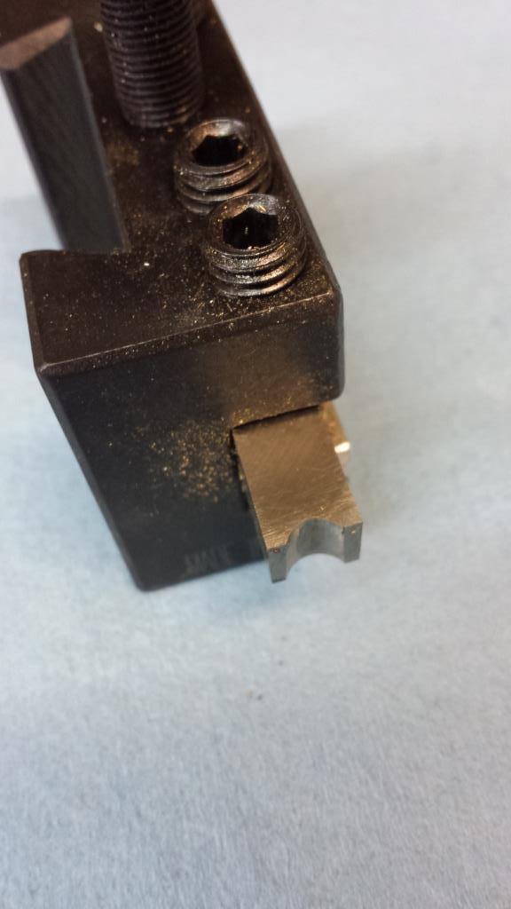

    Machining 0.052" wide grooves into the stainless steel handles. The 0.052" grooves were machined with a right-hand Nikcole Mini-systems tool holder and carbide inserts (must engage the stainless steel rod slowly or the Nikcole carbide insert will chip). Also, AR Warner makes the equivalent T15 inserts for this type of tool holder and I have used these with success and the Ti5 is not as fragile as the carbide inserts.
    Kitchen Tools - Stainless handles and rods for drink stirring rods/swizzle sticks.-cutting-grooves-nikcole-mini-systems-tool-carbide-insert.jpg

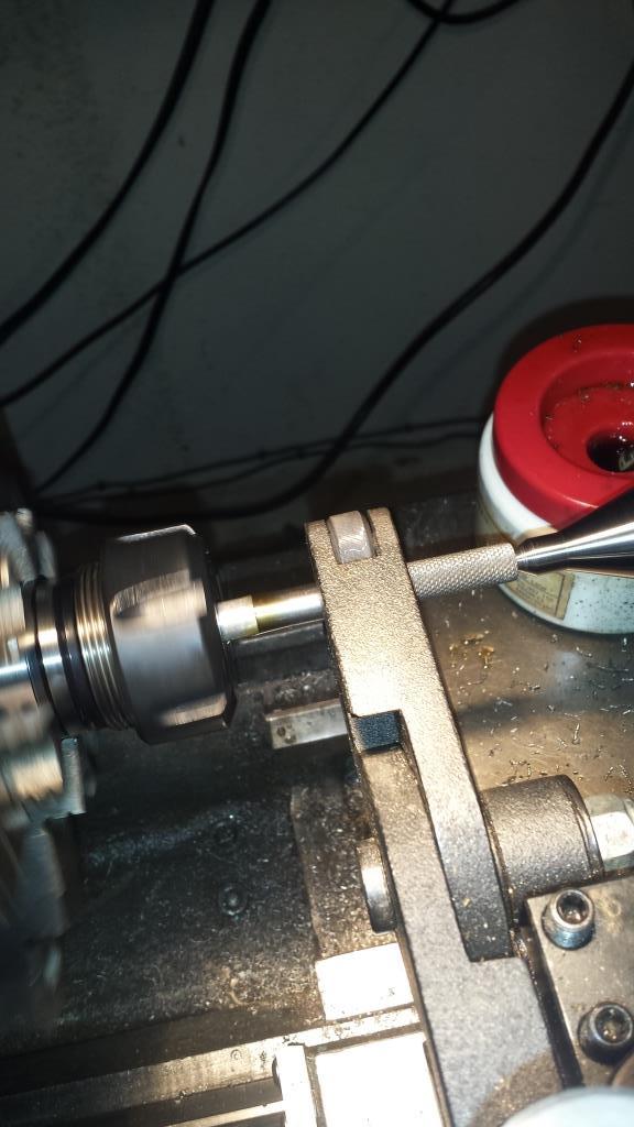

    The separate ball-ends of the stirring rods were created with a custom ground HSS form cutting tool, balls filed to finished sized, polished, drilled for a press fit and glued with Loctite 620 (high temp formula for 450 degrees F), rod reversed and ball re-mounted back in the lathe collet and finally finished on the bottom-end. There is no easy way around this.
    Kitchen Tools - Stainless handles and rods for drink stirring rods/swizzle sticks.-lathe-form-cutting-tool-making-stirring-rod-ball-ends.jpg

    Thanks for the write up and share, Paul. Beauties and timeless design...high end for sure. Loved the profile tool for the ball, but as you say a lot of ops. I might have bought a box of 100 304SS balls, Ø.188 from McMaster for $8...But it wouldn't have been as much fun as making tiny things. I notice on the drawing you had a Ø .116 hole for the rod. Was the rod off the shelf Ø .125 for the press fit? Cool and Classy!

    I wish I had discovered the McMaster-Car source of 0.250" dia. 316 stainless steel balls. These might have been easier to use and another way to do this using a miniature design of the sphere drilling fixture that Marv published at http://www.homemadetools.net/forum/s...1534#post74617 .
    The odd dimension of 0.116" is because I found a supply of 3 mm stainless steel rods that were slightly undersized by 0.05 mm. A #32 drill was the closest size for a sliding fit and then the rod glued in place with Loctite 620.
