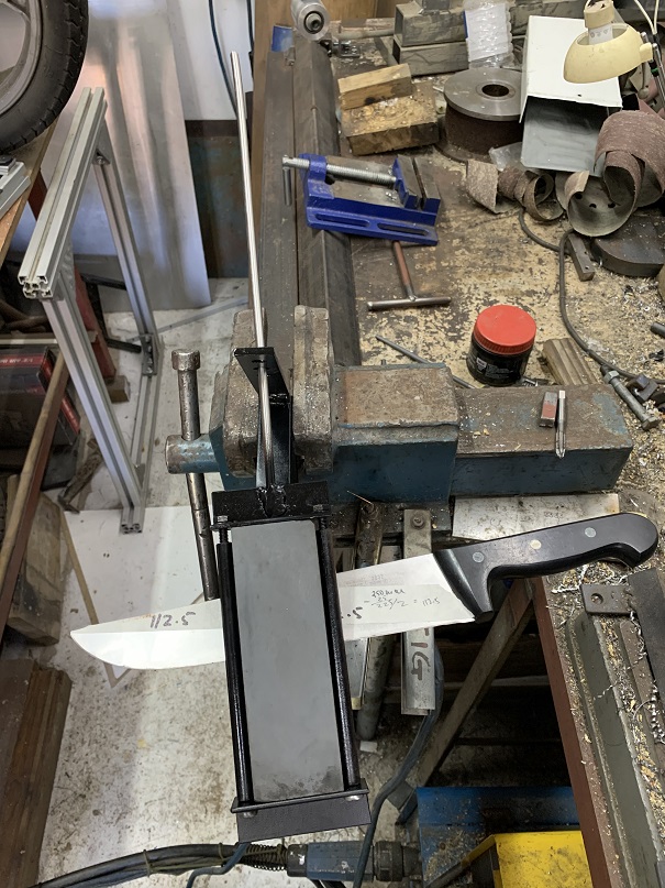

As you might have seen I wanted to sharpen my BIG meat knives for the hunting season.
Attachment 34752 For the small knives it was a huge improvement :clapping:

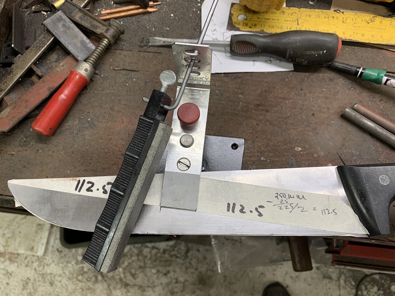

Attachment 34753 As can be seen for the LARGE knife it was not going to work.
So lets upscale it and add an improvement or 2.

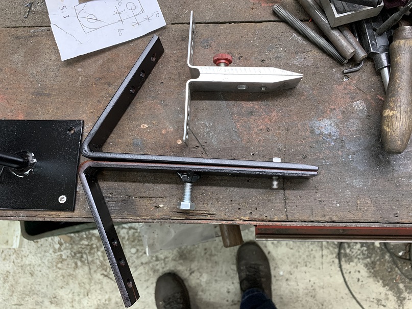

Attachment 34754 Upscaled it by 50%. Used 25 x 5 flat bar. Kept the pre set angles at 20, 25 and 30 Dag. I dropped the 17 Dag as it is not needed for any of the BIG knives.

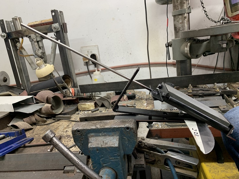

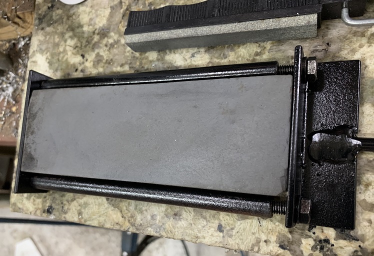

The big improvement was the use of a full size sharpening stone(100 x 50 x 25). I clamped it between 2 pieces of 25 x 25 x 3 angle iron and some 10mm round bar drilled and tapped on both sides. A piece of 6mm SS rod was welded to the one side to be perfectly in line with the flat of the angle iron. This is very important as when you set your stone in the clamp that plane has to be in line with this rod. One at the top is the one that comes with the kit.
Attachment 34755

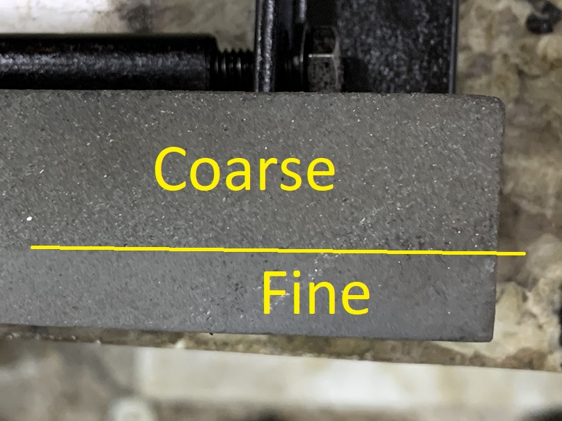

The stone has a coarse and a fine side, so you have to unbolt the stone clamp and turn the stone once you are done with the coarse side.
Attachment 34756
and now with the whole lot assembled. Much more balanced.
Attachment 34757

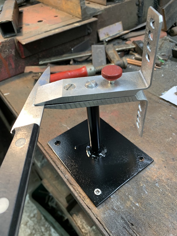

One of the improvement "I think" is to weld the pieces with the holes for the angles at an angle to be perpendicular to the 25 Deg plane. This will be the plane I use most of the time for his type of knife.
Attachment 34758
I can also still use the stones that came with the kit. There is a 1000 grit finishing stone which is excellent for that final polish.
So a nice sharpening system that used a stone you will find in most any garage/workshop.
After using it on a few knives I am thinking of adding a handle to the far side of the stone clamp with a guard for your hand, should the stone hook on something for some reason.
