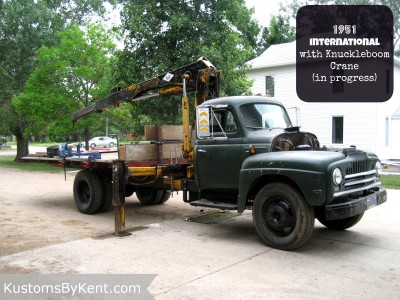

Here's a knuckle boom crane that I grafted onto a 1951 Int'l truck. I slid the flat bed back to make room, strengthened the frame, and revised the hydraulics to have enough volume to operate the crane.
It came in real handy when I lifted my "new to me" lathe off of the shipper's trailer.
