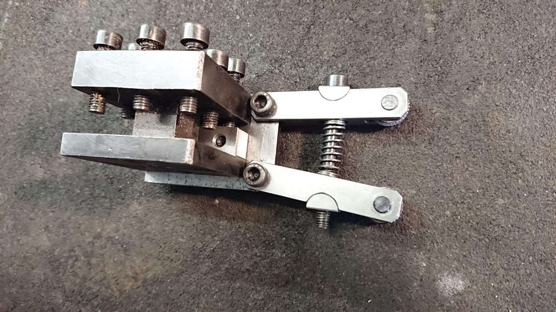

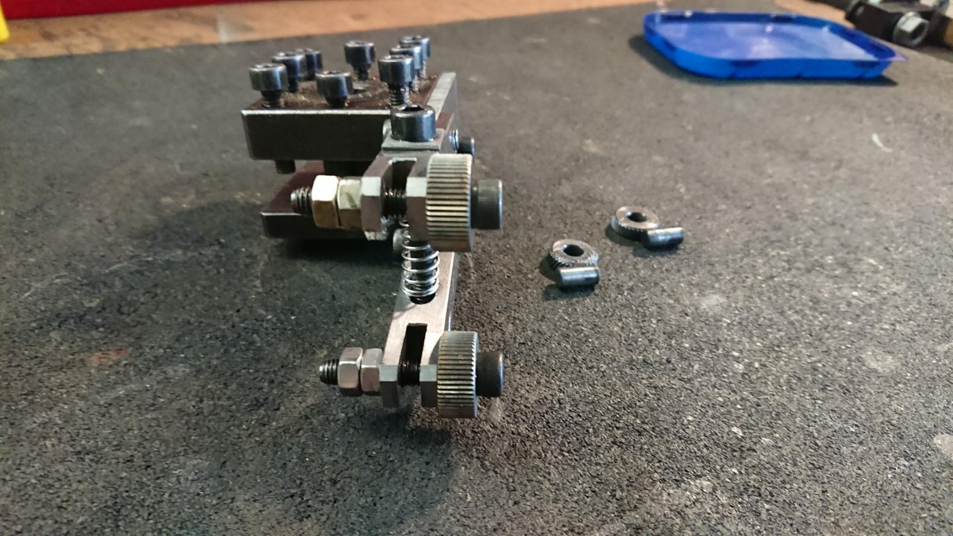

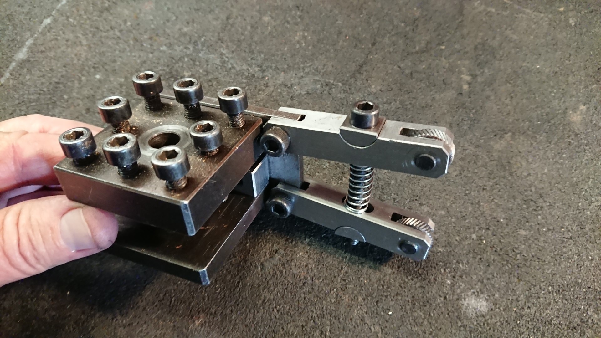

I bought a three in one push type knurling tool and soon discovered it was meant for larger lathes so made this using the wheels and pins.
Attachment 24779
Attachment 24780
Attachment 24781

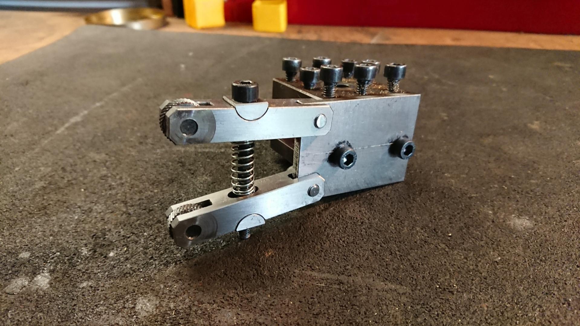

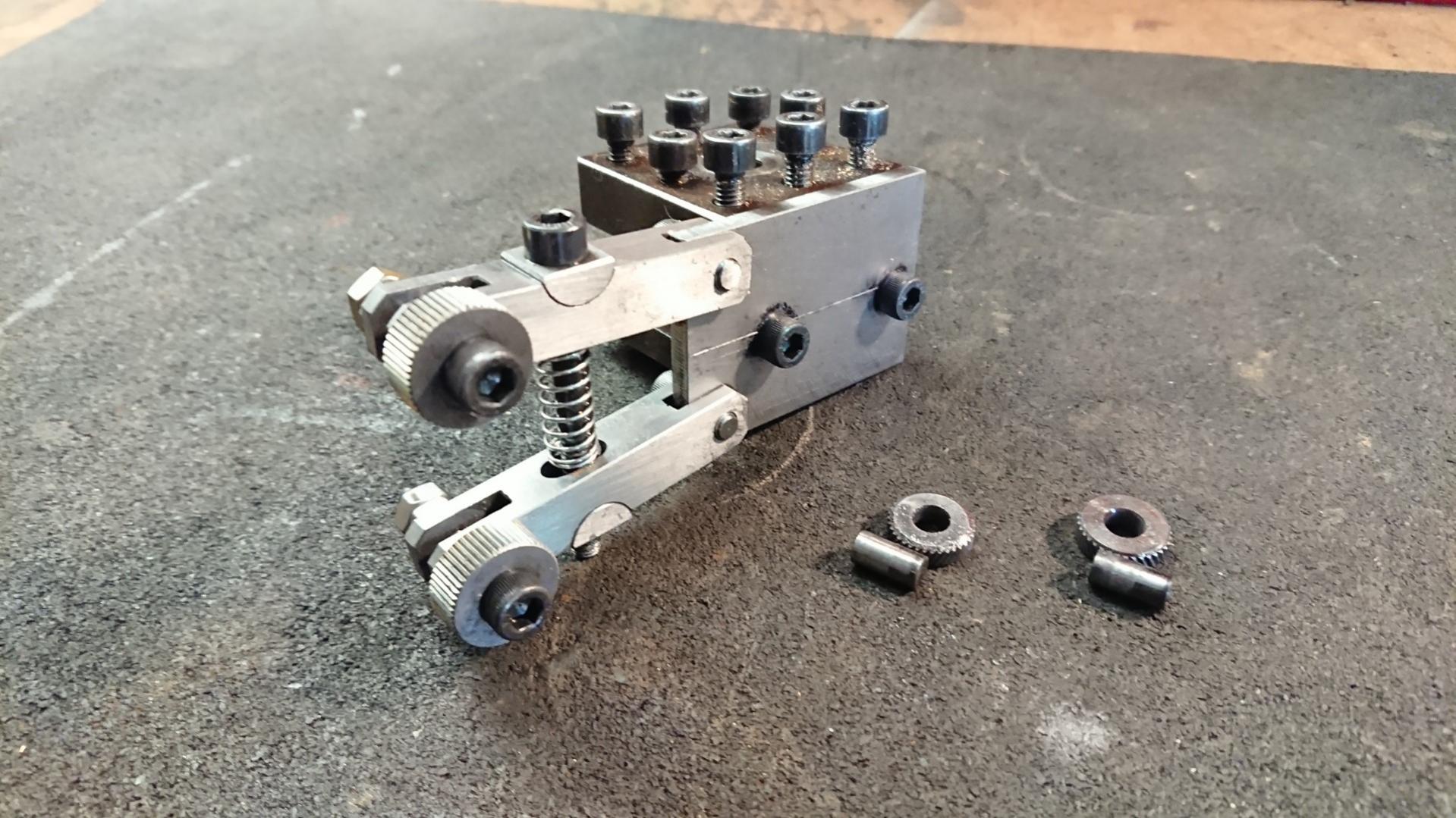

When I accidently bought some straight knurls the wrong size figured out how to mount them without making another tool.
Attachment 24782
Attachment 24783
I've discovered that if you start a knurl and the pattern isn't even then by holding the bottom wheel with your finger, loosen clamp and just turn the top wheel a smidge fixes the alignment. Is this a common technique?
