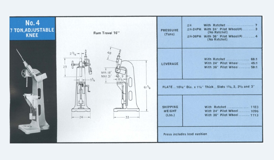

    7 ton arbor press? Mechanical?? Dang! The rest I understand.
  13. #10
    5,355
    7,074
    Quote Originally Posted by mwmkravchenko View Post

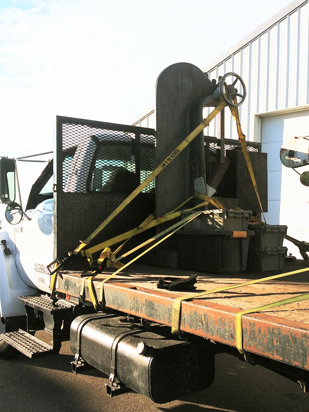

    Like so, brought from Illinois, by way of PA.
    Lacking creative title, (yet preserve continuity) "Wait, one more second......"-greenerd_no_4.jpg
    Worst object to ratchet down, ever.
    Lacking creative title, (yet preserve continuity) "Wait, one more second......"-greenerd_fob.jpg
