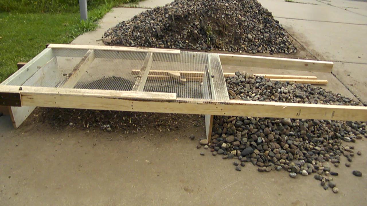

    Step 1: Set up the frame on some blocks

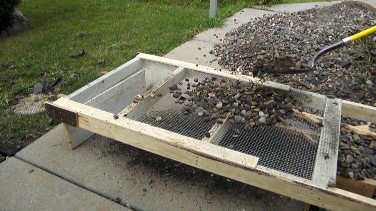

    Step 2: Shovel some rock dirt mix on the screen

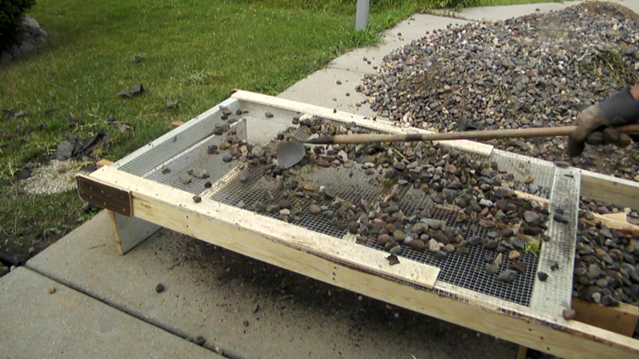

    Step 3: Use a garden hoe to agitate the rocks and pick out sticks and garbage.

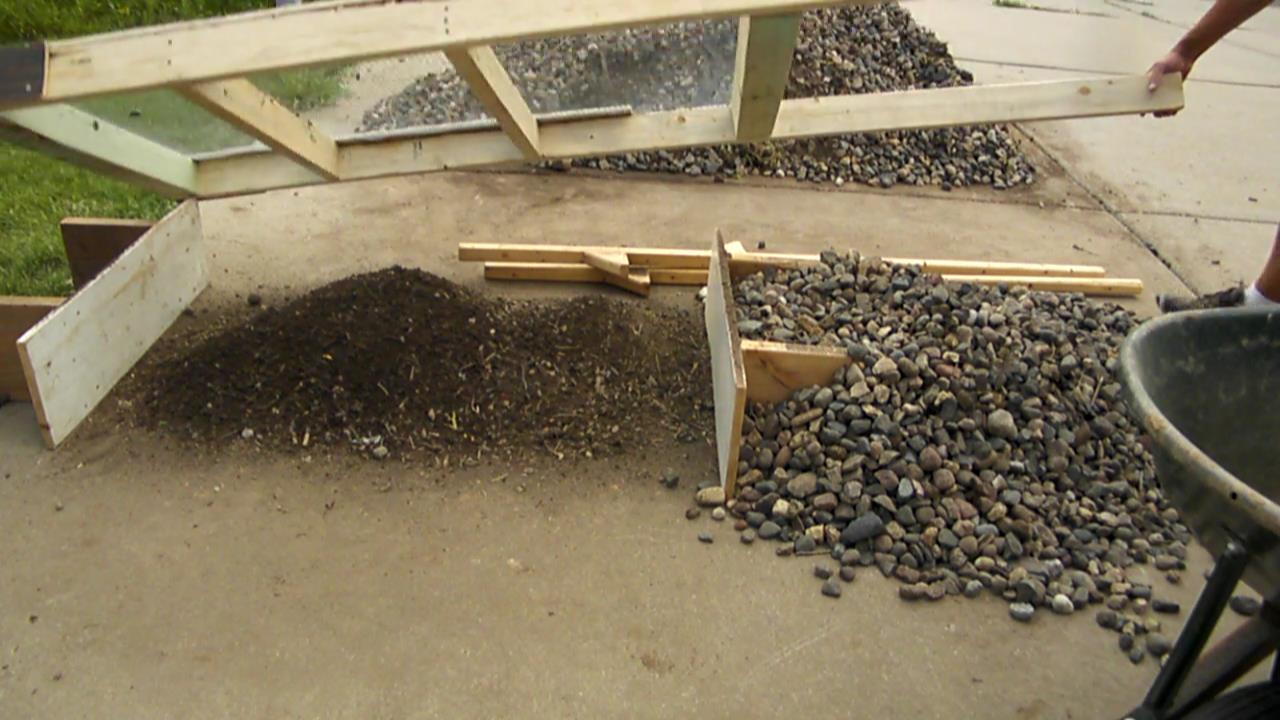

    Step 4: Pull the rocks off one side and you are left with one pile of dirt and one pile of rocks.
