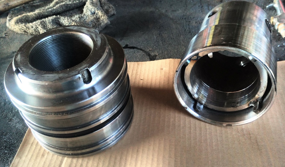

First I machined a cylinder and cut 4 flat pins then welded them to it
Attachment 45639
Attachment 45640

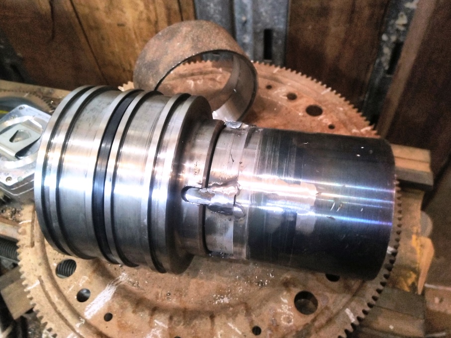

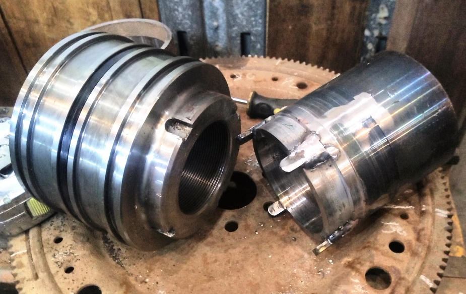

Then I made a sleeve to fit over the pins and the protrusion of the piston
Attachment 45641

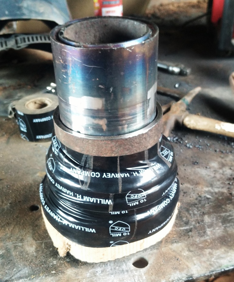

Then wrapped the piston to protect it from weld splatter

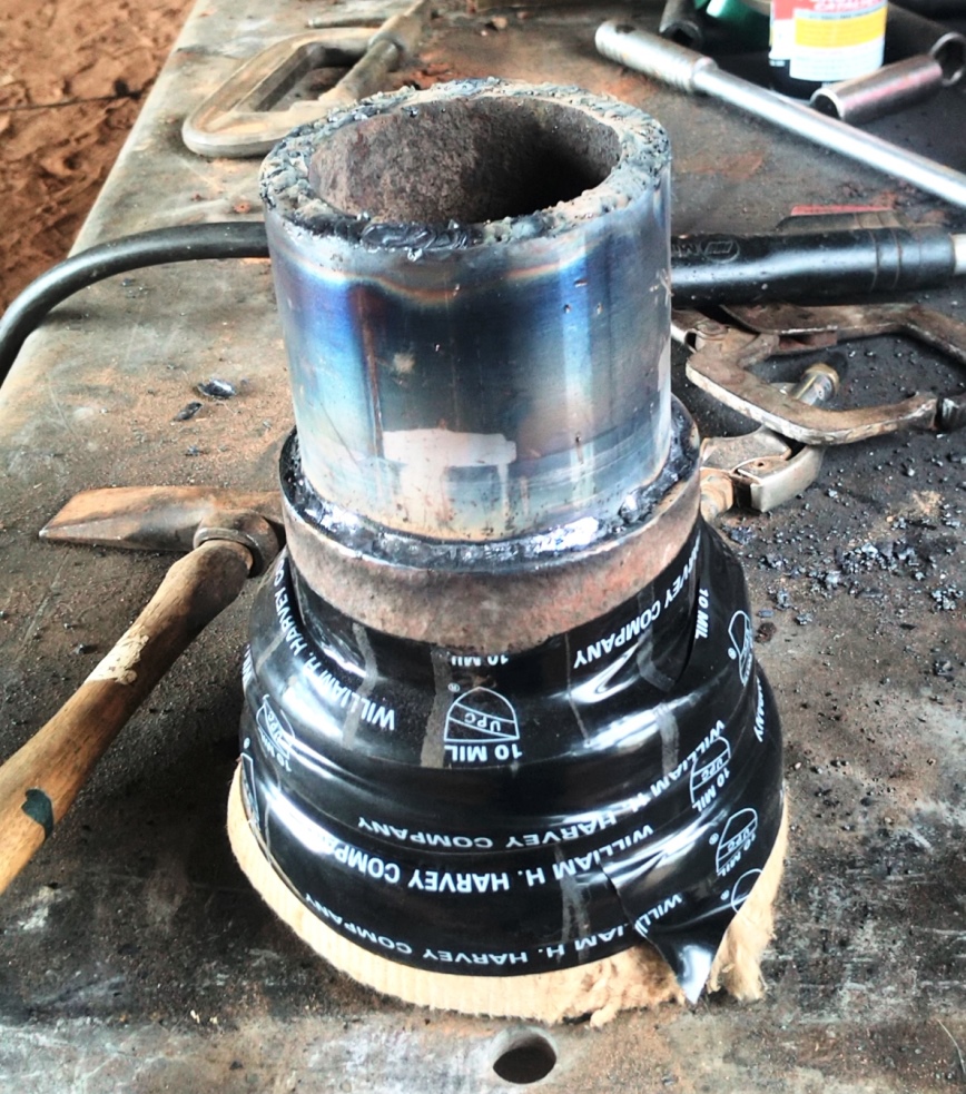

Attachment 45642
Attachment 45643

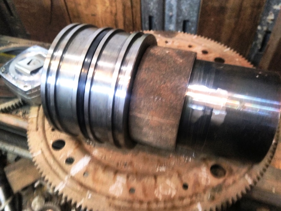

A little clean up and this is what it became
Attachment 45644
I didn't notice while making it but the socket will only go on the piston in 1 position as 1 of the pin groves is not equally spaced around the piston with the others so the tool will probably only fit that piston if he ever has to repack the other cylinder we can only hope that one will be spaced the same way otherwise I will have to make another one for him the socket fits the piston tight enough that when you push it on you can pick up the piston by the socket
