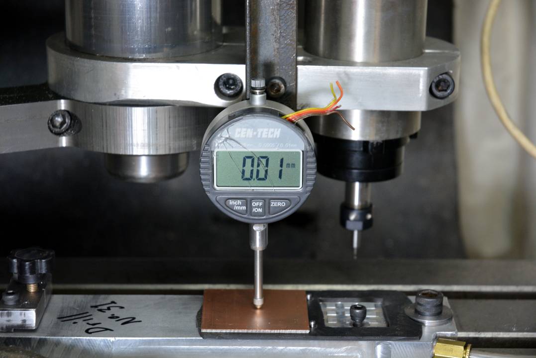

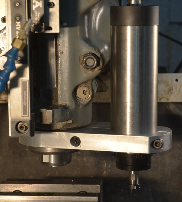

    Not a router but a high speed spindle, runs at 24,000 rpm. In fact I am right now preparing a new post about this subject.
    Here are a couple of pix.
    Laser Printer Toner Transfer With Kitchen Parchment Paper and a Laminator-makingclamp-01.jpg Laser Printer Toner Transfer With Kitchen Parchment Paper and a Laminator-spindle-mill.jpg Laser Printer Toner Transfer With Kitchen Parchment Paper and a Laminator-testingflatness.jpg
    In the past I have made PCBs by etching, by drilling holes from a simple drill jig and using the holes as references to draw tracks by hand with a "resist" pen, before etching.
    That is messy and now that I have a CNC mill I prefer making tracks with isolation milling. This will be clear in the upcoming post.
    Is it air or water cooled?
    Rick
    Rick

    Quote Originally Posted by rgsparber View Post
    Rick
    Air cooled 2.2 kw. I only wanted one for things like PCBs, small engraving, internal grinding on a lathe and getting a decent speed on small milling cutters for aluminium so aircooled was quite adequate, without the extra complication. I monitor the current and it has never exceeded 25% of rated and only ever gets lute warm.
    I am planning on using it for a high speed sensitive drill.

    I mostly run around 22,000 rpm because it is noticeably quieter. In general it is reasonably quiet though, quieter than I expected. Depending on use I do sometimes run it as low as 12,000 rpm.
    Being air-cooled by internal fan it is not advised to run below 1/3 of max due to reduced cooling but that needs to be balanced against the load on it. I programme my VFD to a minimum of 133 Hz, so my range of frequencies is 133 to 400 Hz so I can't run it too slow in a thoughtless moment.
