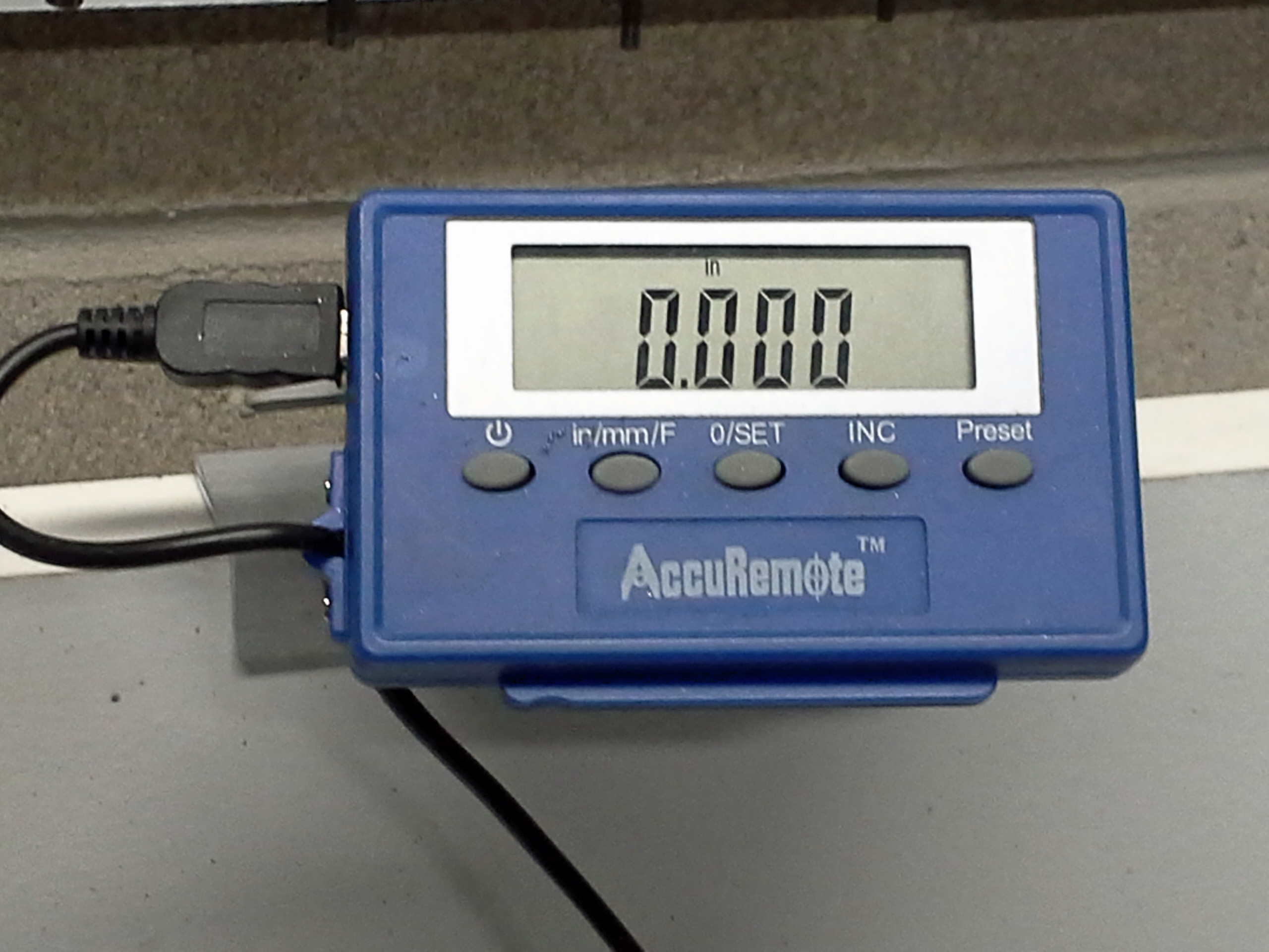

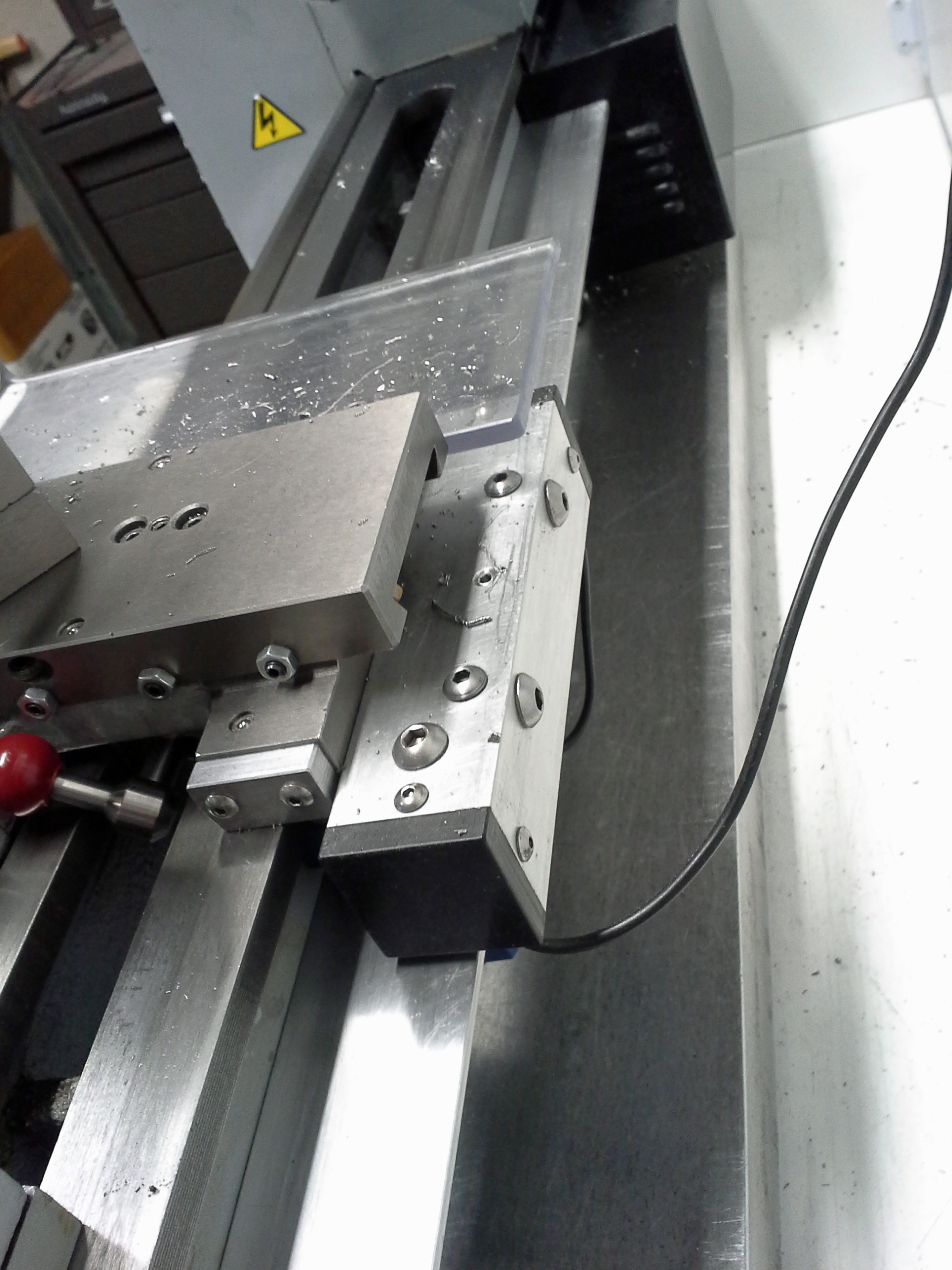

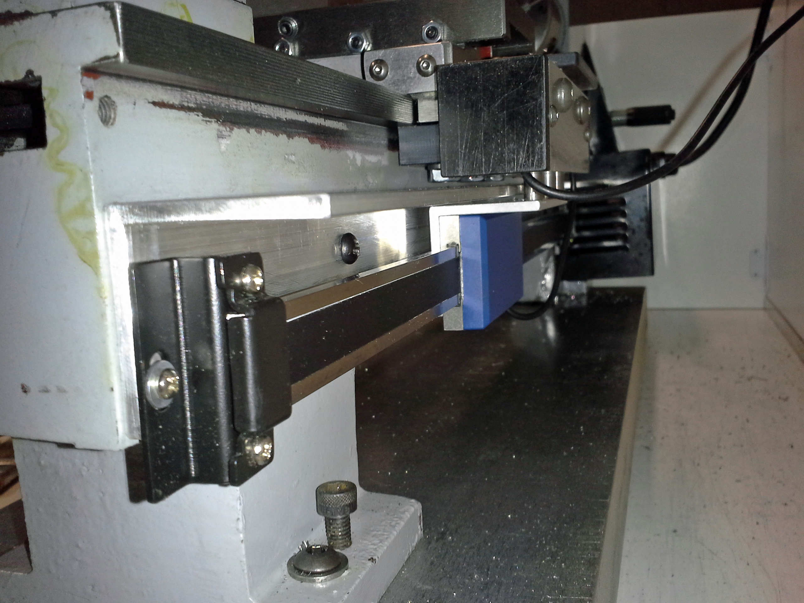

Do a search on EBay for "Shars Digital Readout". It is just a low priced Shars DRO, but I have had it for over 6 years with no major troubles. The only issue was with fine cast iron dust on the scale and cleaning solved the problem. The one I bought was 24" long and has a scale that can be cut to length. It is fairly easy to install onto the backside of the bed. I installed mine under a piece of aluminum angle to protect it from swarf.

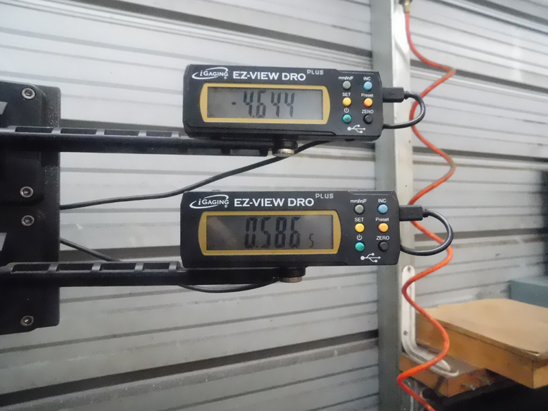

Here's the DRO setup on my milling machine that I got from igaging, you can buy these individually and the scales can be cut to whatever length, the maximum length scale is 36", you can get these different lengths ready to go but they are still trimmable, 12"-18"-24"-36"
Doug

olderdan,
I agree the price is right for sure and it has stood up to the shop environment for a long time.
