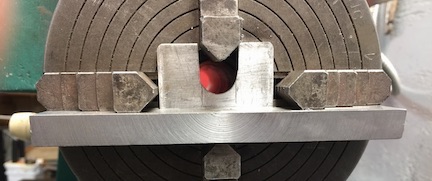

I made an adapter to cover that hole and provide a flat
platform for parts to bear against when chucking them.
The adapter is held in position with jaw #3 pressing a bar
LIGHTLY against jaws #2 & 4. This allows 2 & 4 to move
freely and 1 to press against 3. Jaw #3 is never adjusted
when clamping as that would tend to bend the bar.
Attachment 49085

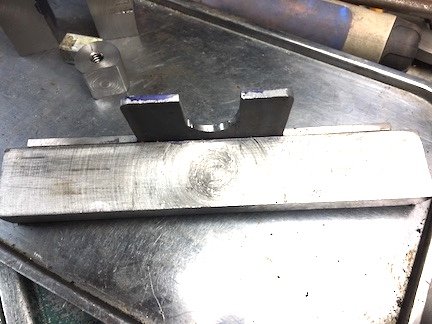

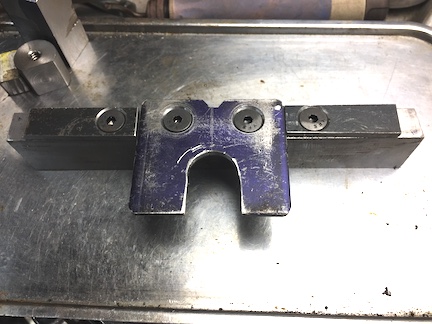

The adapter is just a flat piece of bar stock with a thin gauge
plate screwed to the edge. The plate blocks the center hole.
A slot in the plate allows jaw #1 to slide into plate.
Attachment 49084
Small plates were added to the ends of the bar to provide
a wider bearing surface to assure the adapter is parallel to
the chuck face. A small notch under the bar positions the
adapter over jaw #3. After attaching the plates, make a skim
cut on the front side of the bar so it is parallel with the chuck face.
Attachment 49083

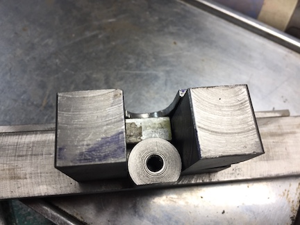

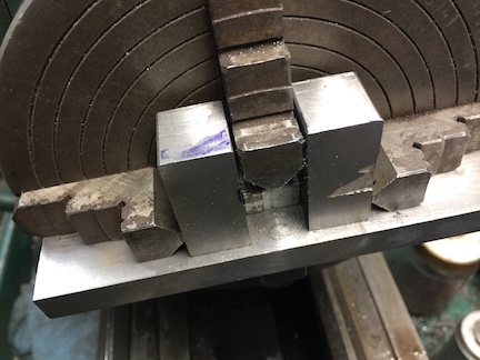

This adapter allows set-ups to be planned on the bench,
finding appropriate blocks to securely hold the part. I have
collected a box of assorted blocks of various sizes over the
years. Then move those pieces to the chuck.

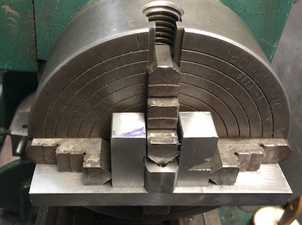

Attachment 49082

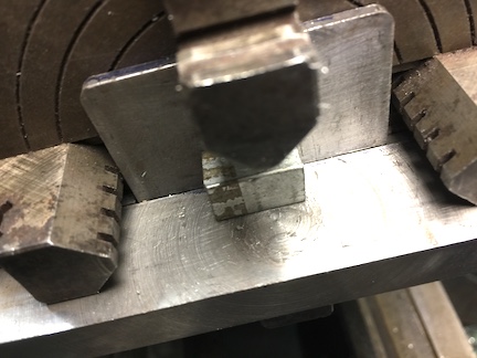

Bar and back spacer in position.
Attachment 49081
Side blocks in position.
Attachment 49080
Part turned and ready to swap out with the next one.
Attachment 49079

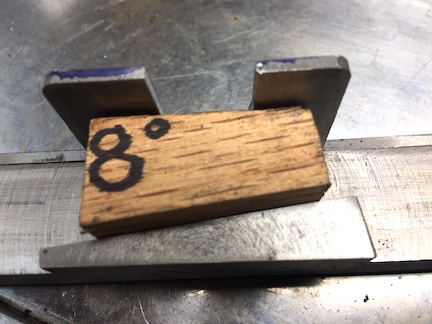

Recently I need to make some steel wedges. One simple
way to accurately hold a small part at the desired angle
is to cut a block with the miter saw to hold the first part.
Attachment 49078
If additional parts are needed with same taper, the first
part can replace the wood block.
