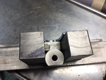

    It works fine for some small parts. I needed to cut a flat on
    the side of several small, internally threaded, cylinder shaped parts.
    The center hole in the chuck has always been an issue trying
    to accurately position small parts like this.

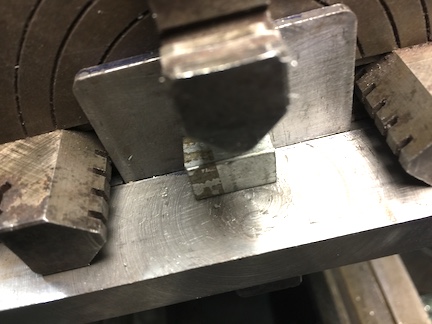

    I made an adapter to cover that hole and provide a flat
    platform for parts to bear against when chucking them.
    The adapter is held in position with jaw #3 pressing a bar
    LIGHTLY against jaws #2 & 4. This allows 2 & 4 to move
    freely and 1 to press against 3. Jaw #3 is never adjusted
    when clamping as that would tend to bend the bar.

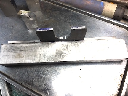

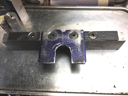

    The adapter is just a flat piece of bar stock with a thin gauge
    plate screwed to the edge. The plate blocks the center hole.
    A slot in the plate allows jaw #1 to slide into plate.
    Small plates were added to the ends of the bar to provide
    a wider bearing surface to assure the adapter is parallel to
    the chuck face. A small notch under the bar positions the
    adapter over jaw #3. After attaching the plates, make a skim
    cut on the front side of the bar so it is parallel with the chuck face.

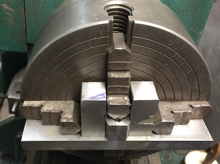

    This adapter allows set-ups to be planned on the bench,
    finding appropriate blocks to securely hold the part. I have
    collected a box of assorted blocks of various sizes over the
    years. Then move those pieces to the chuck.

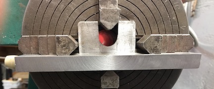

    Bar and back spacer in position.

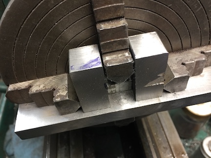

    Side blocks in position.

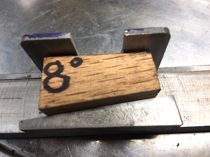

    Recently I need to make some steel wedges. One simple
    way to accurately hold a small part at the desired angle
    is to cut a block with the miter saw to hold the first part.
    If additional parts are needed with same taper, the first
    part can replace the wood block.
