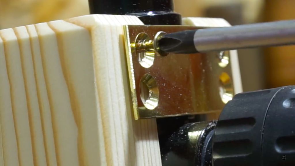

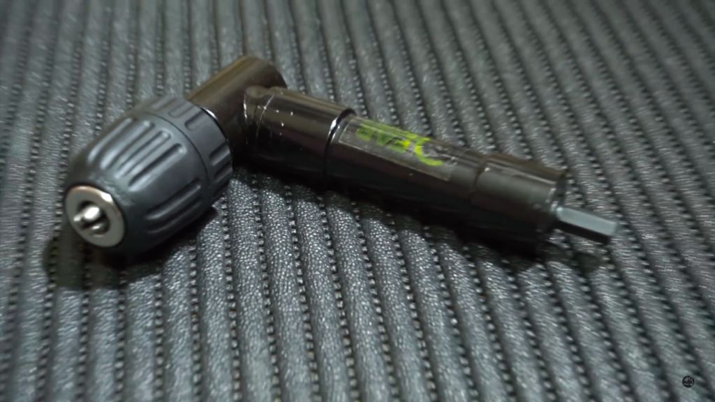

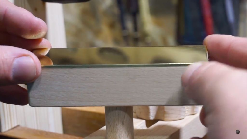

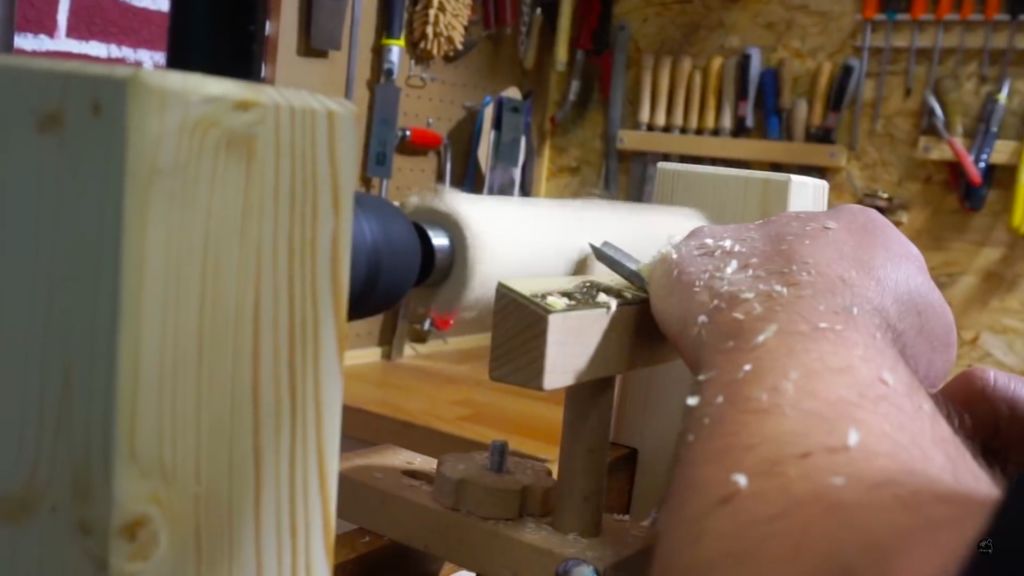

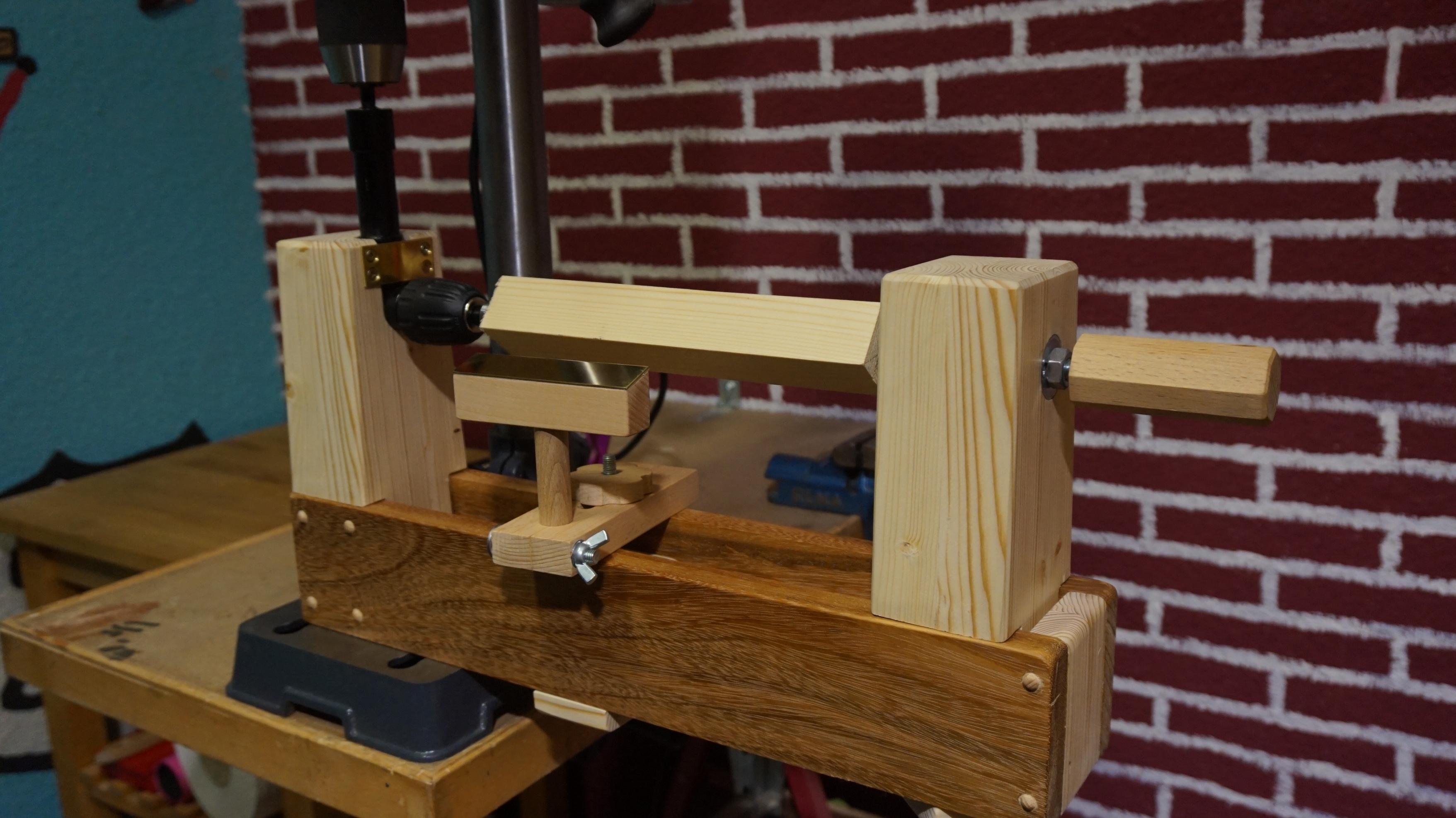

I always wanted to have a lathe for wood but I don't have much space in my workshop, so I decided to build one myself using my drill press. For this, I used an angle drill adapter and after many tests I saw that the result could be good.
The benefit of the angle drill adapter would be the absence of lateral stress on the drill press bearings.
