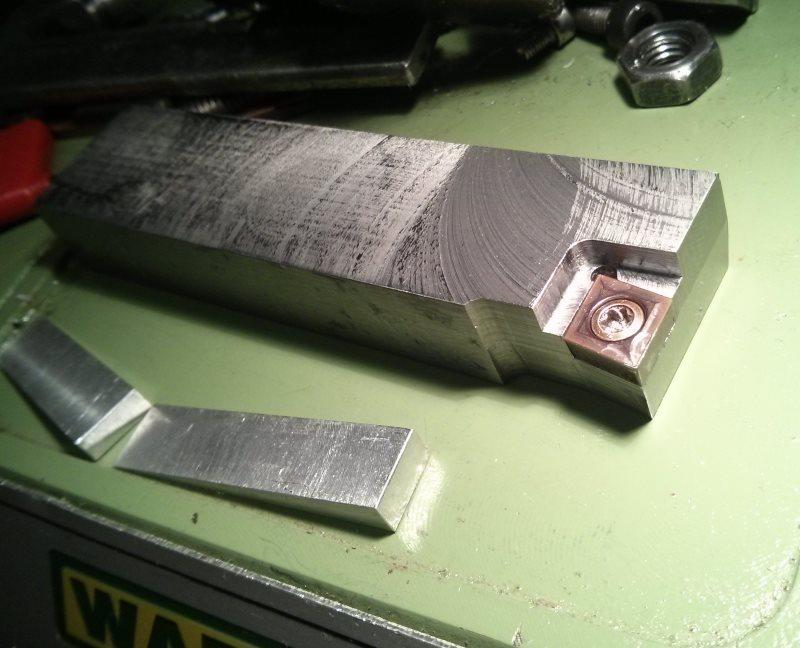

This was one of the first things I tried to mill on lathe, so I spent a lot of extra time setting up to mill angles that I could have done on the bench grinder in seconds.
http://i1133.photobucket.com/albums/...1.jpg~original

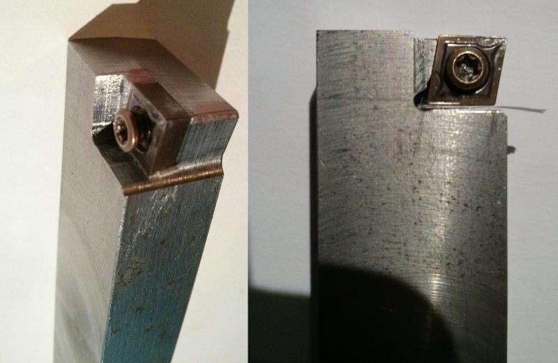

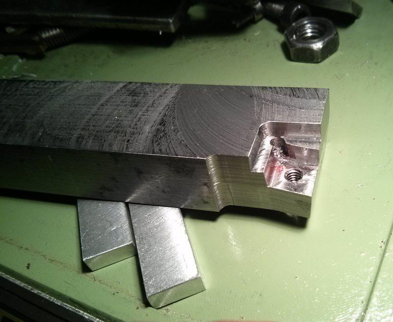

I need to cut a couple of 6 degree angles and replace the paper shim where I recessed the 6 degree too far.
http://i1133.photobucket.com/albums/...k.jpg~original

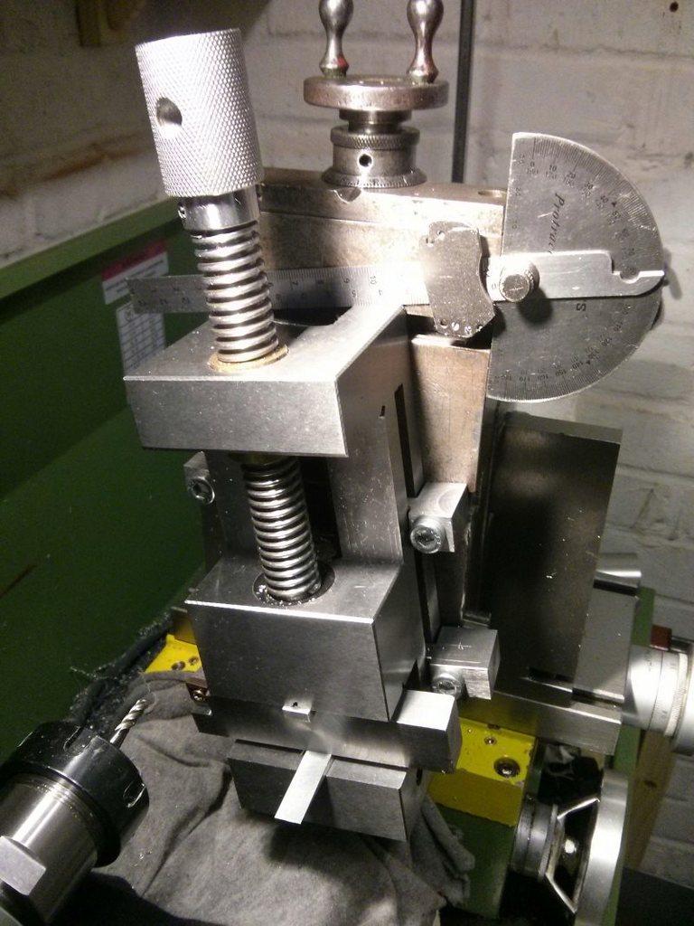

Set vice at 6 degrees and make some wedges, then set at 10 degrees and wedge work.
