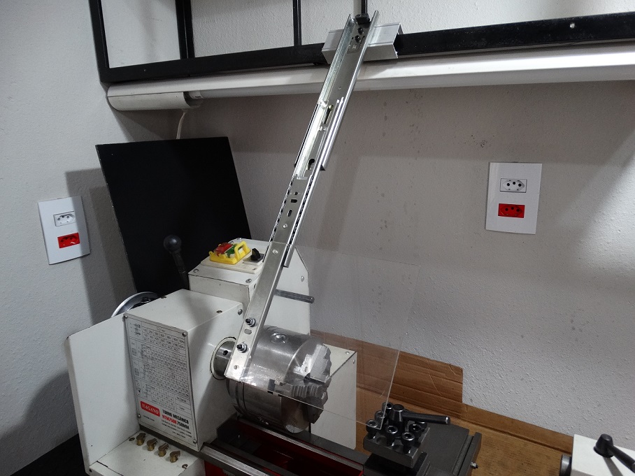

Ralphxyz, position the acrylic guard with the rail fully open. Change the position as needed. After use, just close, there's no secret, that's all!

Though I dont have a way of mounting it as shown, I think it could easily be altered. Thanks for the great idea !
Great idea, a drawer slide!
Fixes all shortcomings [too many] of run-of-the-mill versions.
NEVER seen or used before, any chip guard I thought worthwhile.

That is a novel idea to use a drawer slide to hold a clear guard shield. Being adjustable makes it always available and easy to slide out of the way.
Thanks for posting this! I think this is a great idea.
Yes but does it work? I'd like to see a video of it actually doing something.

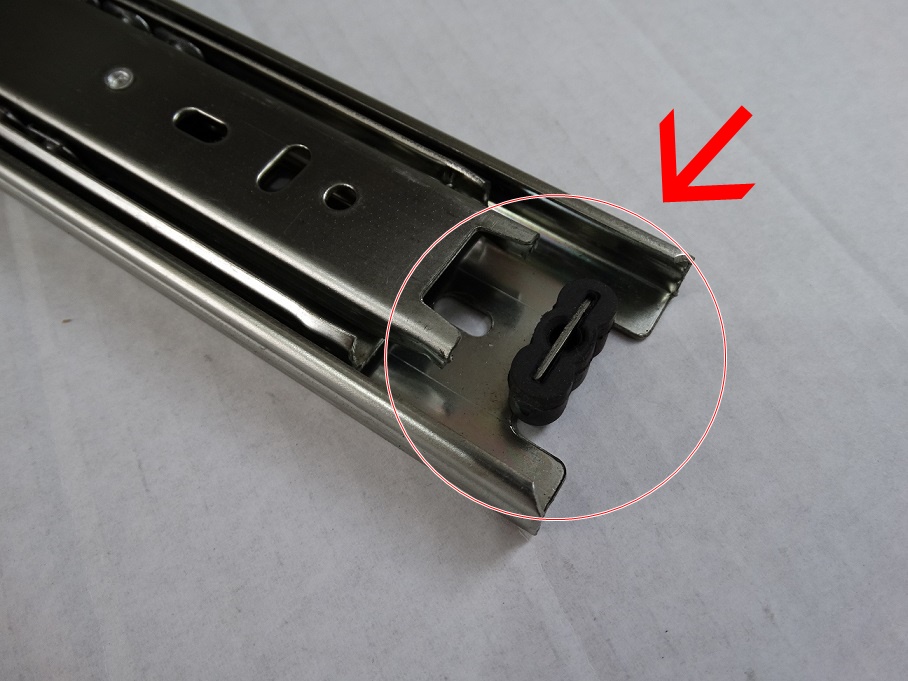

The working position of the rail is "fully open", it just works like this! The mechanism is so simple that it is ridiculous! Do not remove the locking rubber from the rail, this is how it stays closed and locked!
