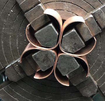

I needed some better soft jaws. Previously I used
small strips of aluminum which need to be held in
place as jaws are tightened.

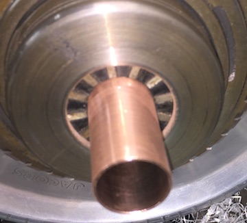

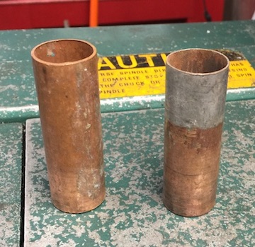

I rooted through my copper pipe remnants and found
suitable copper pipe.
Attachment 49921
Cleaned them up with abrasive strips
Attachment 49922

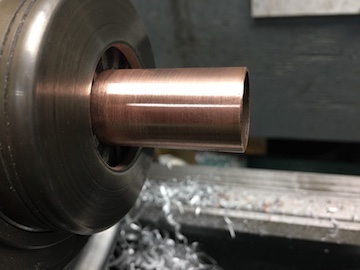

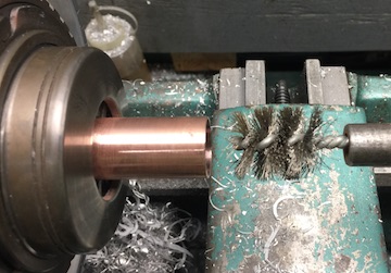

Used a wire brush on an extension to clean the inside
Attachment 49923

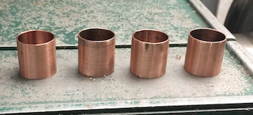

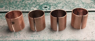

Mounted in the chuck and used a cut off tool to make pieces
Attachment 49924
Attachment 49925

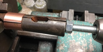

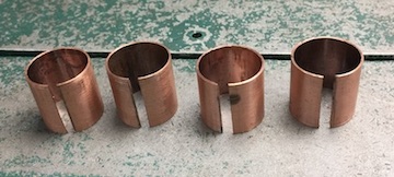

Went to the vise to slit the pieces with a band saw
Attachment 49926

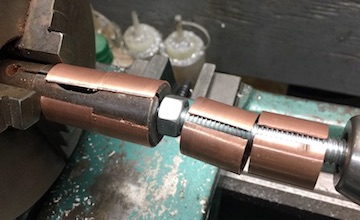

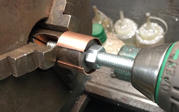

Used an old morse taper adapter pressed in using
the tail stock while slowly opening the chuck jaws as
the tube expanded.
Attachment 49927
As the first tube neared the end, I added the others
one by one until the popped off the adapter.
Attachment 49928
Attachment 49929
There was a lot of spring back. In retrospect I should
have annealed the parts before expanding

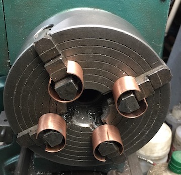

Attachment 49930

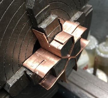

The tubes stretched over and firmly gripped the jaws.
Attachment 49931

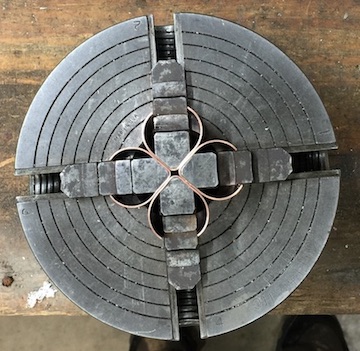

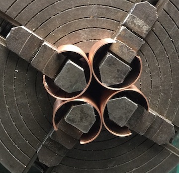

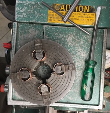

Mounted the chuck to allow for easy spinning
Attachment 49932

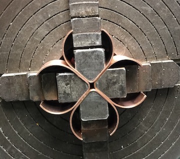

Center the jaws as the tubes make contact
Attachment 49933
Slowly close each jaw 1/4 turn on the wrench at a time.
Attachment 49934
Stop when the jaws are tight against each other
Attachment 49935

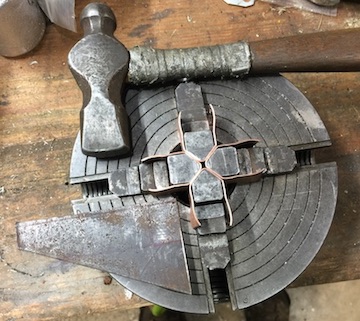

Move to the bench
Attachment 49936
Used a hammer and piece of steel to flatten the
remaining curves agains the jaws. Once again,
prior annealing would have been a good idea.
Attachment 49937

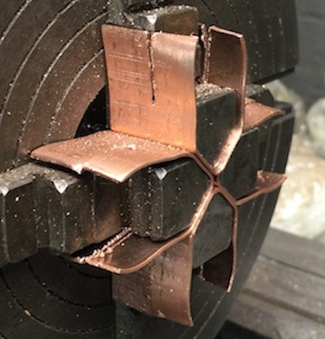

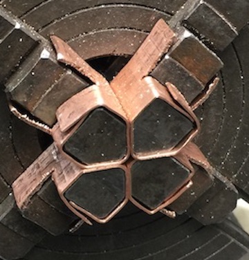

Return to the spindle to provide stability while using
a fine tooth hacksaw to cut slits
Attachment 49938

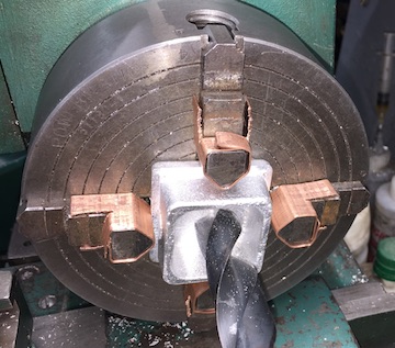

Tap the tabs down around to grip the back side of the jaw.
Attachment 49939
The finished soft jaws and ready for action
Attachment 49940
Attachment 49941
