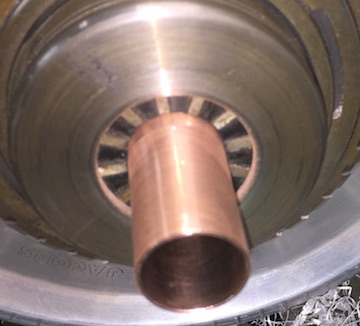

    I needed some better soft jaws. Previously I used
    small strips of aluminum which need to be held in
    place as jaws are tightened.

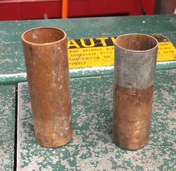

    I rooted through my copper pipe remnants and found
    suitable copper pipe.
Name:	01 Copper tubes.jpg

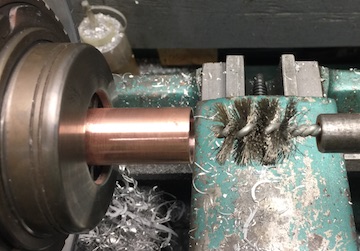

    Used a wire brush on an extension to clean the inside
Name:	03 clean inside.jpg

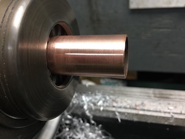

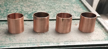

    Mounted in the chuck and used a cut off tool to make pieces
Name:	04 ready to cut.jpg
Name:	05 cut to size.jpg

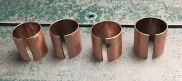

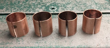

    Went to the vise to slit the pieces with a band saw
Name:	06 slit side.jpg

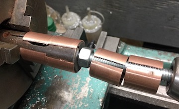

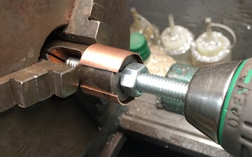

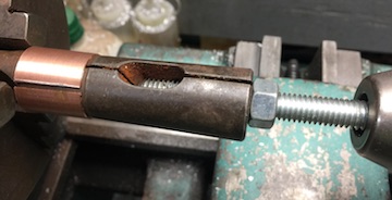

    Used an old morse taper adapter pressed in using
    the tail stock while slowly opening the chuck jaws as
    the tube expanded.
Name:	07 expand tubes.jpg
    As the first tube neared the end, I added the others
    one by one until the popped off the adapter.
Name:	08 expand tube.jpg
Name:	09 expand.jpg

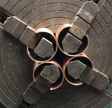

    There was a lot of spring back. In retrospect I should
    have annealed the parts before expanding
Name:	10 spring back.jpg

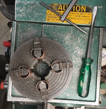

    The tubes stretched over and firmly gripped the jaws.
Name:	12 stretch on jaws.jpg

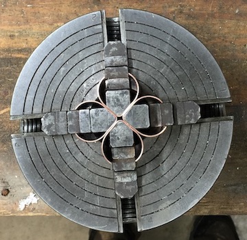

    Mounted the chuck to allow for easy spinning
Name:	13 mount chuck.jpg

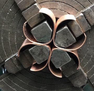

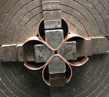

    Center the jaws as the tubes make contact
Name:	14 center jaws.jpg
    Slowly close each jaw 1/4 turn on the wrench at a time.
Name:	16 continue.jpg
    Stop when the jaws are tight against each other
Name:	17 finished.jpg

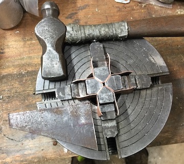

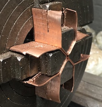

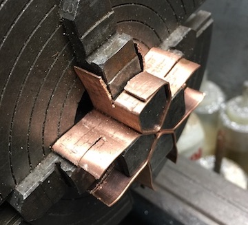

    Used a hammer and piece of steel to flatten the
    remaining curves agains the jaws. Once again,
    prior annealing would have been a good idea.
Name:	19 flatten curves.jpg

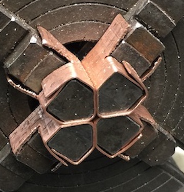

    Return to the spindle to provide stability while using
    a fine tooth hacksaw to cut slits
Name:	20 cut slits.jpg

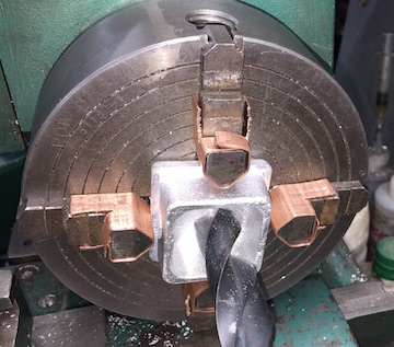

    Tap the tabs down around to grip the back side of the jaw.
Name:	21 fold tabs.jpg

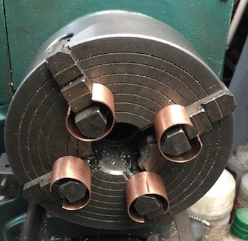

    The finished soft jaws and ready for action
Name:	22 finished.jpg
Name:	23 in action.jpg
