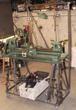

    Lathe stand
    Lathe stand-slathe_2.jpg 1937 southbend lathe note concrete block for stability and extra bracing
    Lathe stand-slathe_3.jpg note tool holder out of washers (make sure you have a howling wind when welding zinc coated stuff, its dangerous, and laptop holder for future CNC stuff
