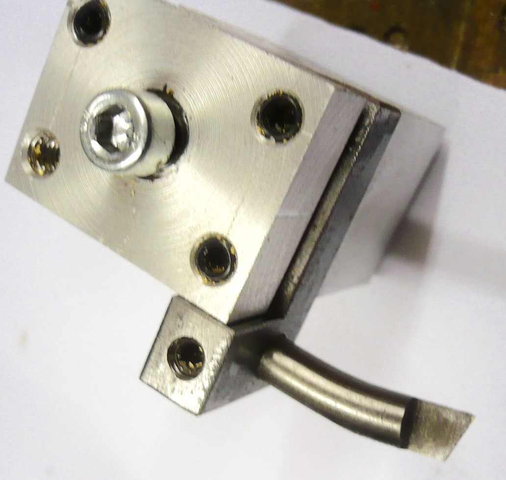

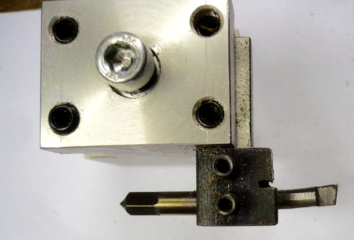

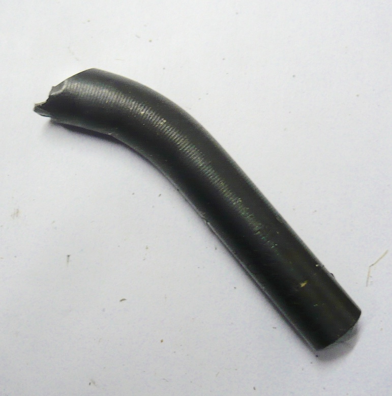

    Jon,
    I'm using bent twist drills for internal tools. Boring, threading, grooving.
    I heat them to cherry red and let them cool down.
    I found no degradation of tool life.
    Ulrich
