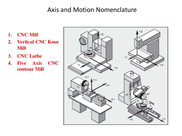

    Wouldn't that be the Z-axis?
    On a lathe, the z axis is the axis about which the work rotates...
    Regards, Marv
