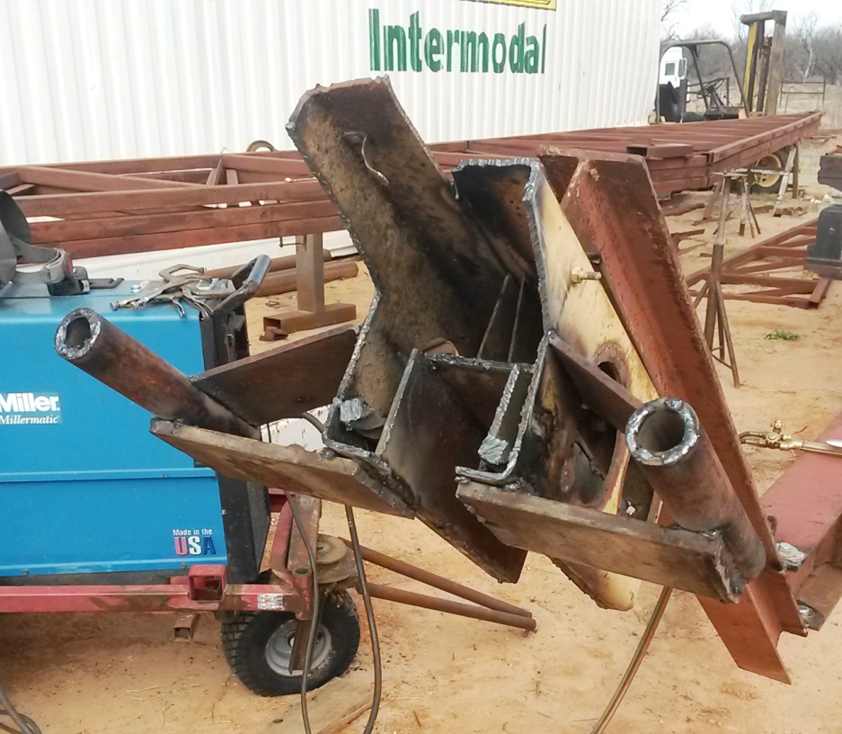

After making the extension for my fork boom I wanted a way to pickup the trusses without having to get out of the backhoe and attach them mainly because once I have them raised and welded in place I would have to find away to go up and unchain them from the boom.
So what I did was grab some scrap and make a cradle that I could hook under the top of a truss in the center then raise them.
Attachment 28751
This might have worked fine for the single truss or even this one if I hadn't welded the spacer block where I did so back to make another mod.
Now I have spread the forks if you will, out to about a foot and a half

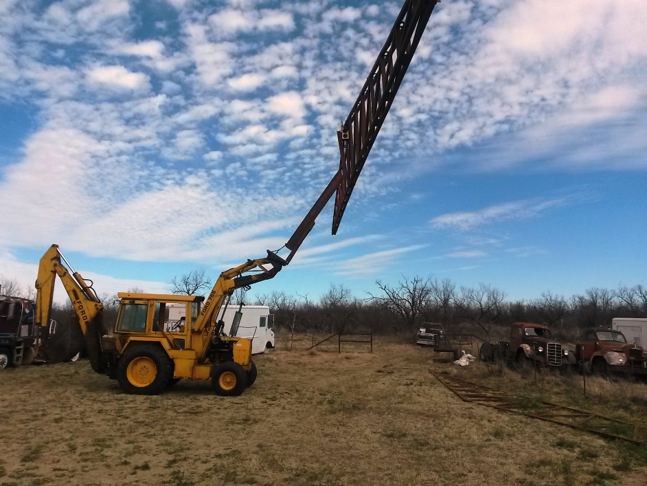

Attachment 28752

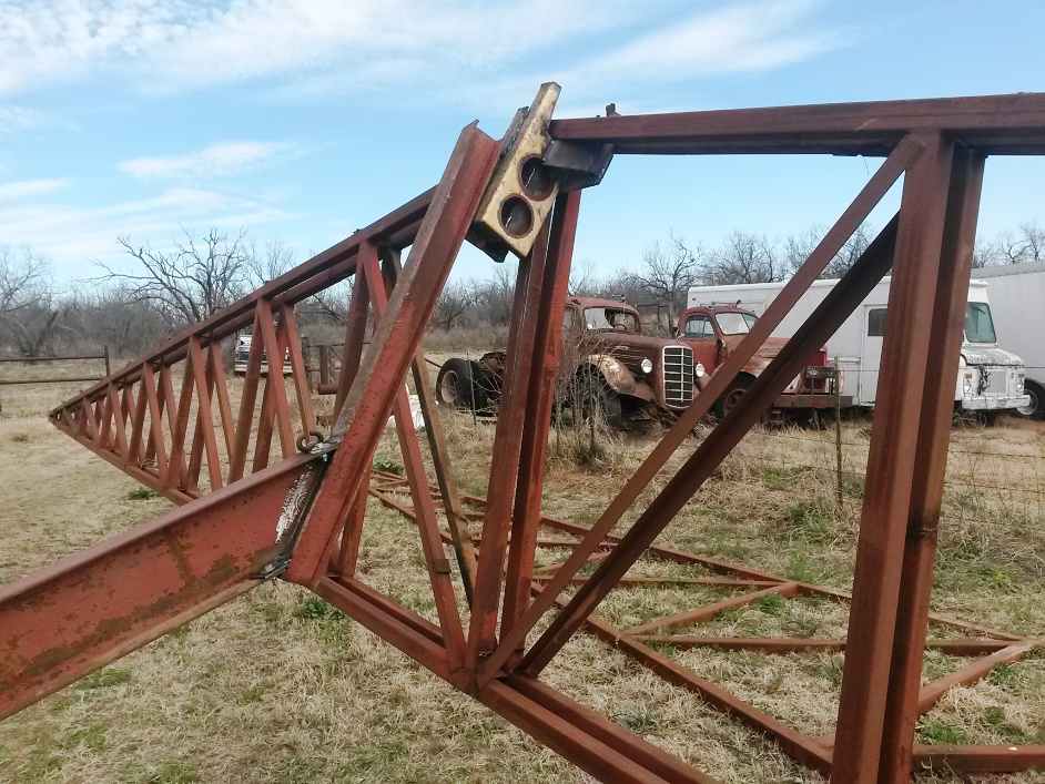

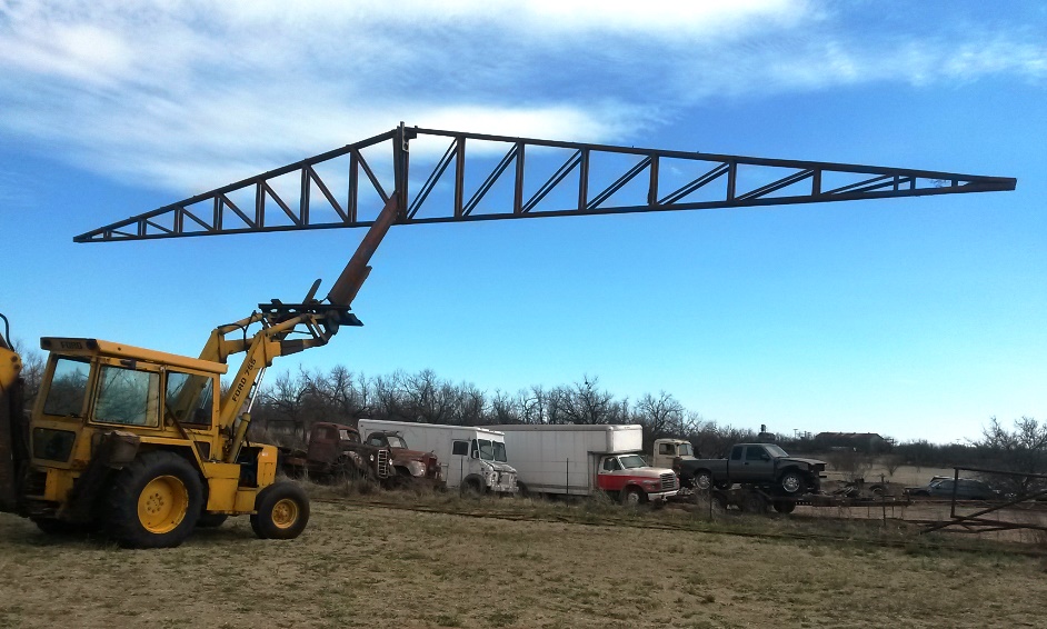

This mod has allowed me to lift the truss like I wanted and at the same time the grove helps to keep it stable while in transit or lifting
Attachment 28753

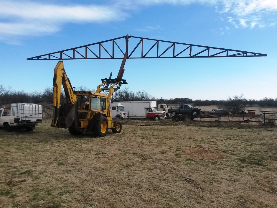

Attachment 28754
This is also the heaviest truss and I didn't have to use the back hoe bucket as an additional counter weight by extending it back.

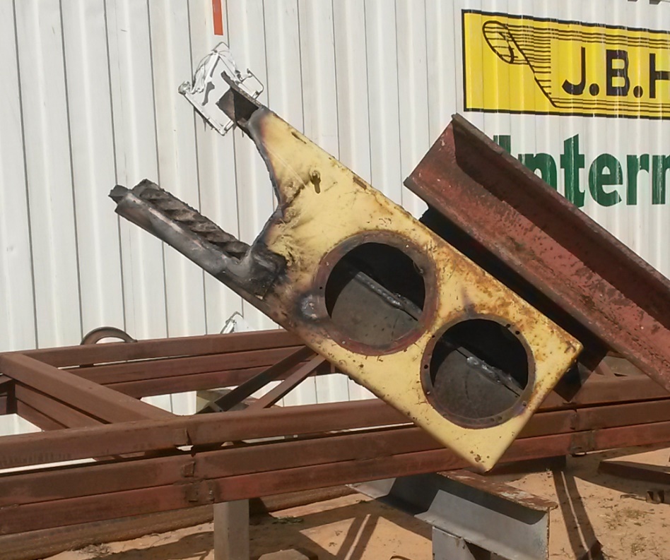

Attachment 28755
This is what it looks like up close while down
