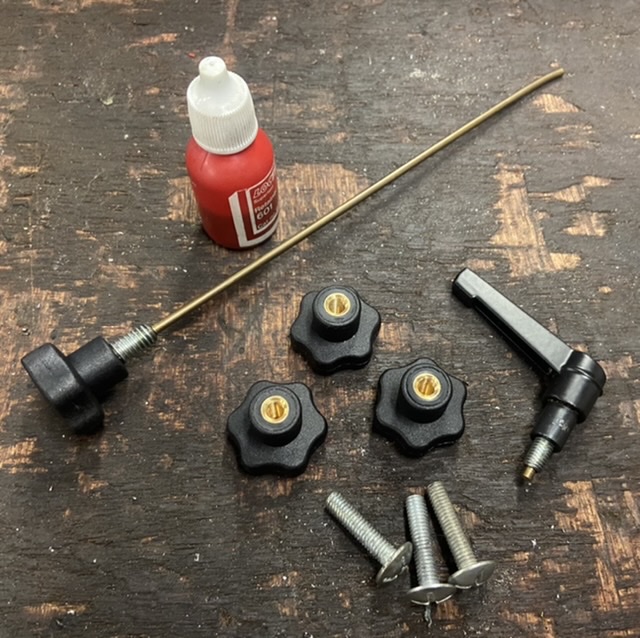

Hi All

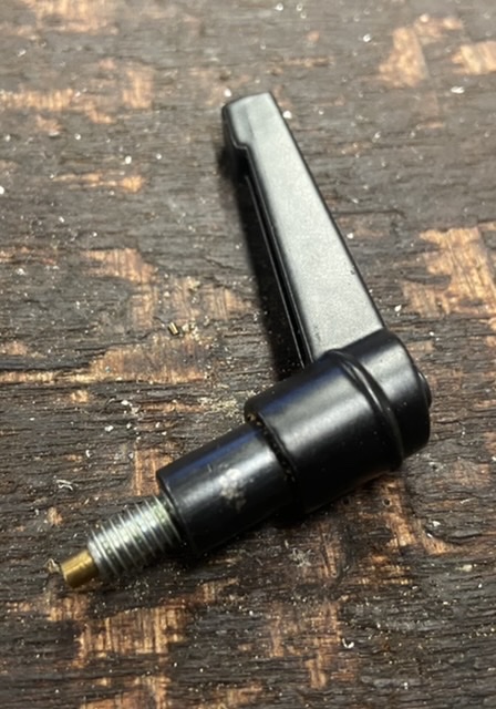

I hate grub screws or bolts as a clamping method on shafts where adjustments are constantly needed to be made, and I am always hunting for the Allan key or spanner. Another issue is the damage they can do to the shaft. Yes, you can machine a flat along the length of the shaft or place a slug of soft material between the shaft and clamp screw but you still need to find that Allen key or spanner:headshake:
Anyway rant over!
To over come this I always (when ever possible) fit knobs or handled levers. This overcomes the Allen key and spanner issue.
The Knobs and levers I purchase are female thread so I can make my own length threads. I have a stock of metric threads from 5mm to 12mm with various diameter handle sizes. These are cheap so buy in bags of 10. The lever type are more expensive so I tend to buy these as I need them.
To over come the damage caused to the shaft I simply drill a hole in the end of the stud and loctite a brass insert. This then prevents damage to the shaft and the need to machine a flat along the shaft.
Hopefully the photos below will make it clear.
Attachment 41791 Components and materials to make locking handles

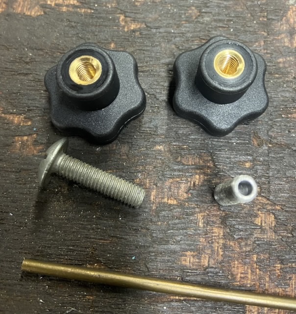

Attachment 41792 Stud made from M6 bolt and drilled to accept brass.

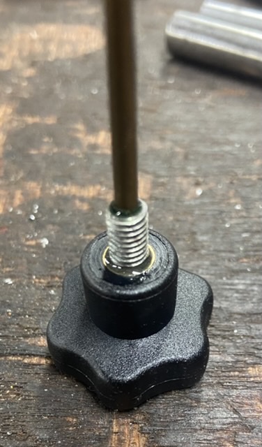

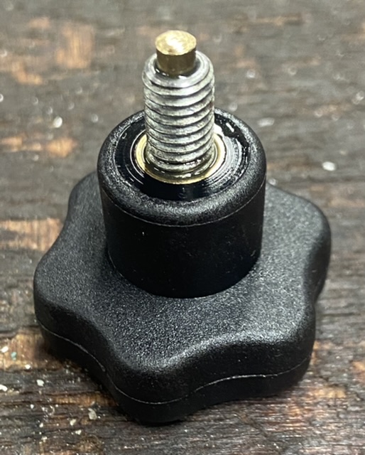

Attachment 41793 Both the stud and brass loctite in position.
Attachment 41794 Attachment 41795 Brass slug then cut to length

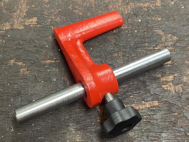

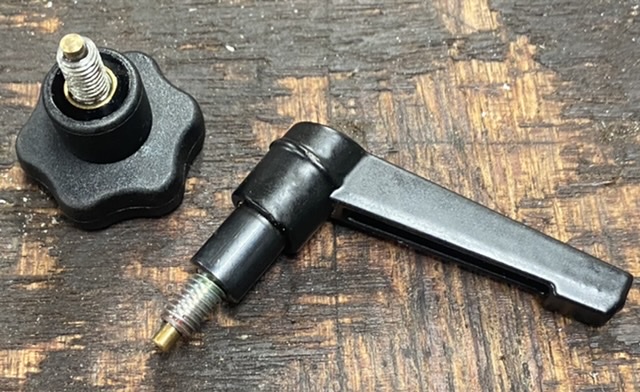

Attachment 41796 Lever and knob ready to use.
Attachment 41790 Knob used on stop for 4x6 bandsaw
Not only are these practical I also think these give a nice finish to any job.
