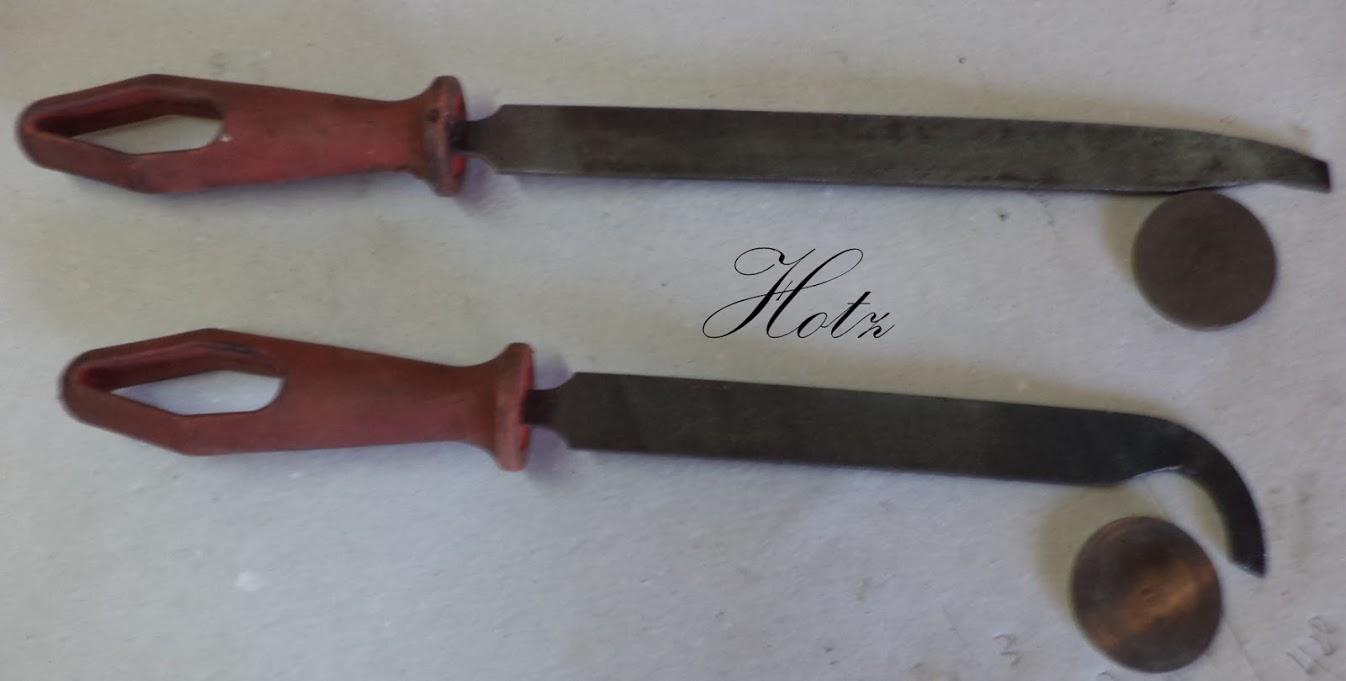

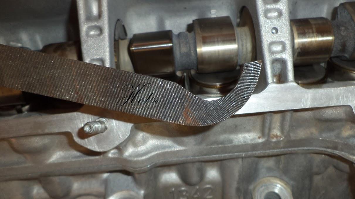

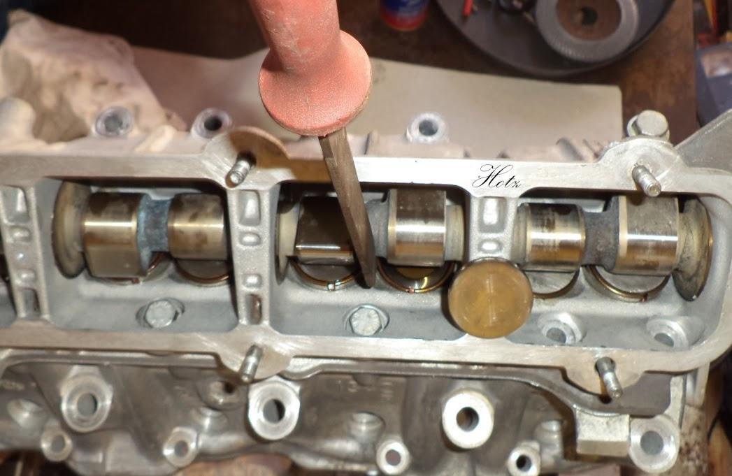

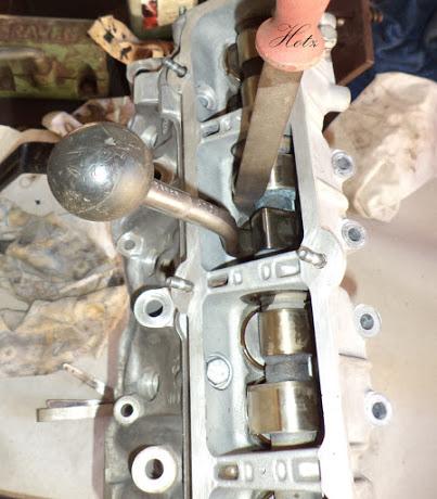

Made from a file to sharpen used, this tool helps in regulating clearance valves. Only warmed and chip away to afford the desired shape.
