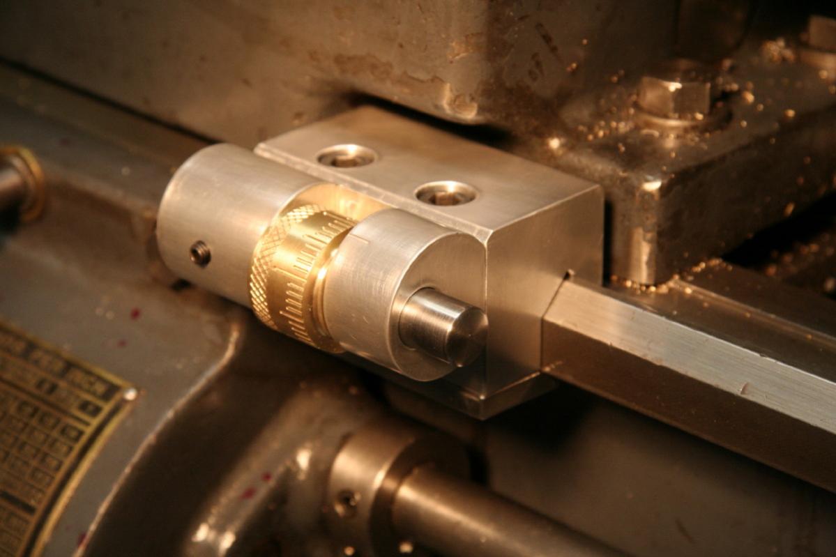

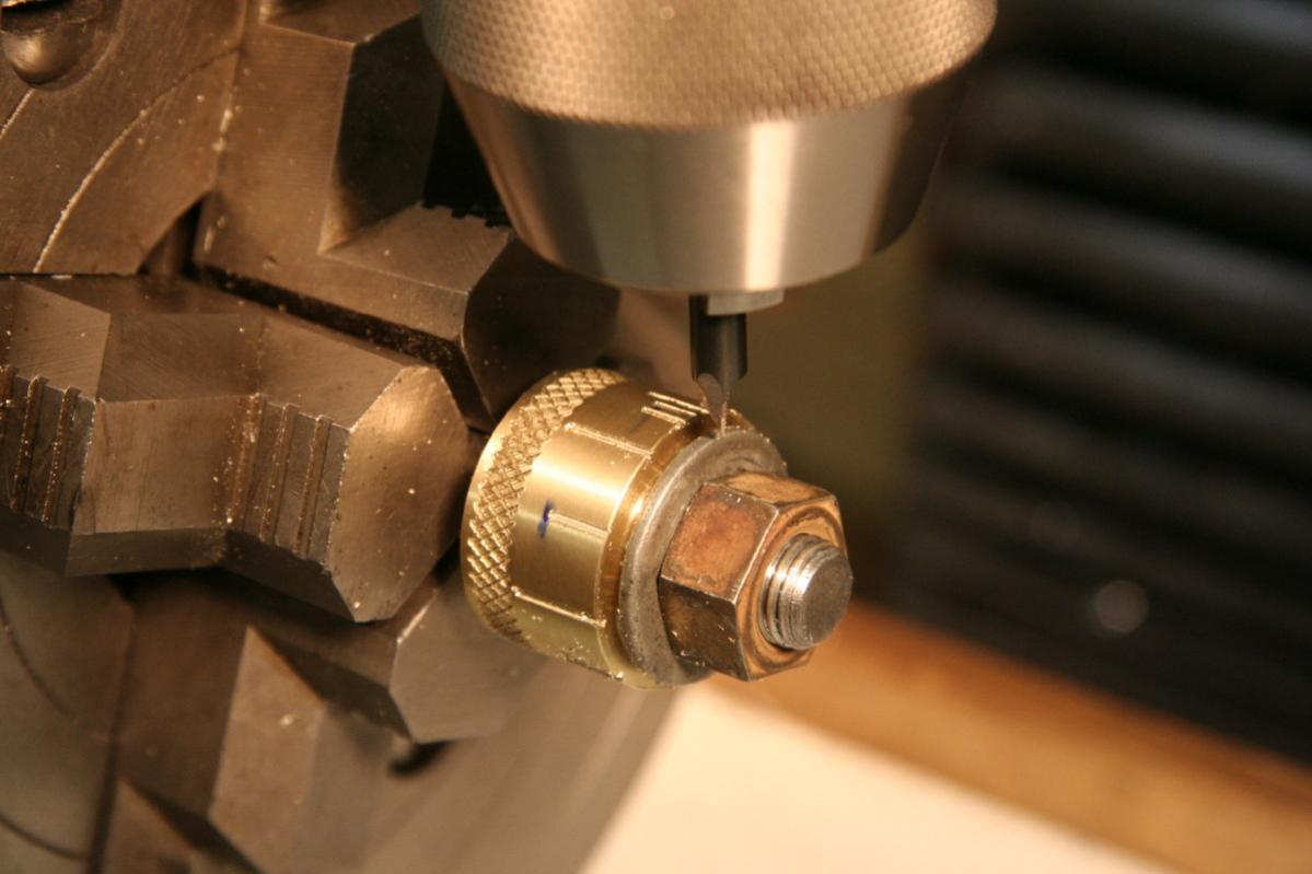

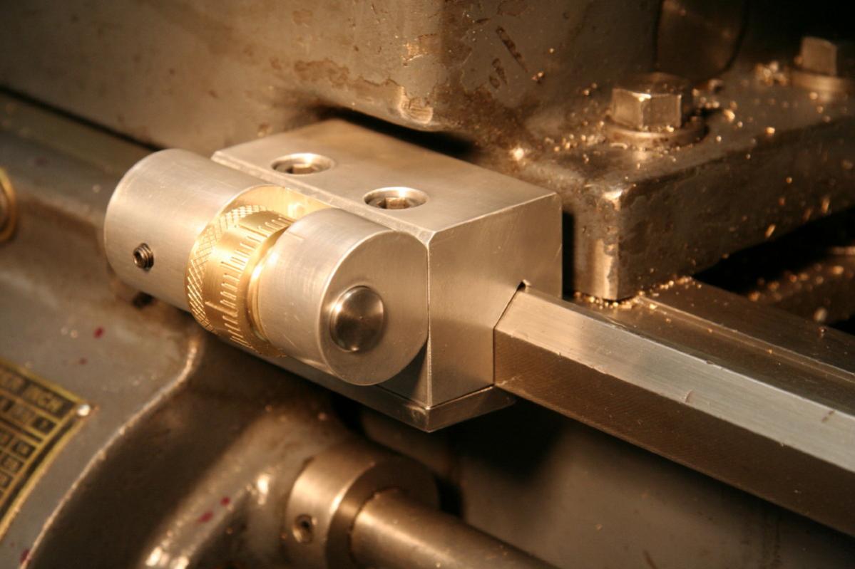

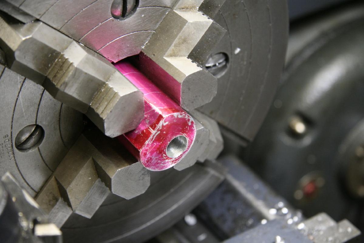

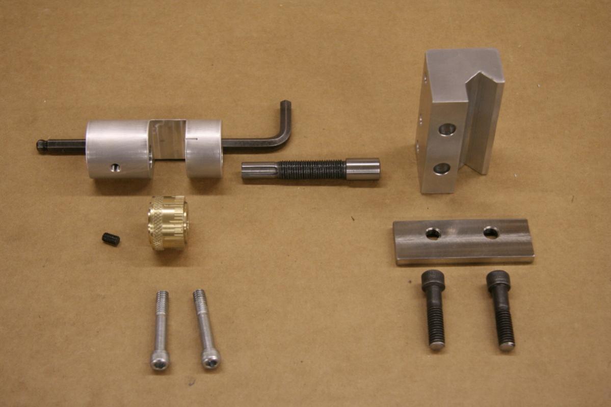

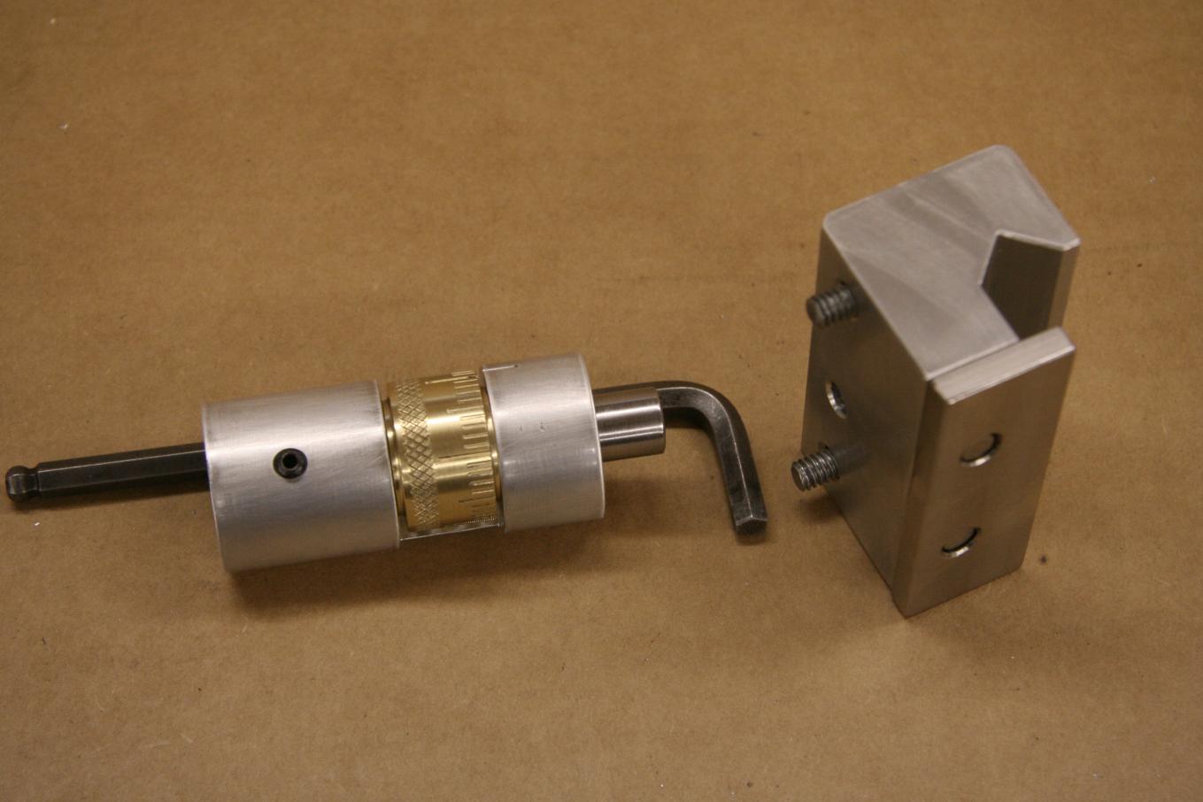

A Carriage Stop for my Logan 11" Turret lathe. Made from 6061 Alu, 316 Stainless clamp plate, Brass Dial, Drill Rod shaft. Made from scrap from around the shop. Contact me for drawings and I will email.Attachment 1312Attachment 1313Attachment 1314Attachment 1315Attachment 1316Attachment 1317
