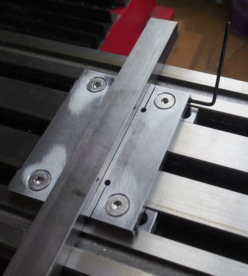

I needed something different in order to hold some wide stock on the milling table and came up with this:
Attachment 22999
A simple make for this is available here along with tips:
Low Profile Clamp – glue-it.com
Not sure the clamping forces are high enough for this initial version, but hopefully this will inspire someone to improve on it.
