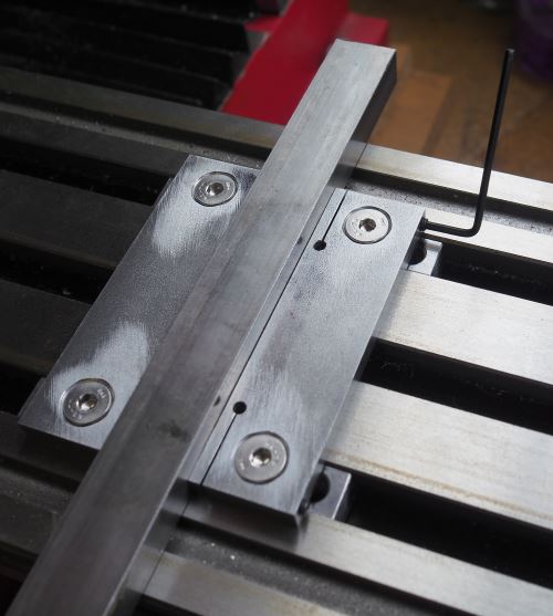

    I needed something different in order to hold some wide stock on the milling table and came up with this:
    A simple make for this is available here along with tips:
    Low Profile Clamp – glue-it.com
    Not sure the clamping forces are high enough for this initial version, but hopefully this will inspire someone to improve on it.

    Nice & simple I like it
    I wonder if it is strong enough to clamp a precision mill vise? It might need beefing up a bit.

    It does hold well, but not suitable for heavy machining. I think it would need to be 3/8" thick (~10mm) and then use 6mm grub screws or bolts to clamp a precision vice.
    As somebody else pointed out, if you used 3/8" you could machine a lip that would allow you to raise the material off the bed by a fraction, that way you could machine through the clamped material.
