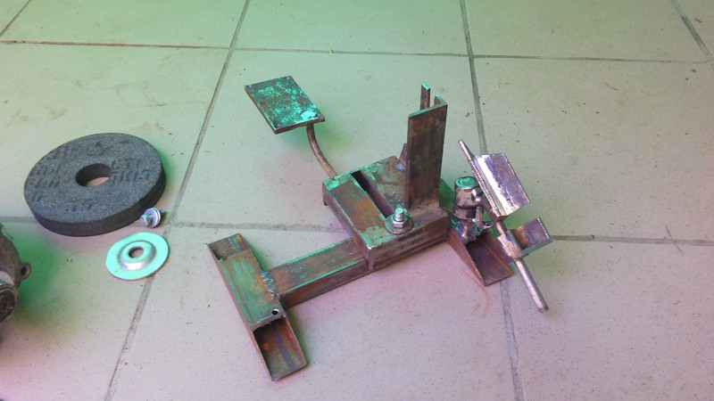

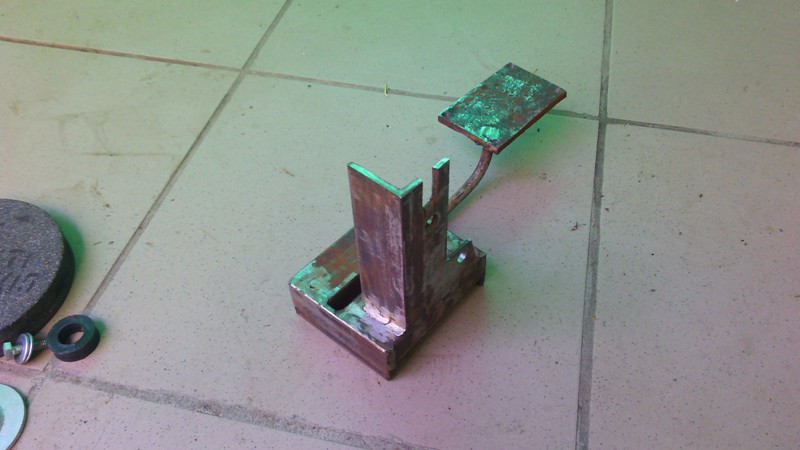

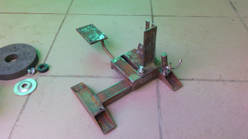

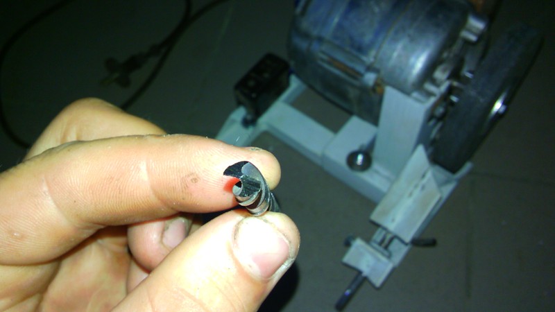

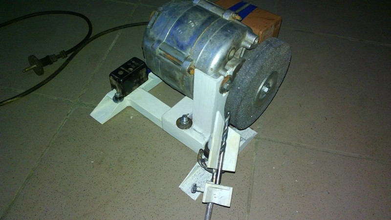

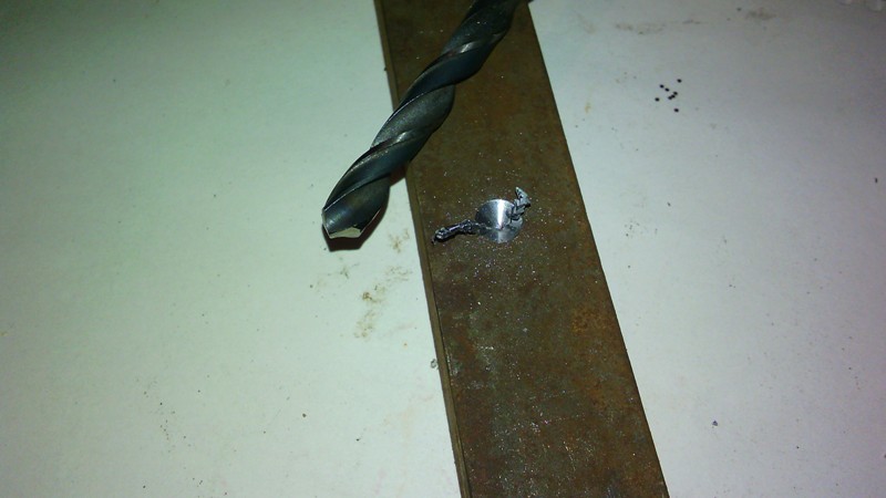

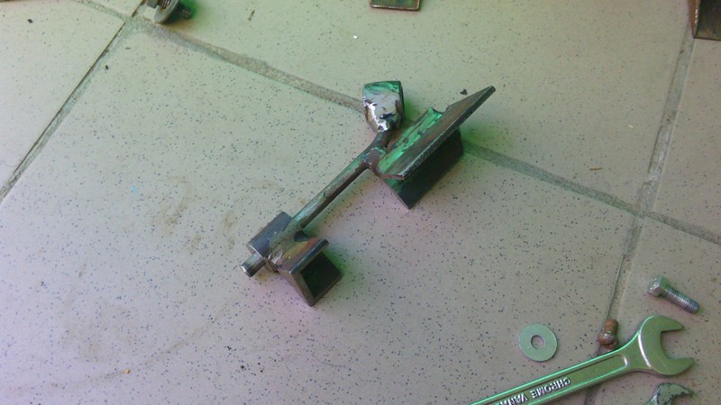

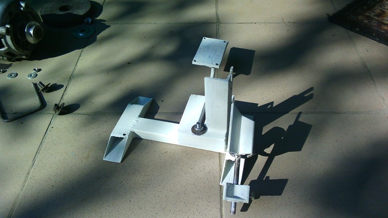

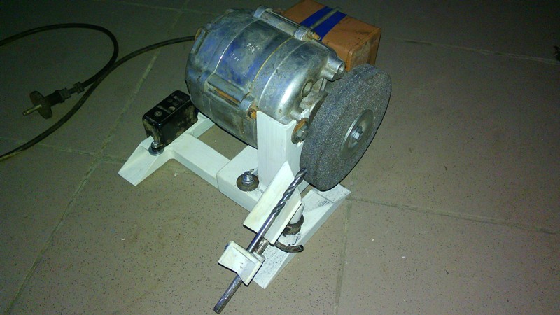

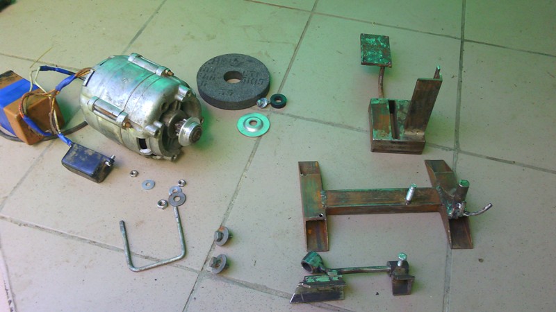

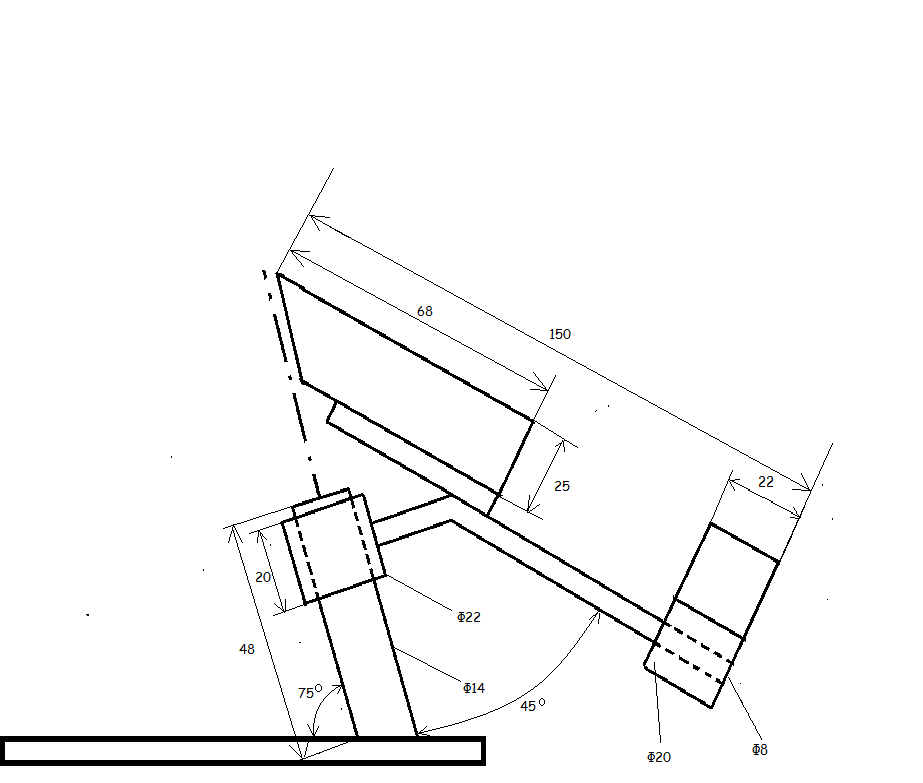

Hi. My homemade and very simple machine for precise sharpening drills. The engine of an old washing machine 180W 1350 rpm, everything else is trimming tubes and angles.
Attachment 12060 Attachment 12061 Attachment 12062 Attachment 12063 Attachment 12064 Attachment 12065 Attachment 12066 Attachment 12067
