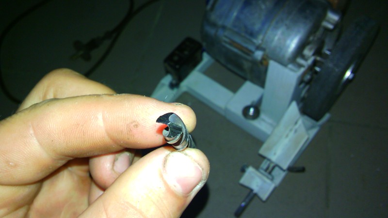

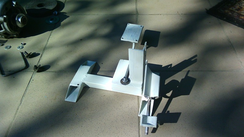

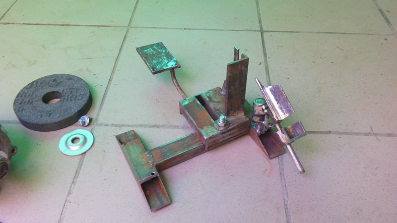

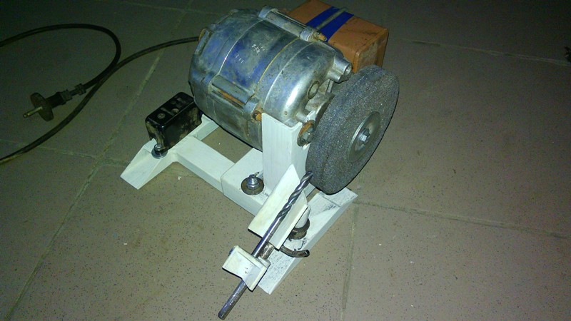

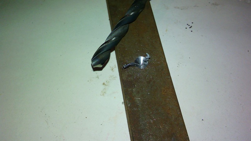

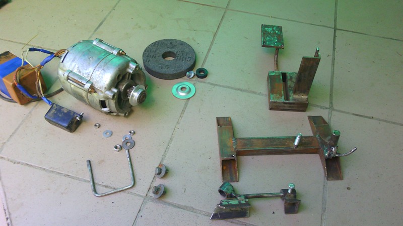

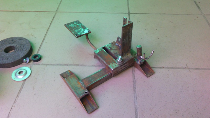

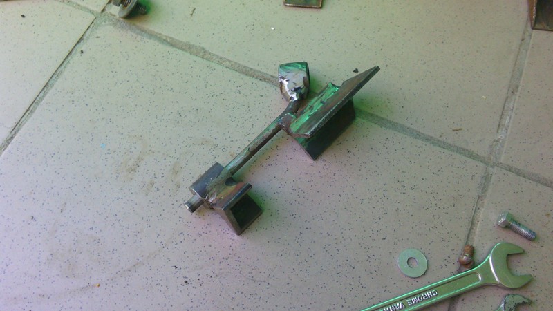

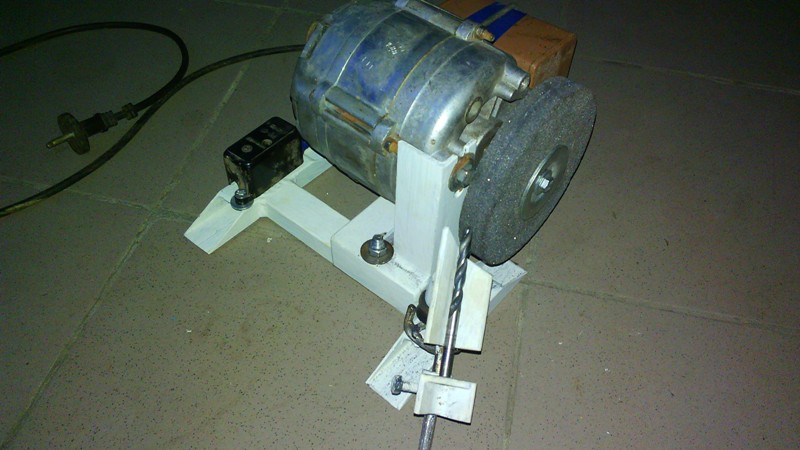

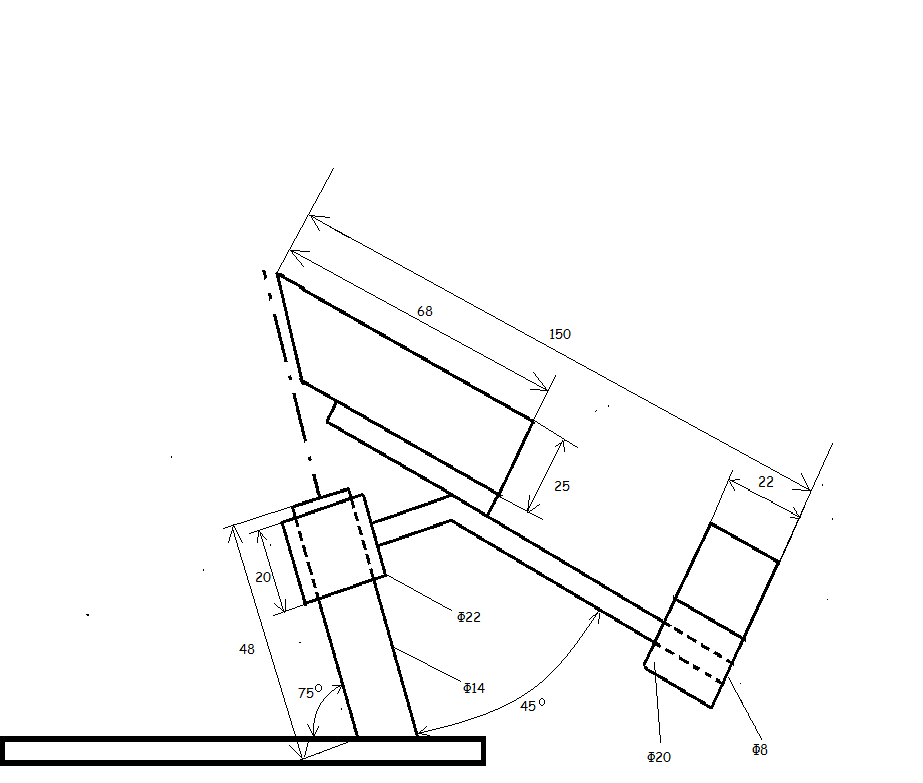

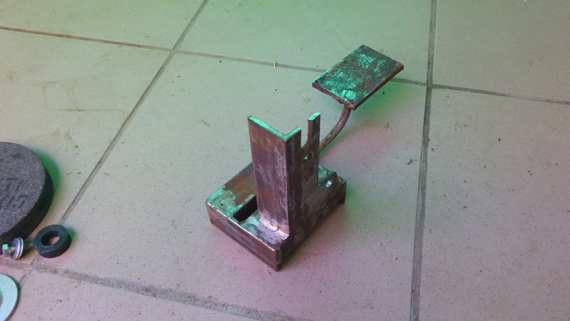

    Hi. My homemade and very simple machine for precise sharpening drills. The engine of an old washing machine 180W 1350 rpm, everything else is trimming tubes and angles.
