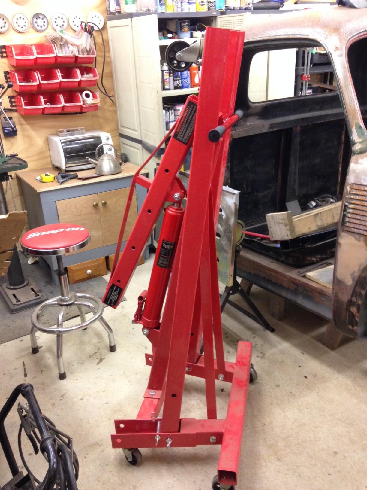

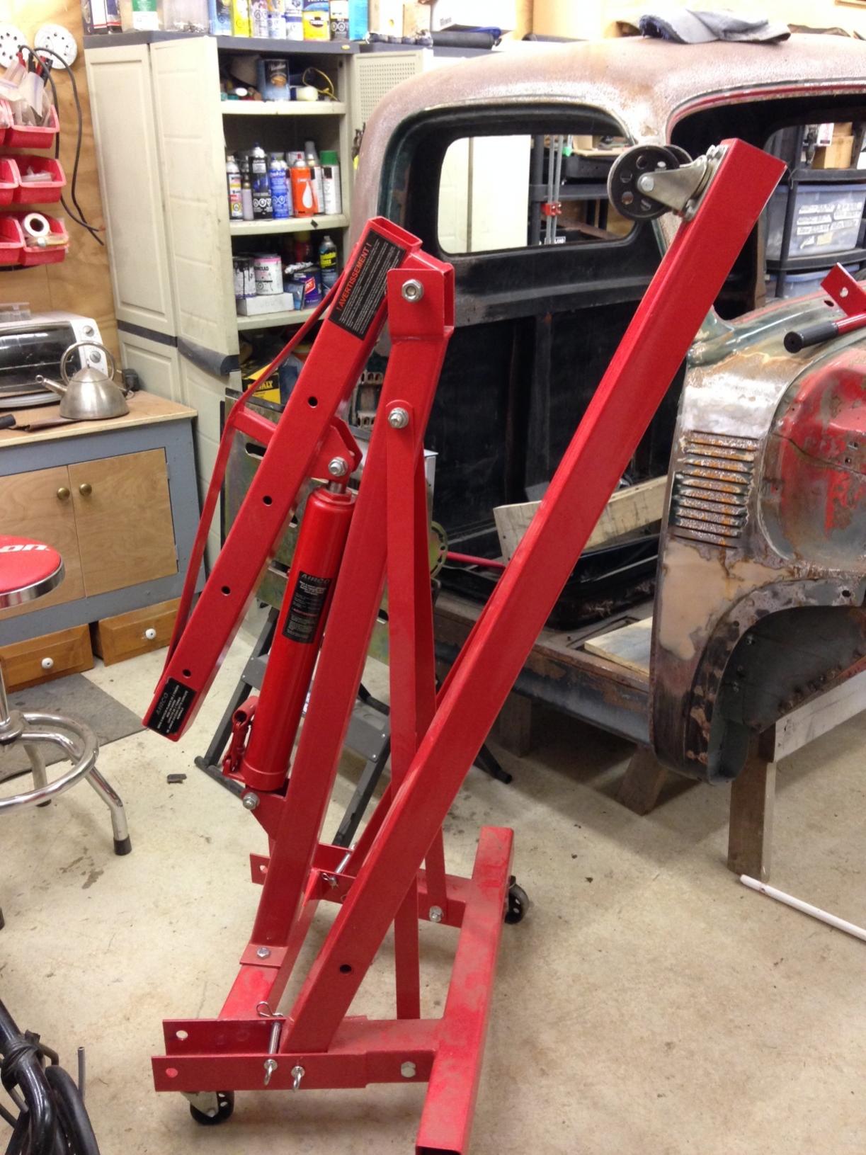

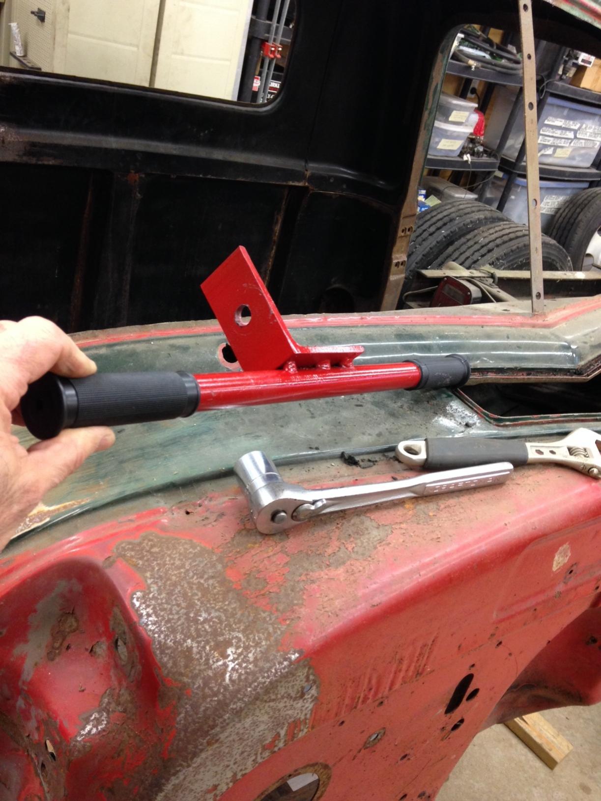

    I didn't like the way the folding legs on my engine hoist tilted back in the up position, so I decided to make a stop so they wouldn't travel so far. The handle also doubles as a handle to move the hoist around the shop. I just welded a small piece of angle iron onto a piece of pipe, then attached it to the bolt that the lift arm pivots on. So, you can put it on or take it off by just undoing one nut. The handles are just $1 rubber handles from a hardware store.

    That does keep the foot print smaller! Good job!

    I duplicated this idea on my crane - great idea

    I had made exactly the same addition. I also changed the top bolt on the cylinder to a QD pin. I pull the pin for storage and this allows the boom to fold down some more. I had to grind a bit off the mounting tabs to clear the cylinder.

    An interesting feature of certain import products; a collapsible device (for efficient storage) not condensed into smallest foot print?
    Half a dozen individuals make a similar alteration for the same reason, to lessen room consumed of storage.
    So how qualified or experienced can the original designer be? Even looking at the before condition appears a potential high center situation if pushed above waist high from 'front', one little pebble is all it might take.
