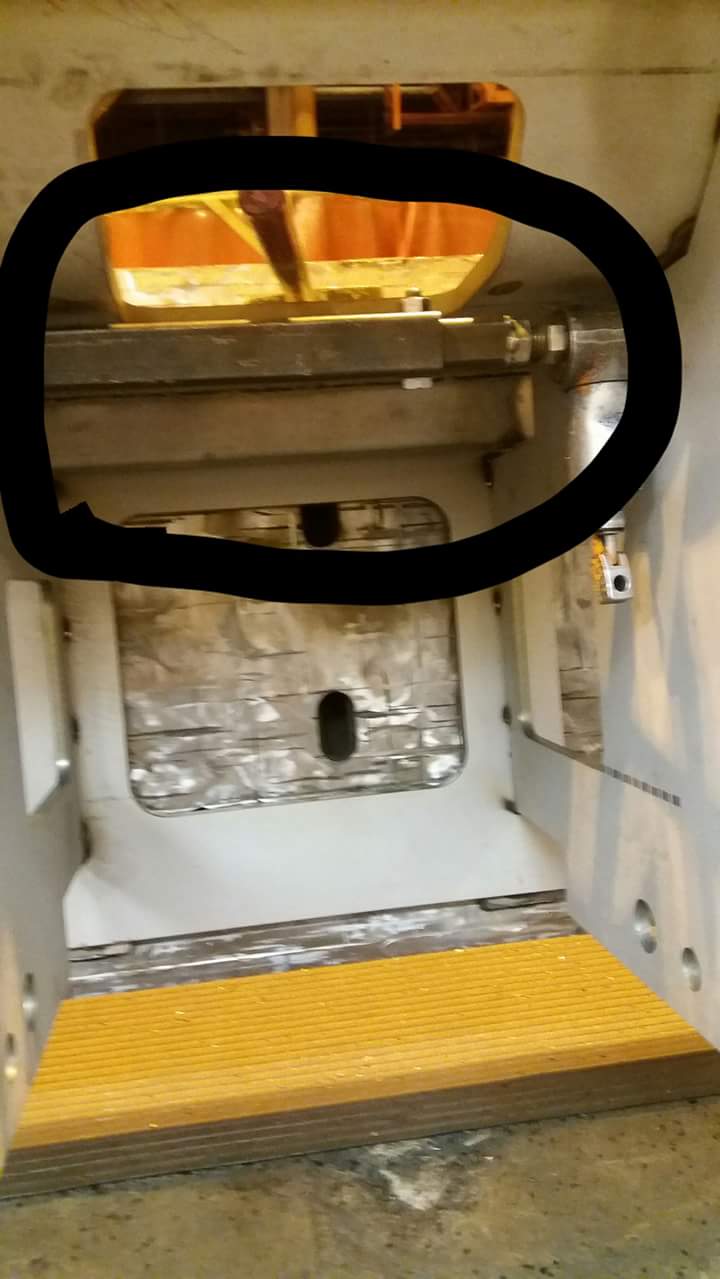

    Made this simple tool.
    Its lenght can be adjusted.
    Used it with a jack, to spread ribs to their right location.
    Unfortunatelly... used it with 25 ton jack, my marvellous tool collapsed and jack bounced to my chest.
    It mislocated two ripbones and my heart jumped to little higher tone, hearstop was somewhat close.
    Everything is fine now, but that was something i didn't expect to happen.
    Tought that i could share this as a reminder. Be carefull!
