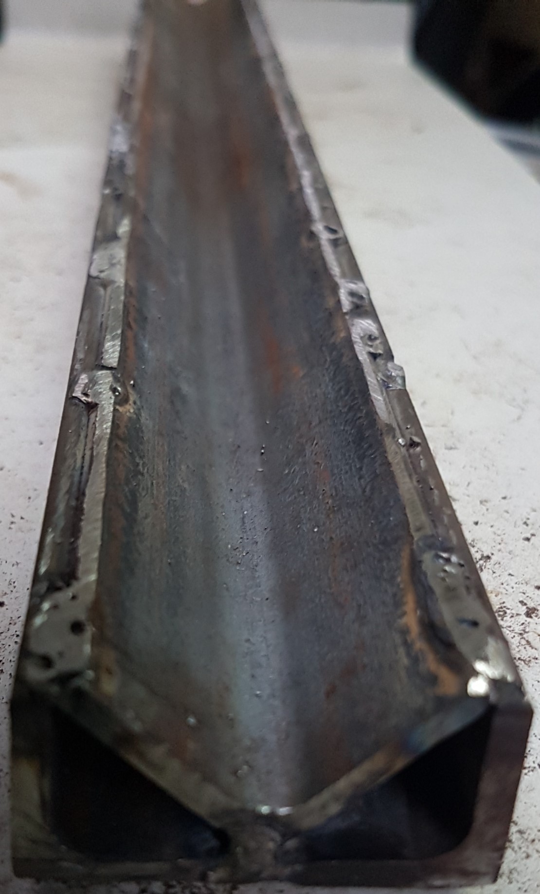

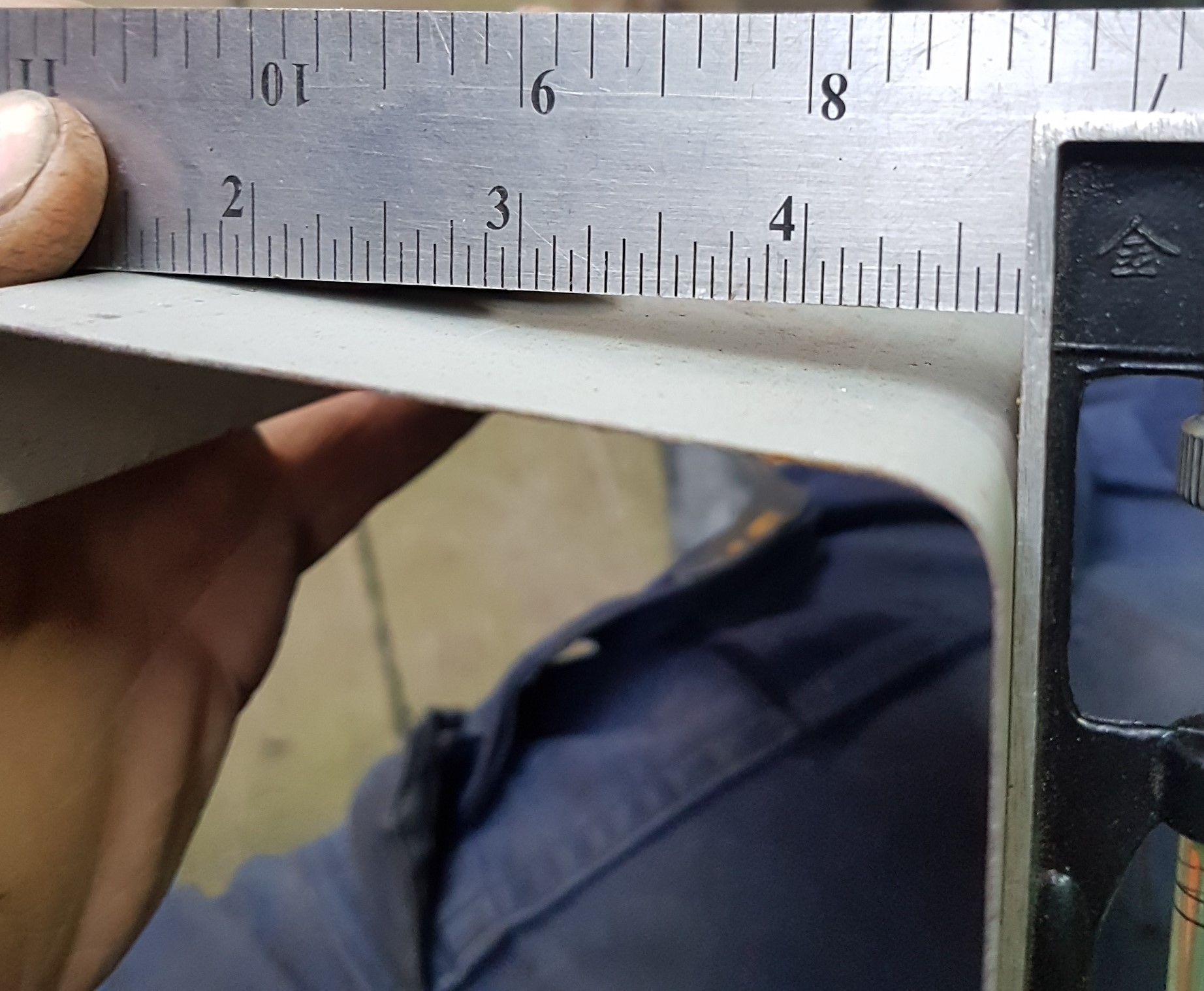

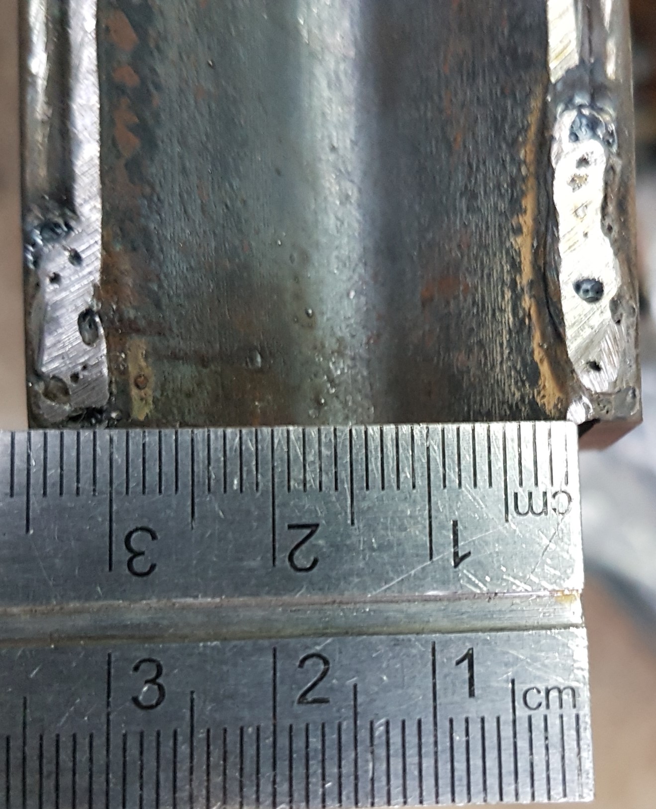

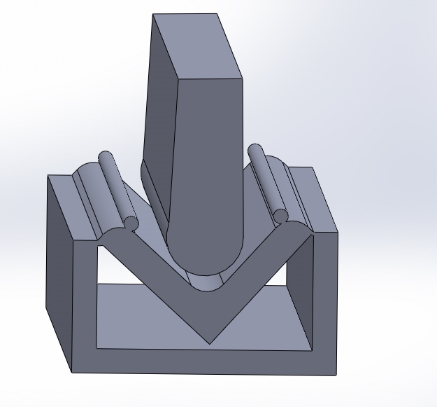

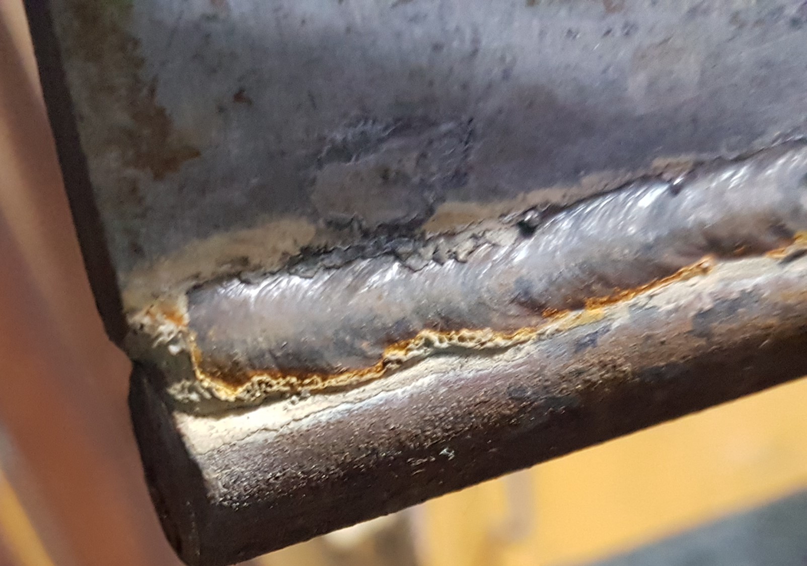

I've built a small press brake to use in my hydraulic shop press but for some reason it will not bend to 90 degrees. Can anyone tell me what I have done wrong. Here are some photos of it. V is 30mm wide and rod is 16mm diameter.
Thankyou
