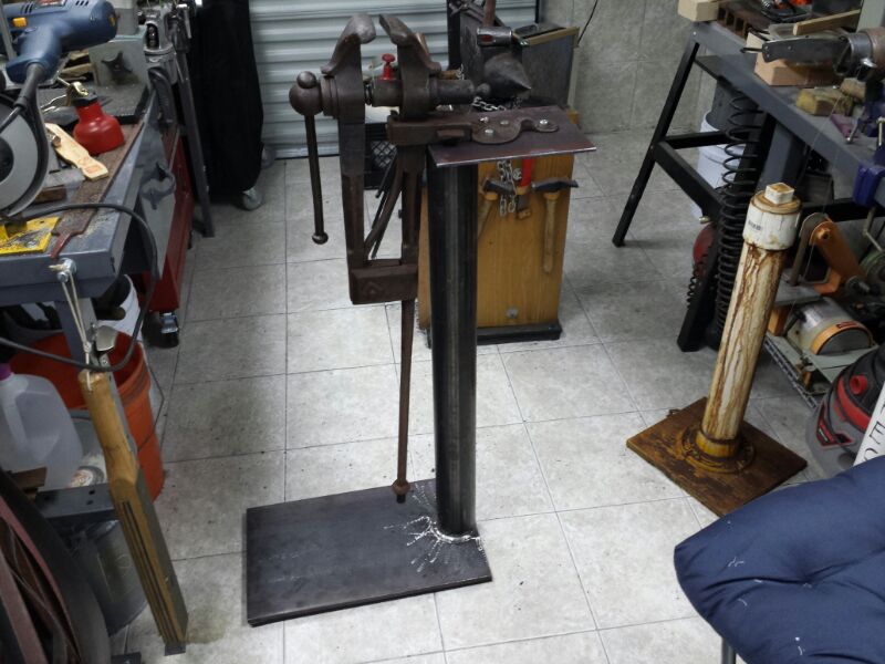

Made this stand out of 3/8" plate and a piece of 4" black pipe.
Attachment 2812

Nice stand. No stability issues for you?
Hmmm ... need to make one of those for my bench grinder. Good work!
The base has a piece of horse stall mat glued under it. I place one foot on the base at all times when torking it down. No problems to date. I use it nearly every day I'm in the shop.
My base is 18x24 and the vise has 4" jaws. I looking for a 6" my next trip north.
Good tip on the horse mat. And yeah, I would be putting a foot on it for stability too. Thanks.
