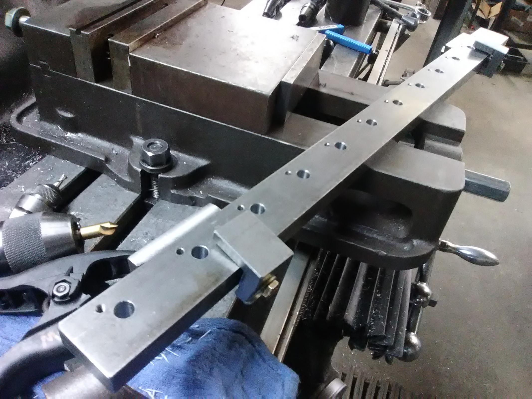

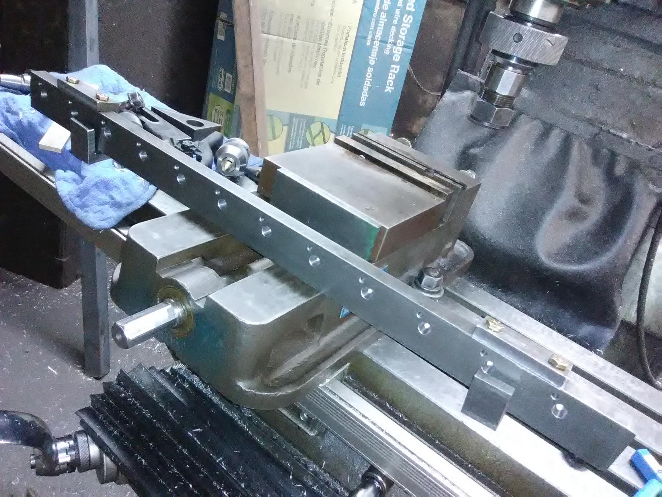

    There aren't many ways to drill 2" centers over 10 feet [60 holes], in 4 strips. Built a drill jig. . .

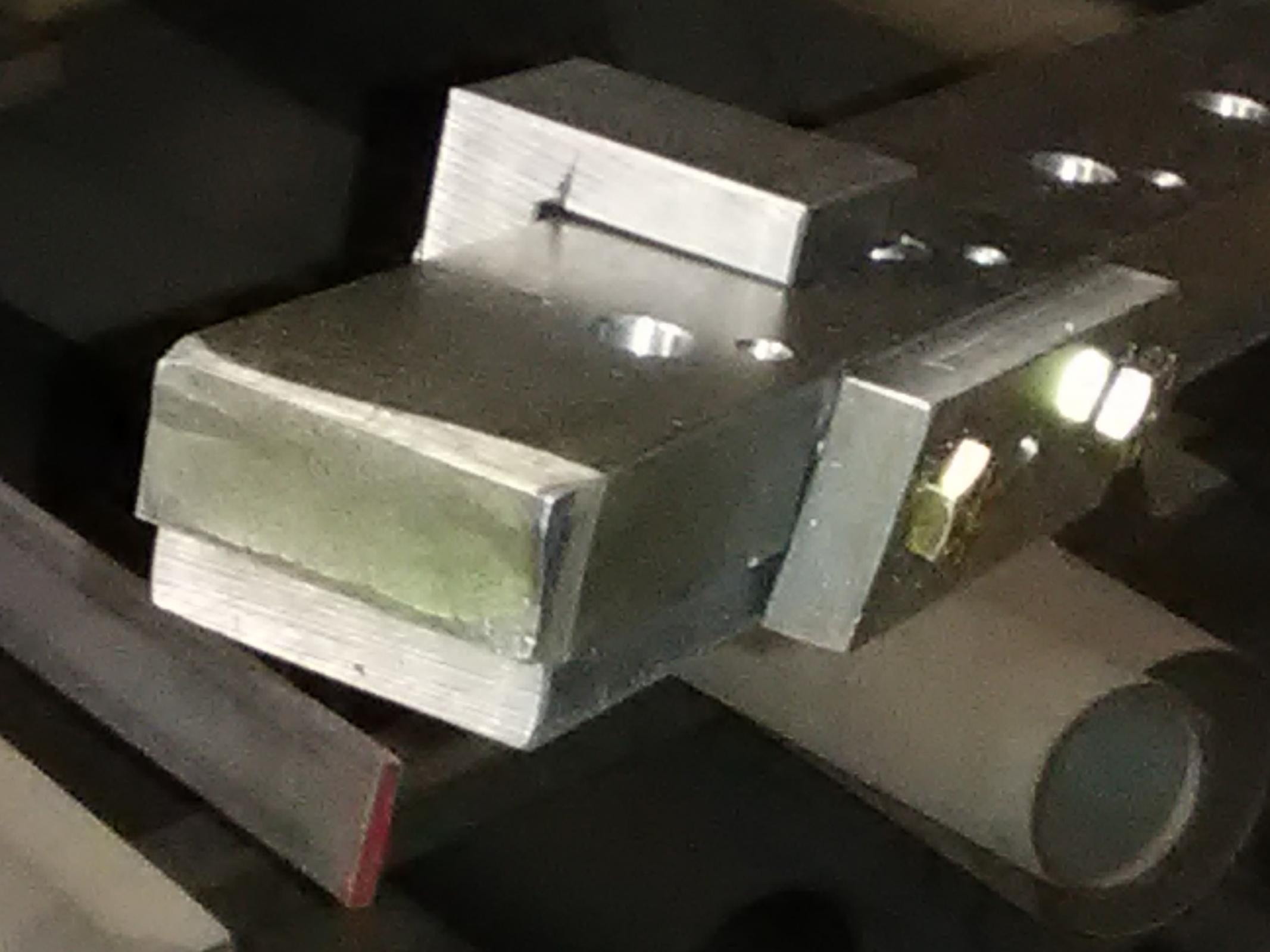

    Bottom is flat, clamping directly to material, to slide over drill press table.

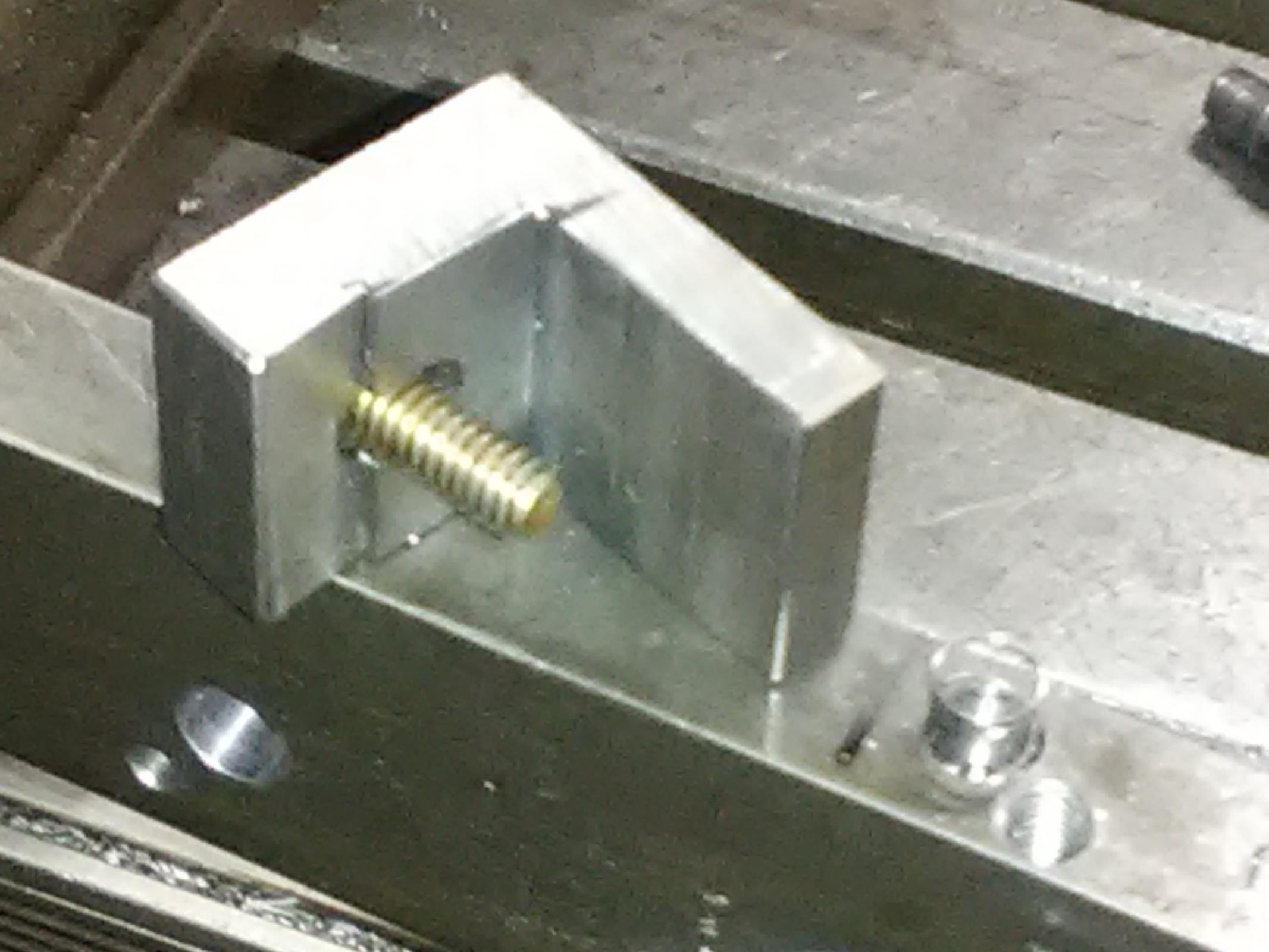

    The magic number 7° applies to the clamp system.

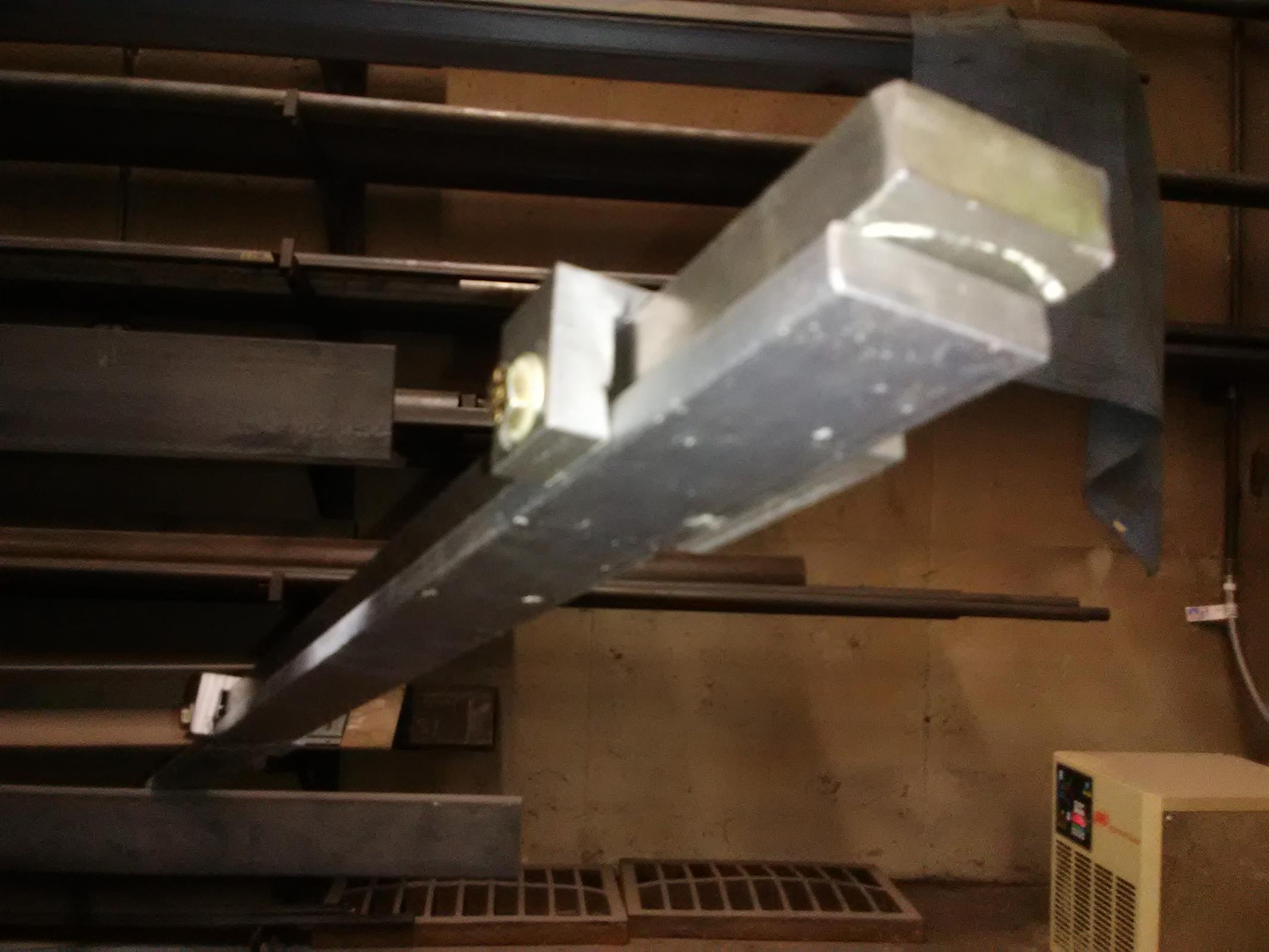

    On the back [locating] side, 2 flats are milled 7°, with plates screwed on.

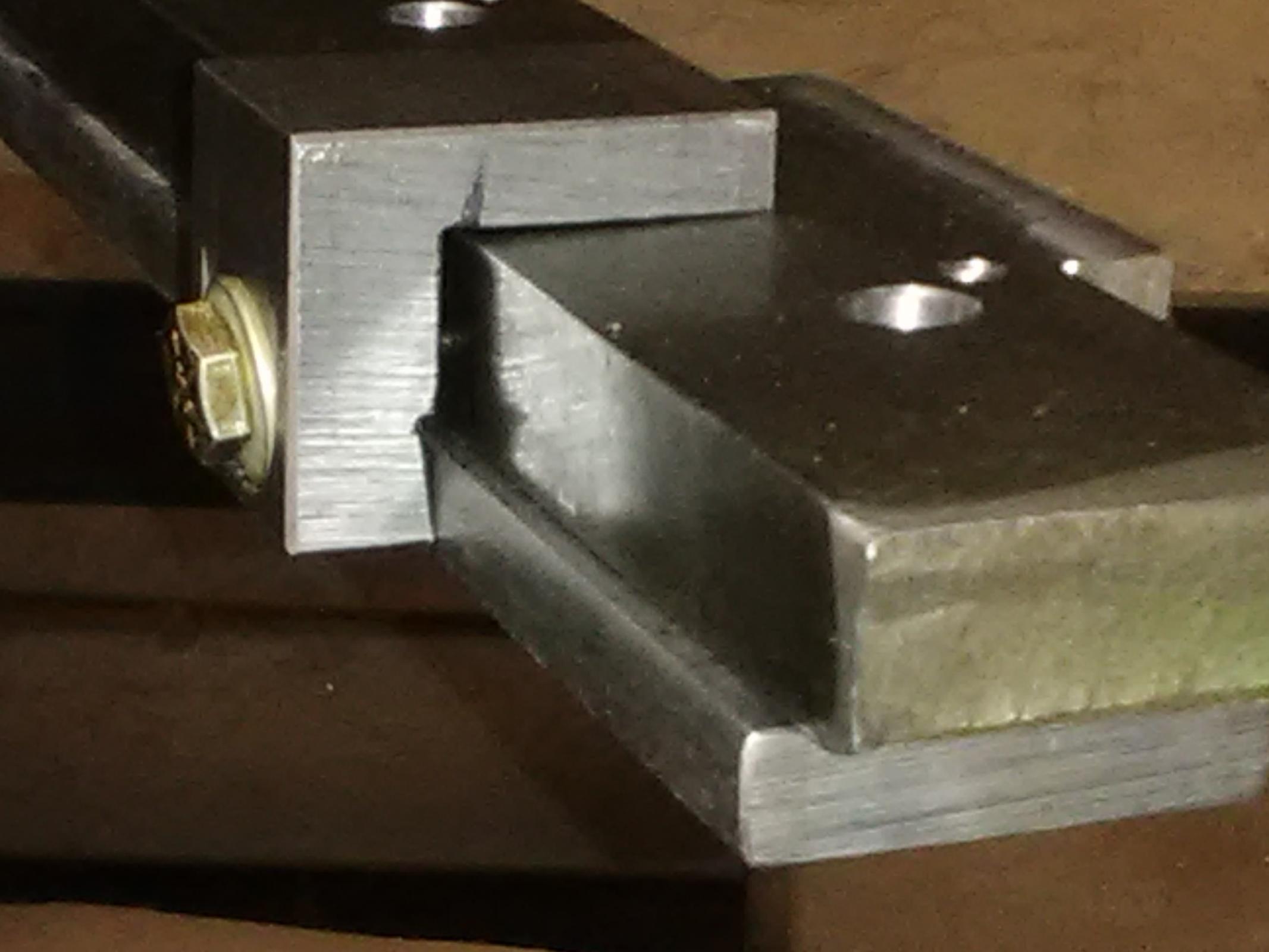

    Clamps also are undercut 7°, with inclined screws. Hot roll has a bulbous edge, the 7° is 85% height of material thickness.
    Tightening the clamps pinches material up to bottom of drill jig. A .203 pin, inserted in a bushing [#7 drill], through a previous hole synchronizes the hole pattern. A small coil spring opens the clamp for repositioning. A 7/16" nutdriver operates the hex screw.
