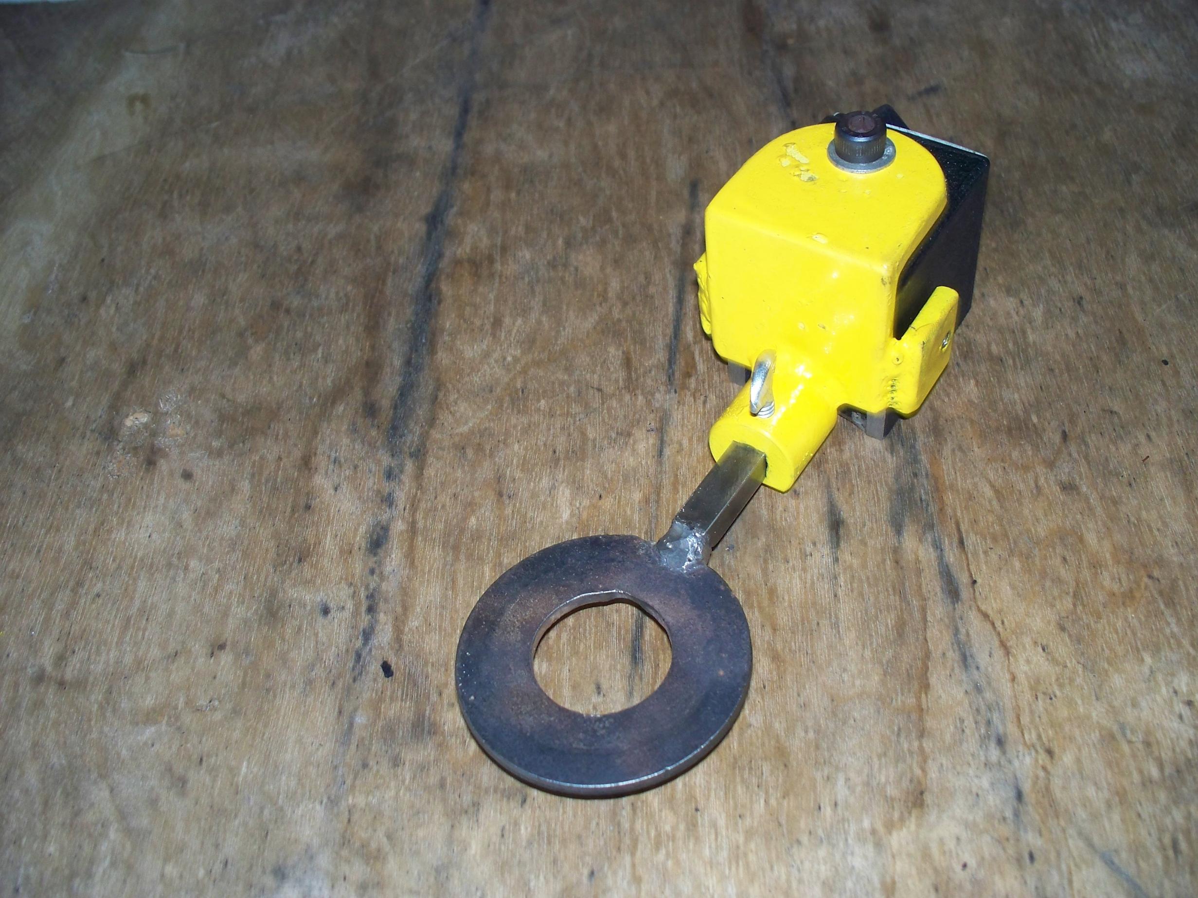

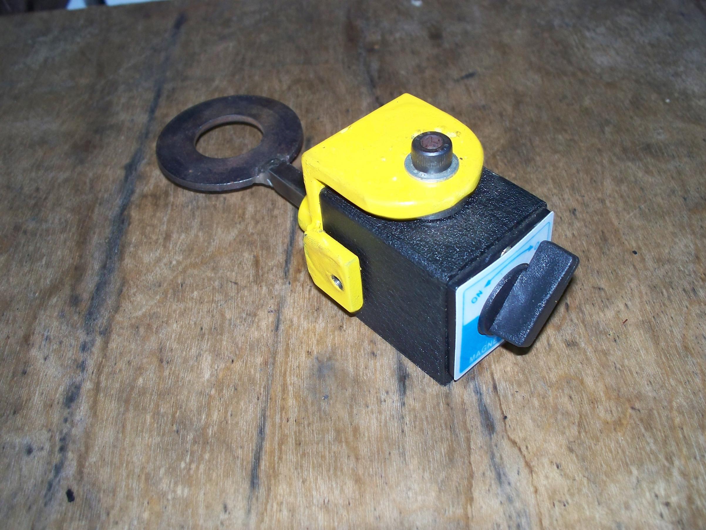

This is a magnet on/off tool I use to hold a variety of cutting patterns. I use a 3/8 square bar welded to the patterns. It works very well on pipe. A real time saver.Attachment 19192Attachment 19193
