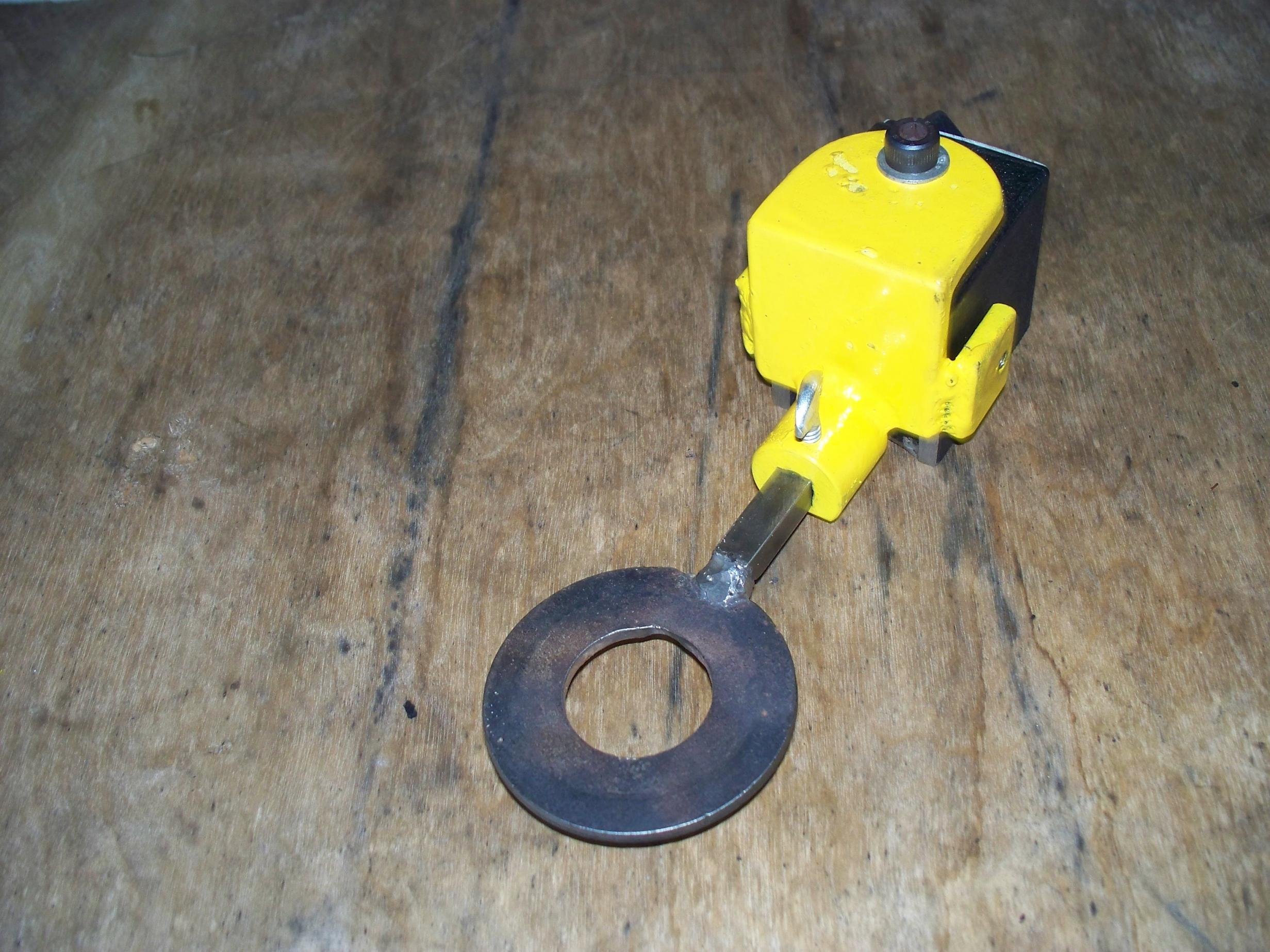

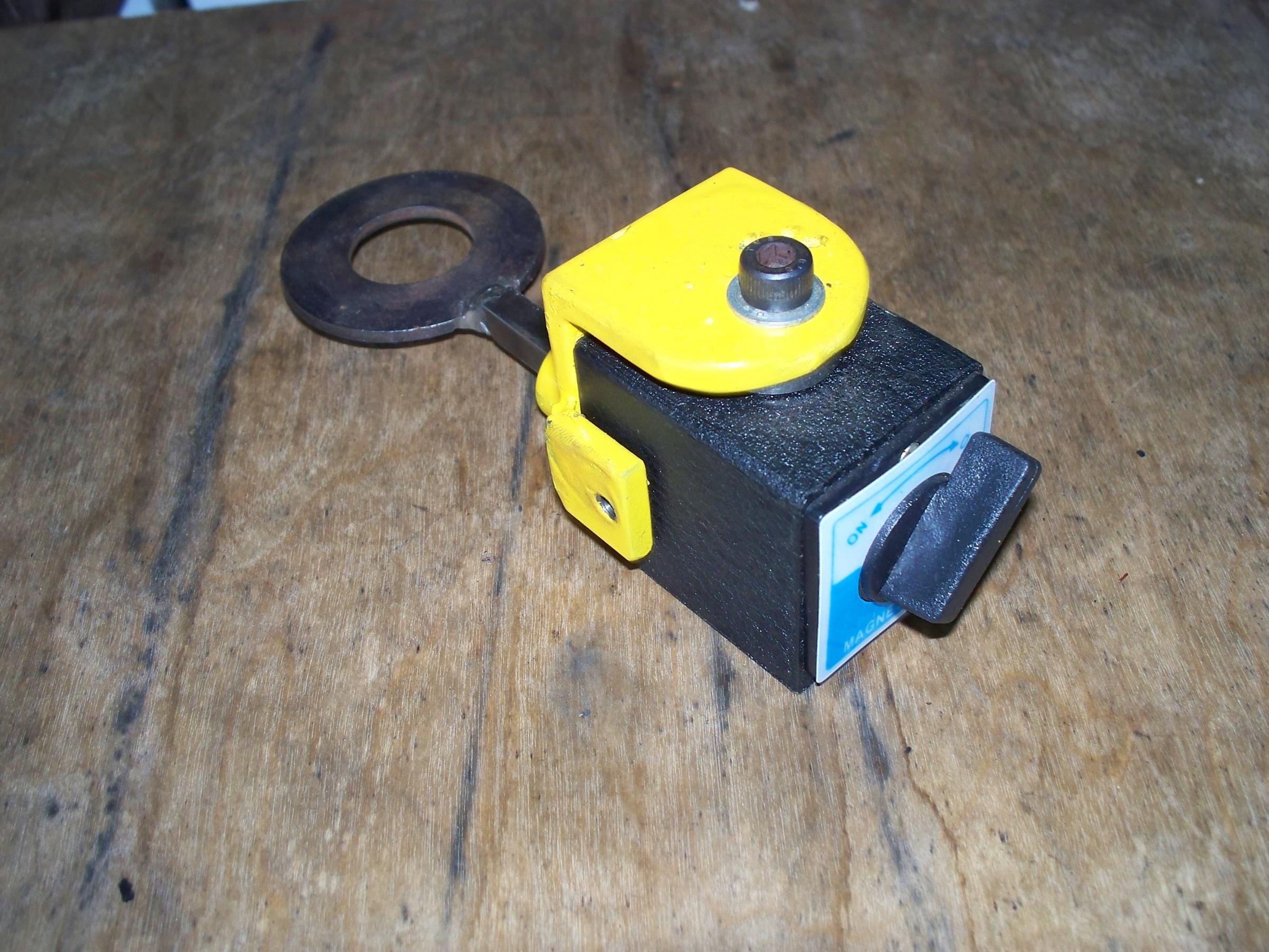

    Lightbulb Magnet on/off tool to hold torch cutting patterns
    This is a magnet on/off tool I use to hold a variety of cutting patterns. I use a 3/8 square bar welded to the patterns. It works very well on pipe. A real time saver.Magnet on/off tool to hold torch cutting patterns-100_1931.jpgMagnet on/off tool to hold torch cutting patterns-100_1932.jpg
