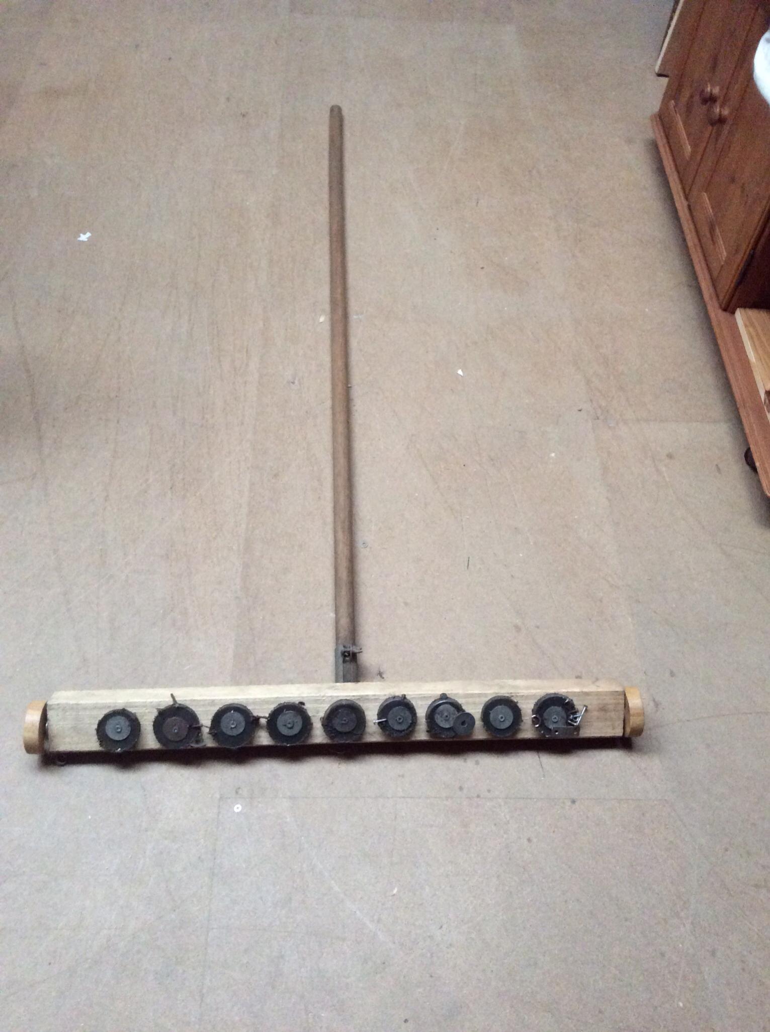

    Magnetic broom
    No bristles, but a series of magnets - Ferrite tori, salvaged from microwave ovens.

    If you're using that in a metalworking shop, you'll need a cover for the magnets so they don't get completely covered with difficult-to-remove ferrous swarf. A piece of plastic pipe slit to snap over the magnet string might do the trick. Snap it off the broom over the trash barrel and all the swarf will drop away leaving the magnets clean.
    Regards, Marv

    Thanks, but it is mainly for outdoors. I have a smaller one for the workshop. I produce a lot of dirt, and drop a lot of bits, but not a lot of swarm!

    When I had my house re-roofed from sawed cedar shingles to a light-weight concrete tile (required fireproof replacement after the house next door burned down in a wildfire), the roofers used a form of magnet broom to gather up all the roofing nails from the cedar shingle tear-off operation. Removing the old cedar shingles dumped a bunch of short nails down on the patios and garden beds near the edges of the house. Similar to your broom design, their magnetic broom pick up 99.9% of the nails and worked very well. Thanks for posting and providing your source of magnets.

    I'm with Marv on this one. Since you are using it outdoors, a lot of dirt will also be caught along with the ferrous materials. Still, it's your call Philip. Way to make use of scrap materials.
