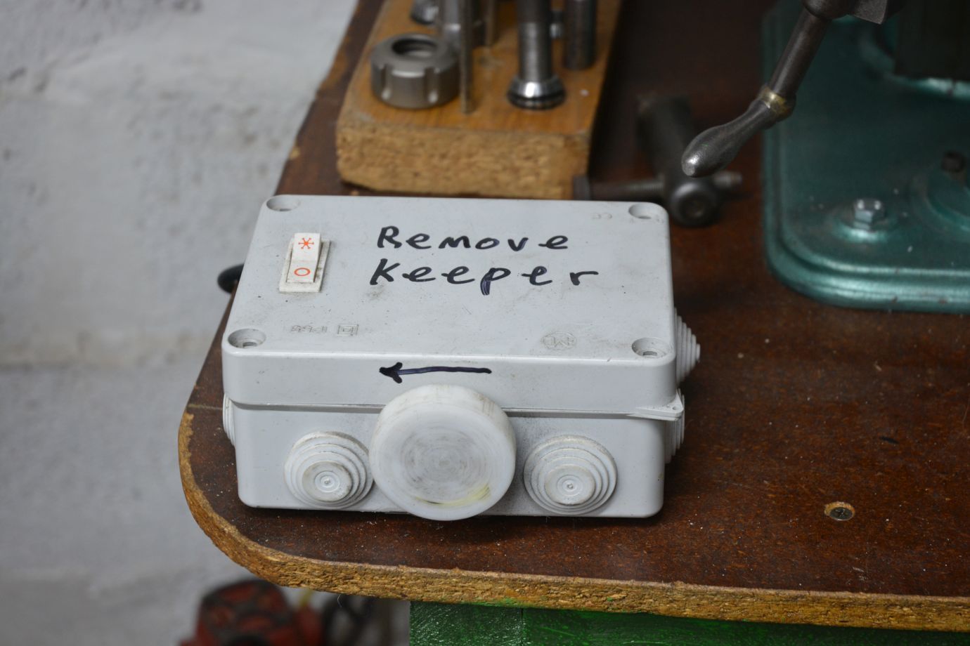

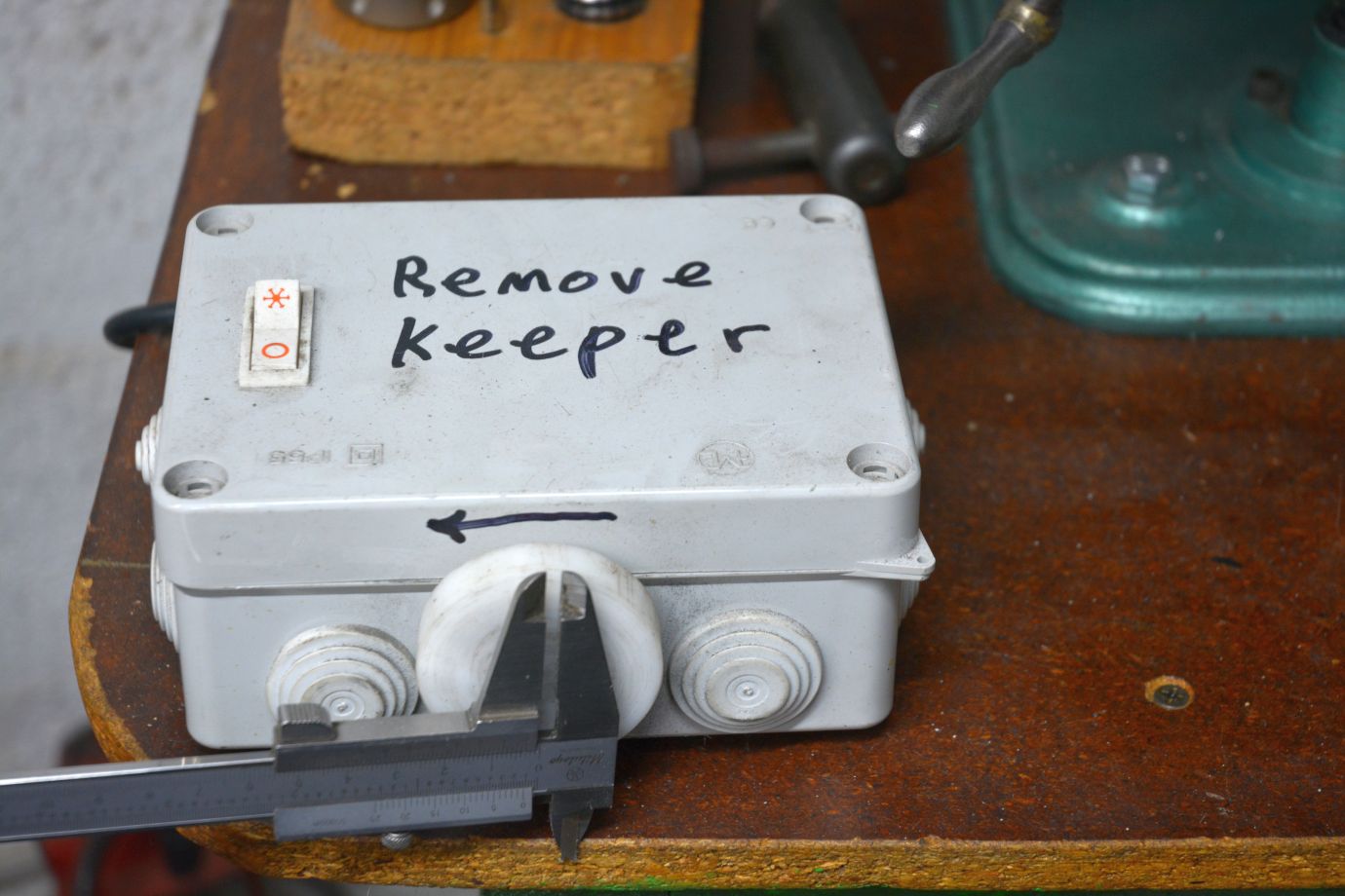

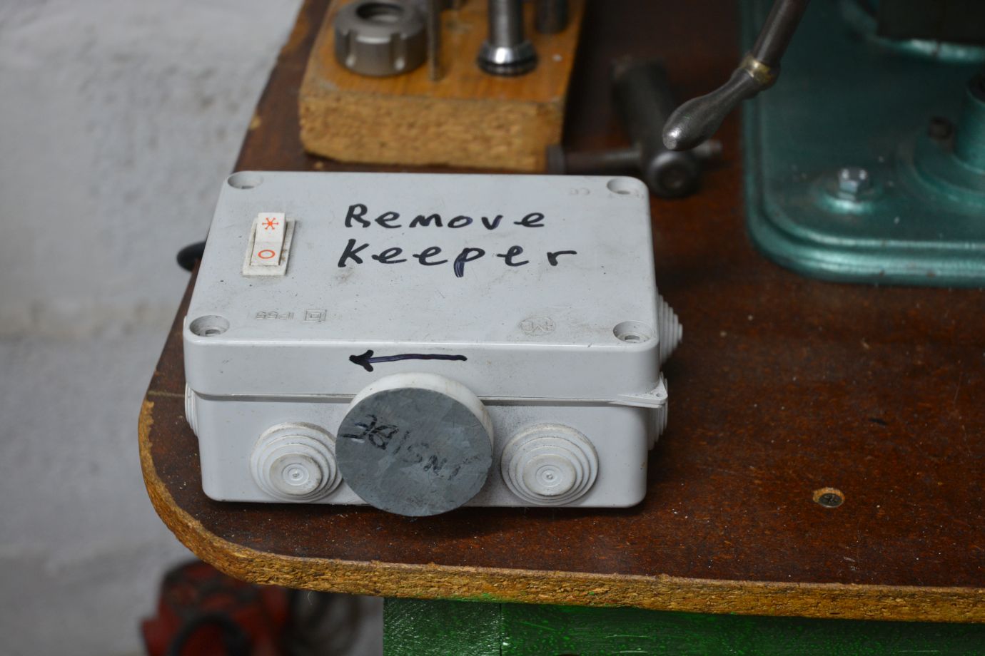

Since making the original post I made a standalone device using the original rotor. I fitted it to a scrap washing machine pump motor, added a switch and encased most of it in a plastic junction box. It sits permanently on the end of a bench ready for immediate use, eliminating the inevitable search for the mislaid rotor and then fitting to a drill. The extra convenience means that it gets used quite regularly rather than continuing to work with a magnetised tool.
Attachment 42812 Attachment 42813 Click for full size.
I just have to remove the keeper, switch on and it is ready to go.

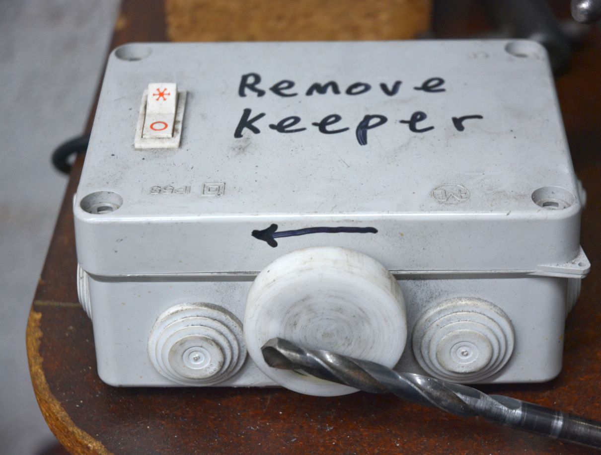

Attachment 42814 Attachment 42815
A couple of typical thingies to demagnetise.
BTW. The keeper is there to prevent the magnets attracting magnetic junk when not in use. That is 100% effective.
