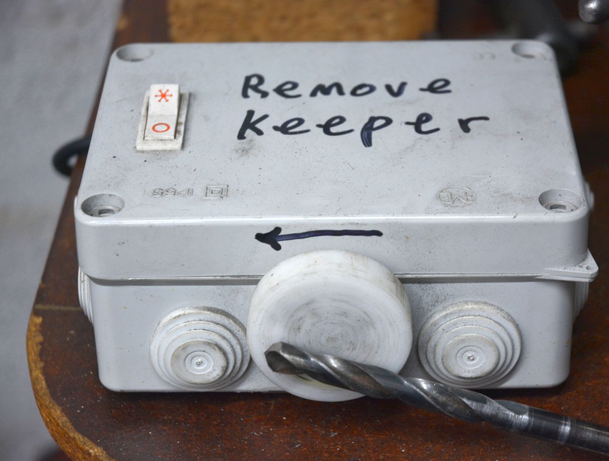

    Here is the finished device shown working.

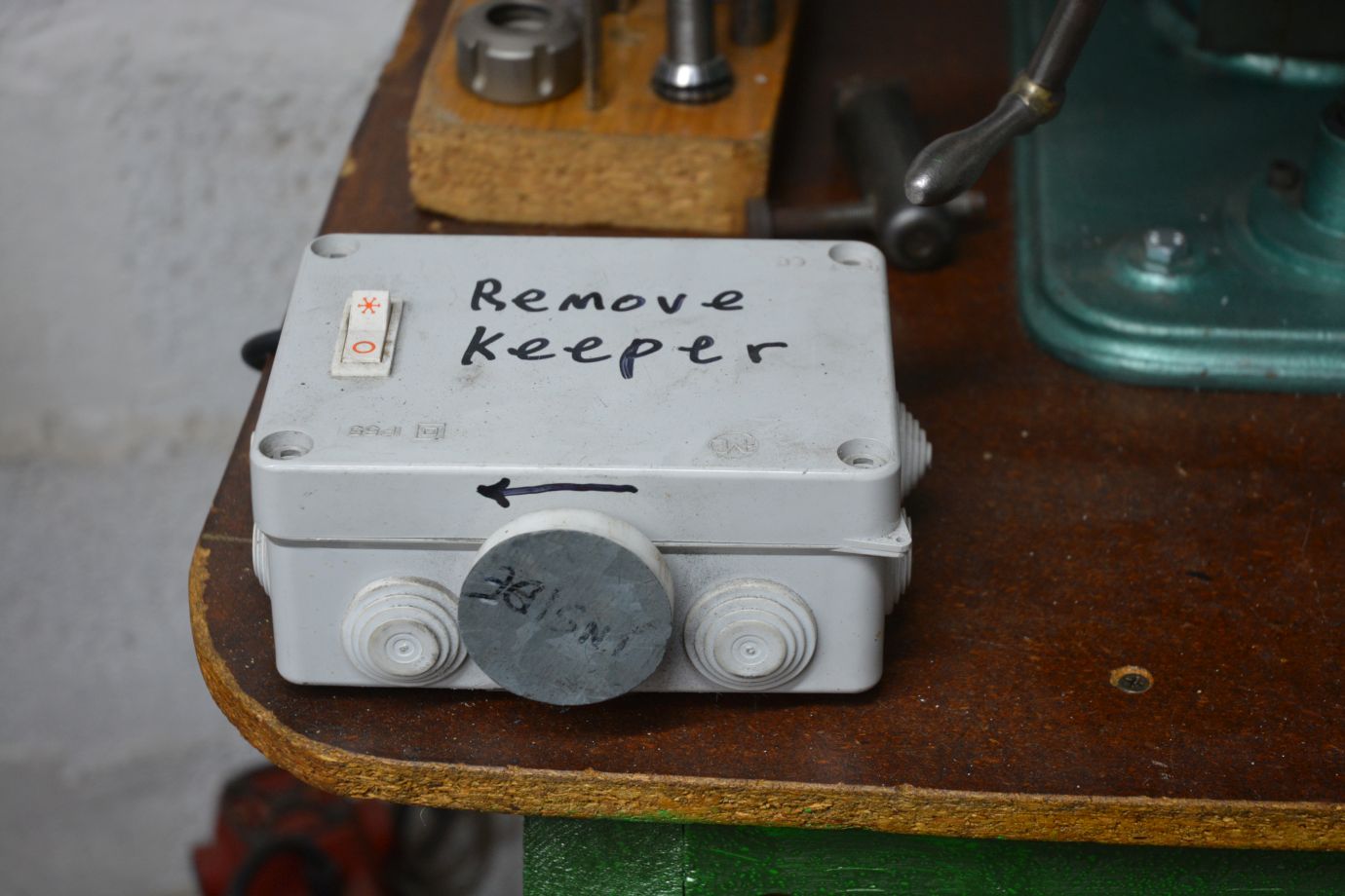

    PS. Since I took the photos I cut out a 1 mm thick steel circle to use as a keeper for the demagnetiser which completely kills any tendency to collect ferrous swarf

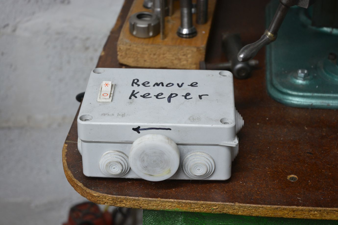

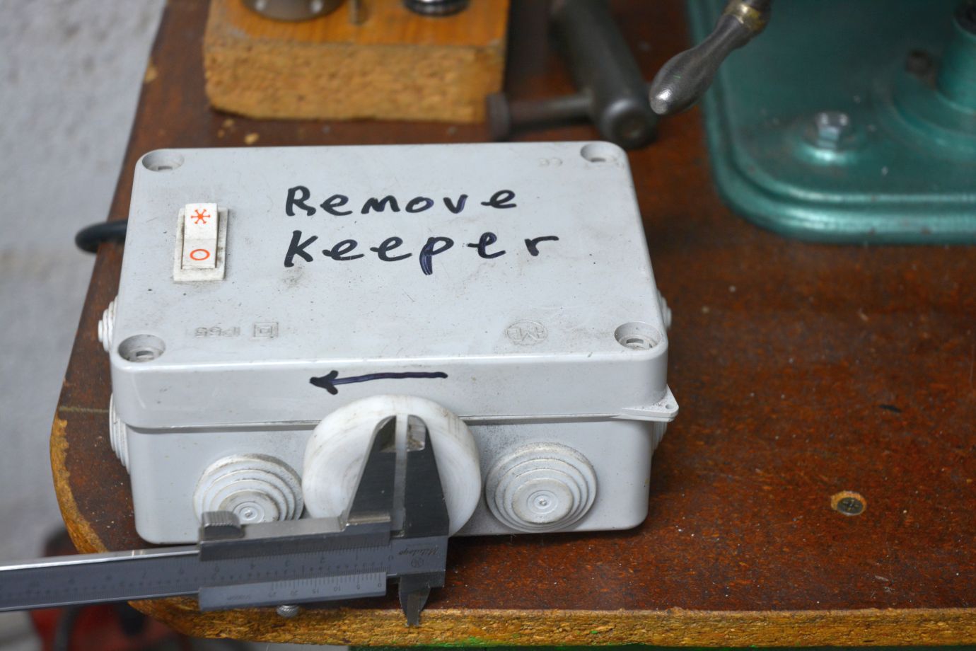

    Here are pix of the keeper for the demagnetiser.
    Magnetising and demagnetising tools.-demag-09.jpg Magnetising and demagnetising tools.-demag-10.jpg

    Quote Originally Posted by Peter Sanders View Post
    Hi Tony
    A magnet keeper spans both poles. In effect the screwdriver in the image shown is a keeper. A plate on each end of the magnet (not reaching the opposite pole) does not act as a keeper. The keeper shown in the demagnetiser does work as a keeper, as it connects the magnetic poles.
    Peter,
    You are quite correct. I called the end pieces keepers because that is what they were, they came with a bunch of magnets arranged in two columns and these end pieces bridged the two. I knew that keeper was not the right name in the context in which I used it but it was easy.
    When you state, "I just put it on the tool", do you mean to magnetise the tool, or to utilise the magnetism in the magnet (via the attached tool) JUST while the magnet is attached? I presume the former.
    I put it on the tool just to magnetise it, and removed it before using the tool.
    The method of stroking the magnet along a tool such a screwdriver, is to align the grain structure of the metal being magnetised. I don't see how just placing the magnet on the tool does this same structural alignment (except of course while the magnet remains attached).
    Stoking was a common technique when commonly available magnets were not very strong. Any field will do some alignment depending of the field strength.
    Removing the magnet may leave a small residual magnetic attraction in the tool, but I doubt it will be as strong as the stroking method.
    Getting the maximum possible residual magnetism in the tool is hardly the idea. Just enough to hold a screw on a driver or Allen key is all that is required. If stroking was necessary then we would not need tool demagnetisers because tools would never get magnetised in general use, but they do.
    If I wanted to maximise the effect I would not be stroking I would use a capacitor dump into a coil around the tool. In any case regardless of the strength of the magnetising field a given tool has a maximum that it will retain.

    Somehow missed mention of useful, effective RPM in vid and text. The speed to withdraw tool is apparent. Does the effect increase with more revolutions?
    Good question and one that I asked myself. I have no idea of the answer though. I have used it in a lathe running at 500 rpm and in a drill press running at around 3000 rpm. Both seemed to work equally well, as it did when I withdrew as fast as possible (maybe around 0.5 sec) and when I took several seconds for the withdrawal.
    Withdrawing laterally worked and so did withdrawing axially.
    I use magnetic bars to hold some tools and that is probably the reason that some screw drivers get magnetised but I do not know how drill bits get magnetised but some do.
