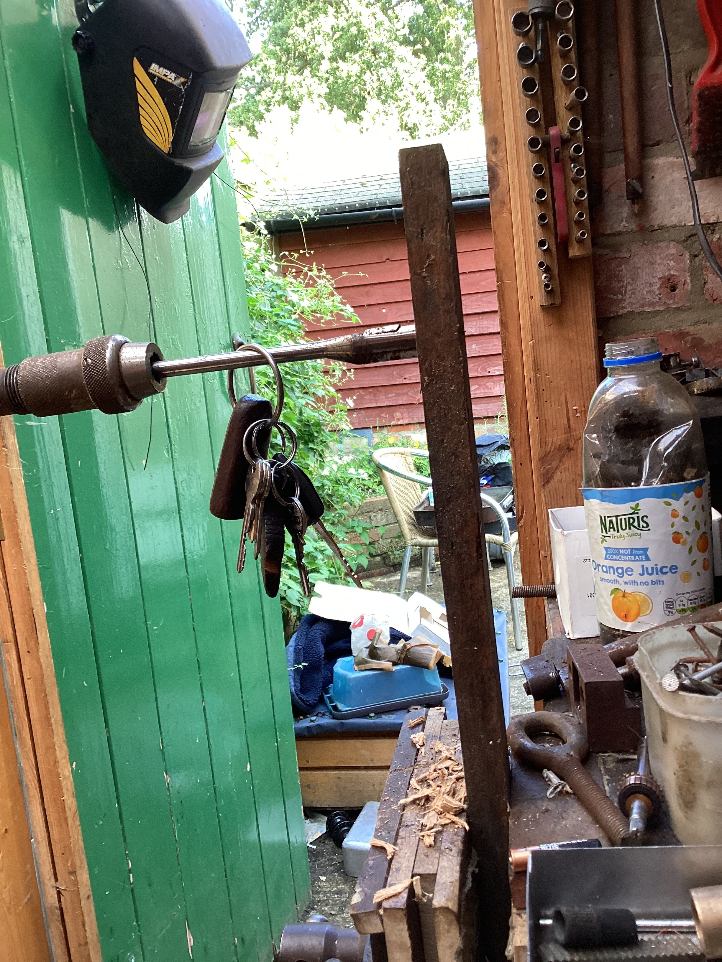

I do however have an adjustable wood boring auger:
Attachment 45946
I hope you appreciate that the wood is plumb in the vice, it’s just my posture. You can tell by the door jamb, which is plumb, or it was.
Why are my keys on the auger? This is a tip I learned at college, thanks, Danny. If the keys go away or towards you as you drill, then you’re not square. The other planes you must judge by eye. Well, this is just a tip. The bore, as expected, is not at all satisfactory, far worse than an Forstner bit, although it might do if I just wanted to run a tube through it.

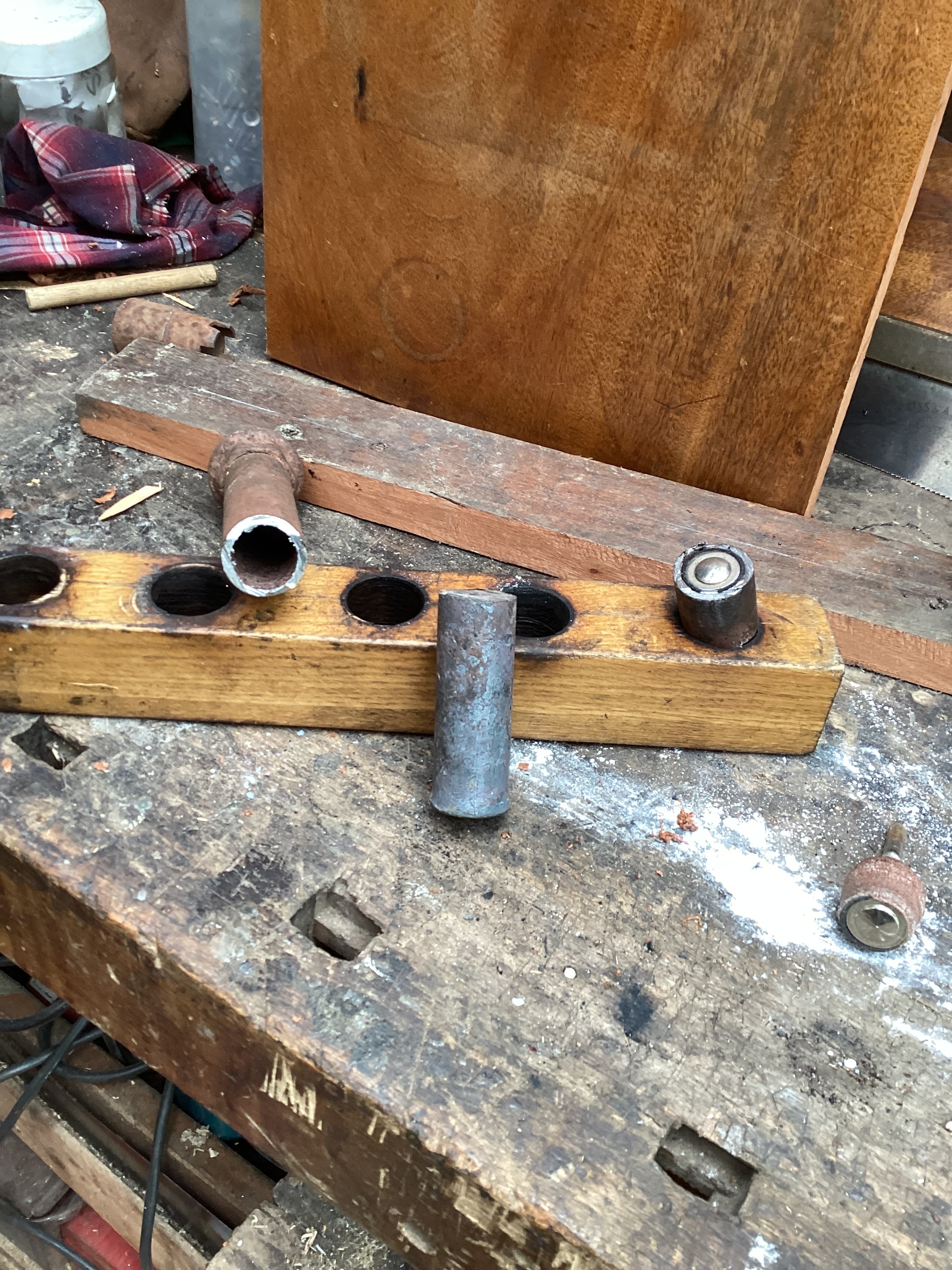

I also have a short piece of round bar, 25.35 at the largest diameter.
This I heated red hot, and taking it outside, pushed it though each of the holes, from each side. (2 heats).
This is the result, the steel, now cold, in the centre.
Attachment 45947
The holes taper towards the middle. Now I need to remove the taper and any excess material.

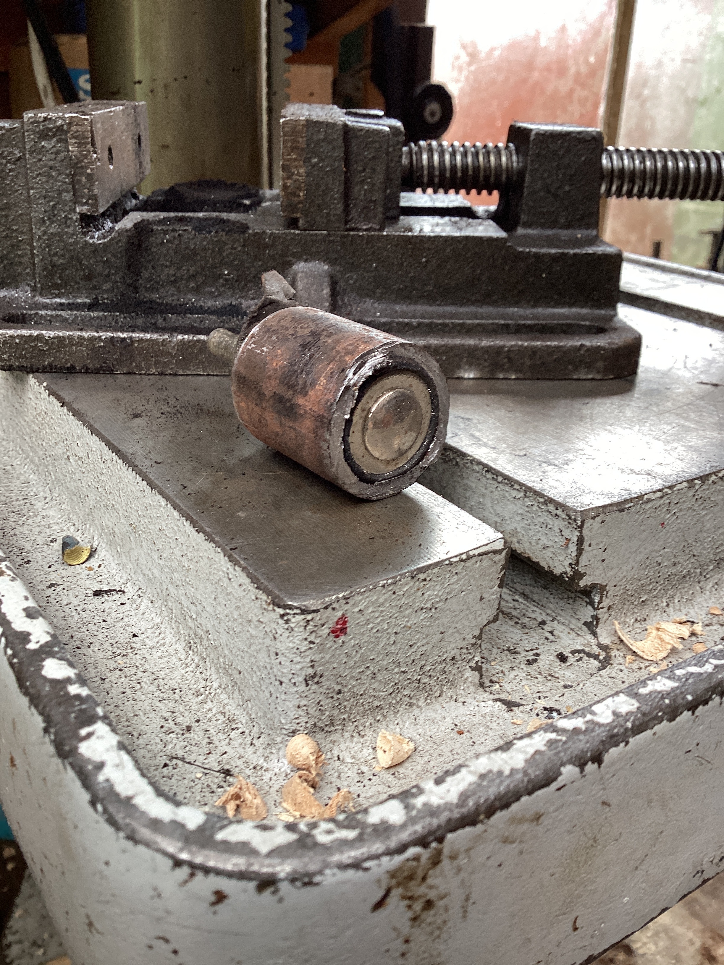

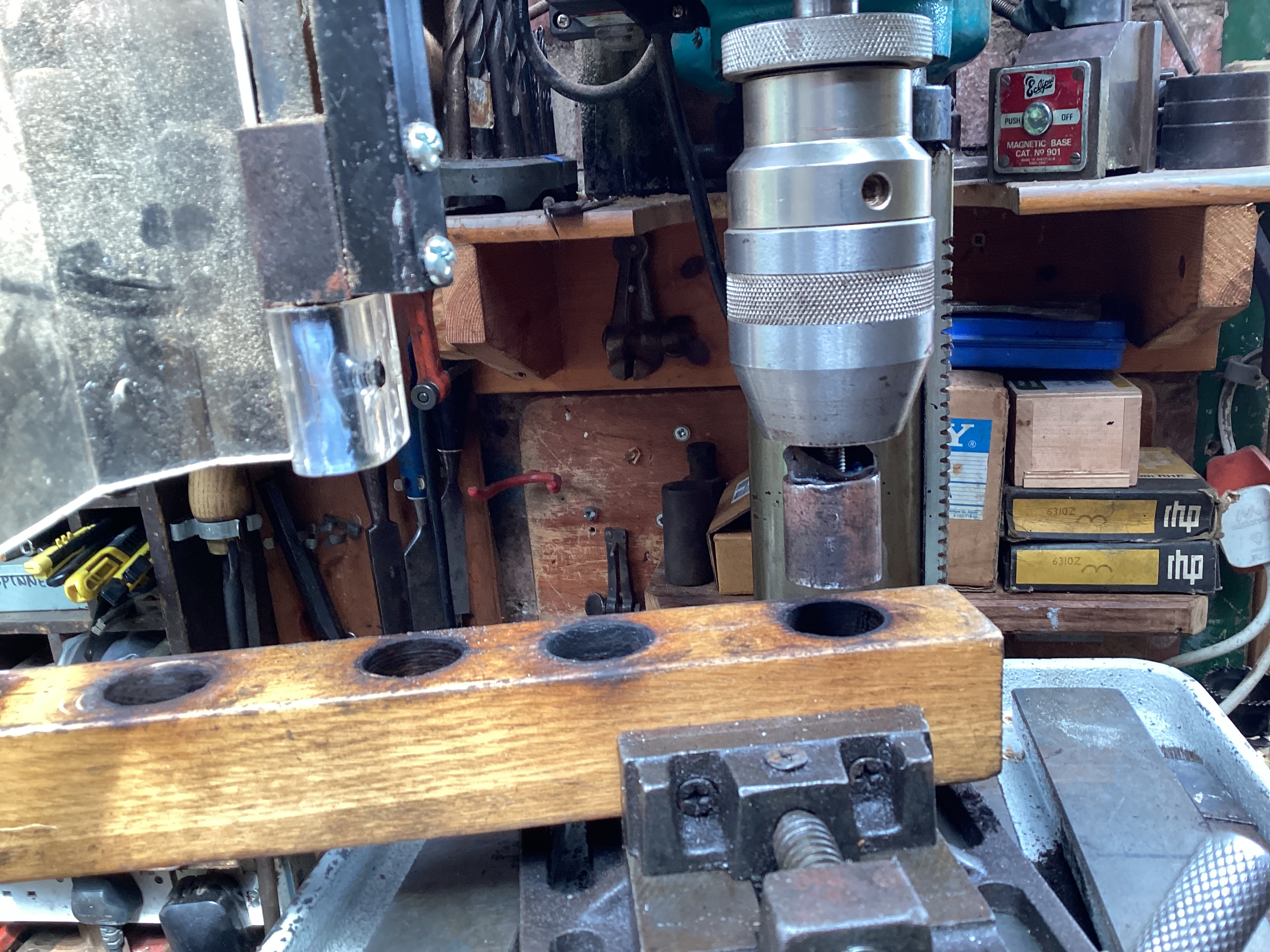

The tube on the left is just under 27 mm. On the right you see an ordinary sanding spindle, 20 mm dia. I have wrapped a bit of tape around the rubber sleeve, pushed it into the tube and tightened the nut on the arbor. Then I cut through the steel tube leaving a slight excess. This is the lap which I then abraded, with it in the drill chuck and the motor running.
I ran it until I was happy with the diameter, then passed it through the holes, with very little resistance.
