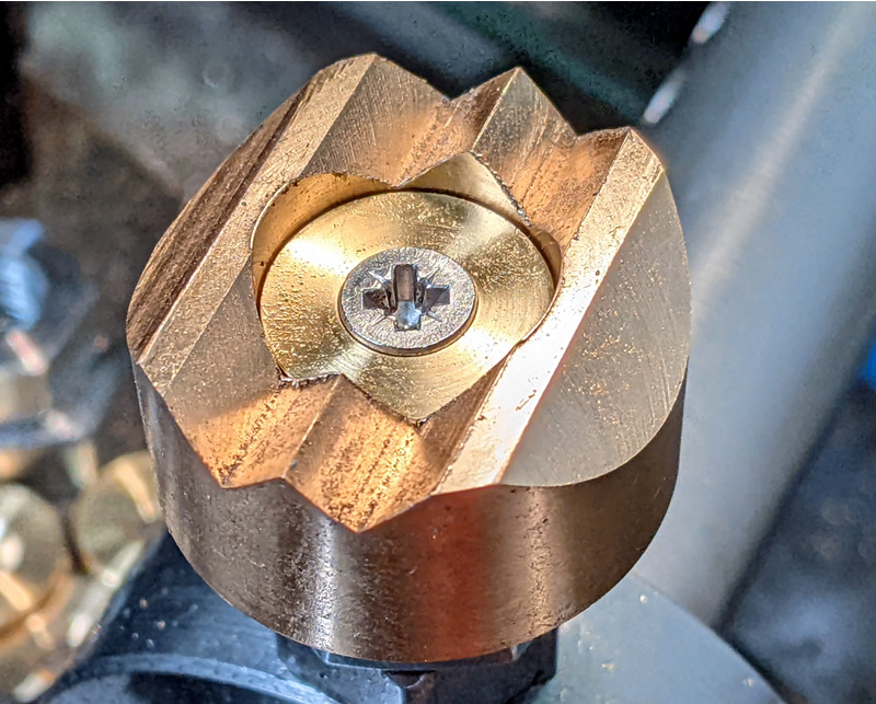

I needed to make retention washers to prevent the jaws of the tube spider mandrel from falling off. Short video about making the washers and machining then to a precise thickness using superglue and a propane torch on the remaining stock in the chuck.
Attachment 41481
