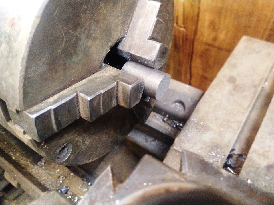

For a project I am working on I don't need precision ground and hardened bolts but I do need a shoulder.
There are a few ways to accomplish this 1 would be to start from scratch with a piece of hex stock then machine out the bolt as required.
Another way would be to slide a length of tubing over the bolt which in my case would have worked just fine, but I opted for a third way

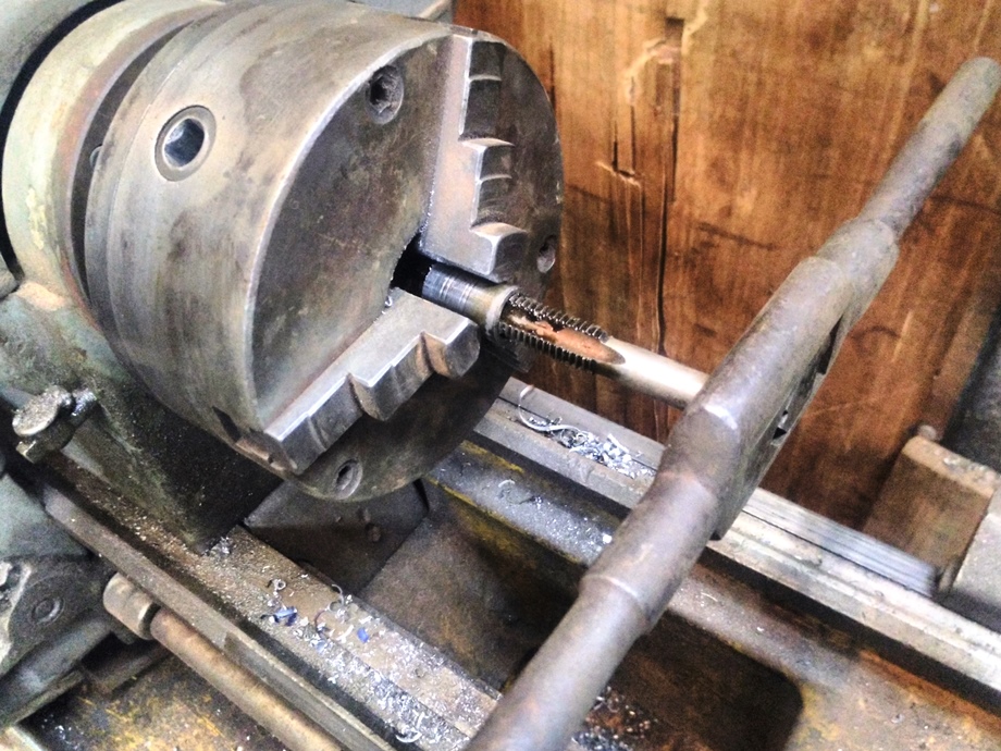

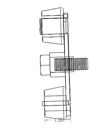

By drill and taping a piece of round stock turning to desired length then screwing it onto the bolt.
Attachment 40814
Attachment 40815

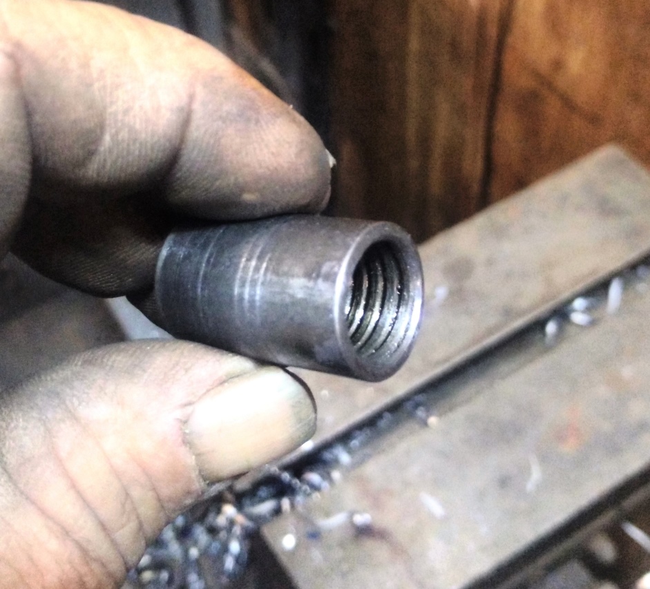

I purposefully drilled 1 size over size to make the taping easier

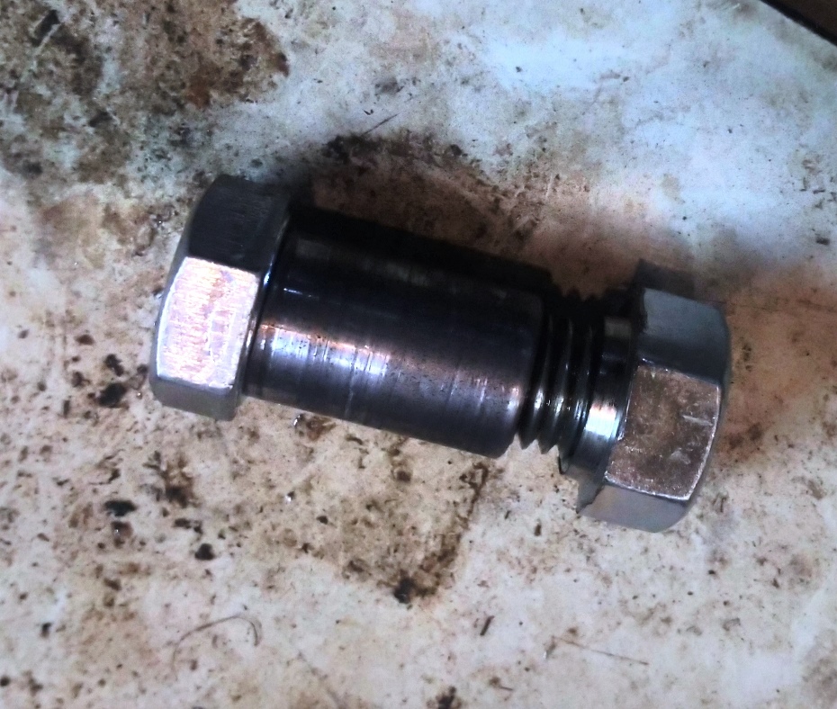

Attachment 40816

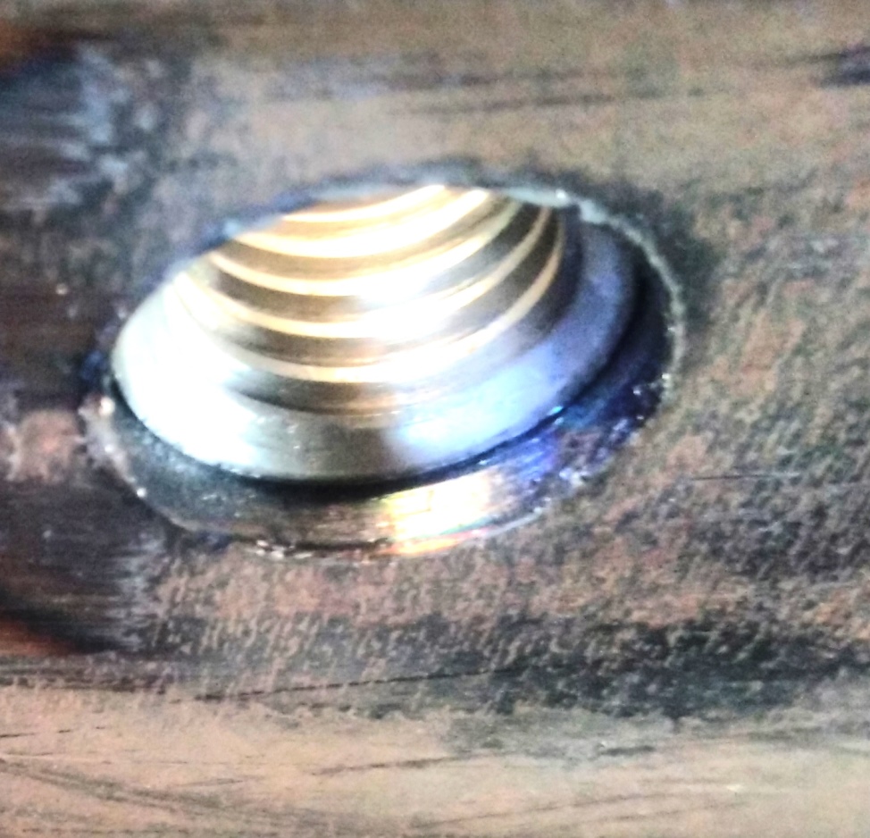

I also turned a step on the nut for locating it in the hole

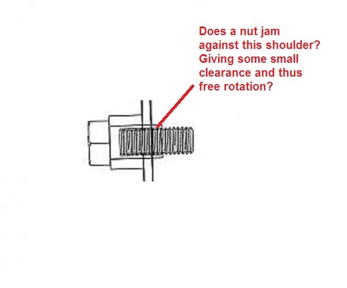

Attachment 40817

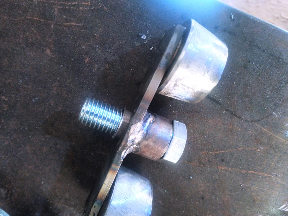

Attachment 40818

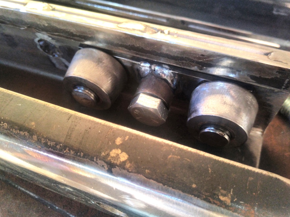

The shoulder on the bolt protrudes beyond the wheel mounting plate to lock against the nut welded into the member
Attachment 40819
the trolley truck is free to rotate about the shoulder
while the shoulder being tightened against the nut and centered to the hole side ways stresses and movement is all but eliminated
