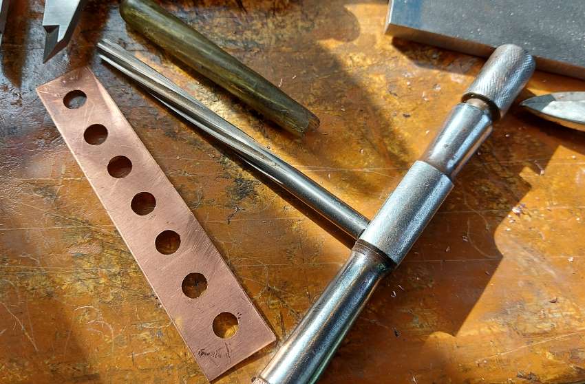

Drill some holes in copper sheet, best to then ream the holes
Attachment 38940

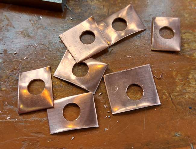

Cut them into pieces
Attachment 38941

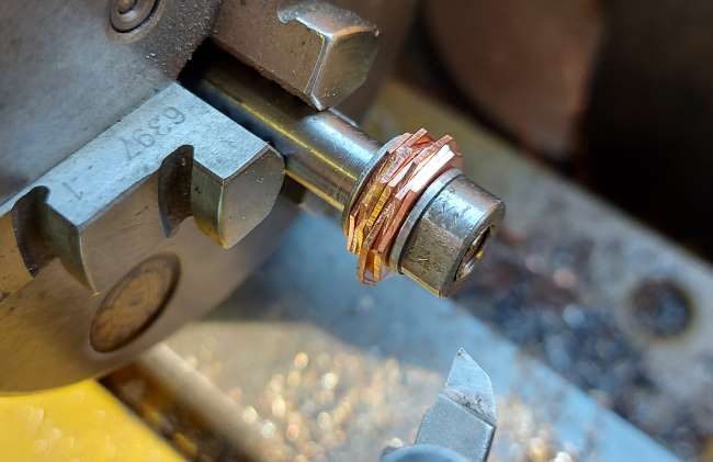

Fit them onto a mandrel in the lathe and clamp them between two washers
Attachment 38942

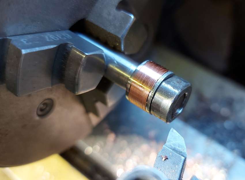

Turn them to size
Attachment 38943

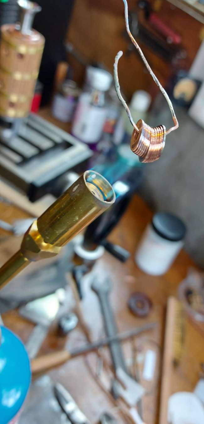

Then you just need to deburr them and finally anneal them. Annealing copper is easy, heat it up to dull red and dump them in water

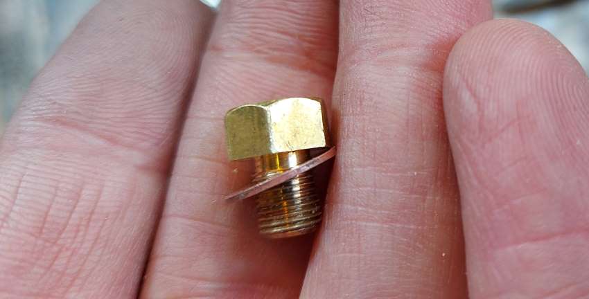

I then have a soft copper washer that will form a great seal on my steam boiler
