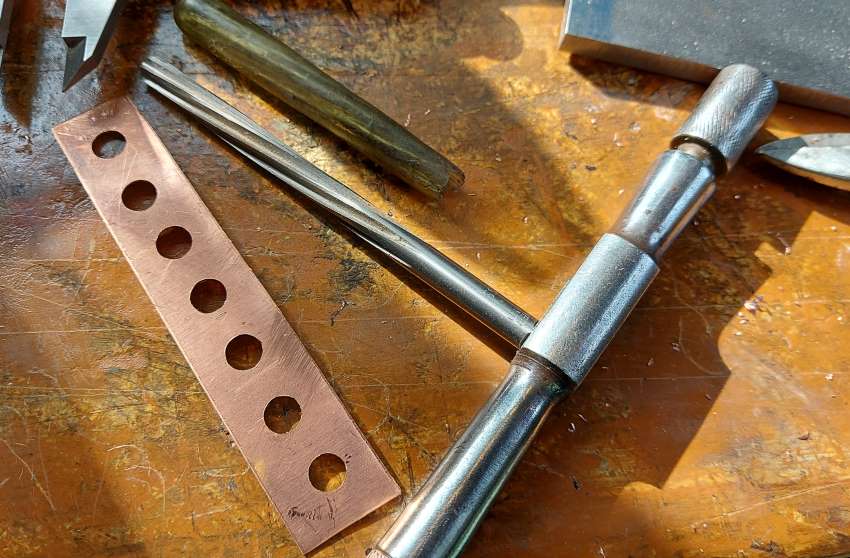

    Drill some holes in copper sheet, best to then ream the holes

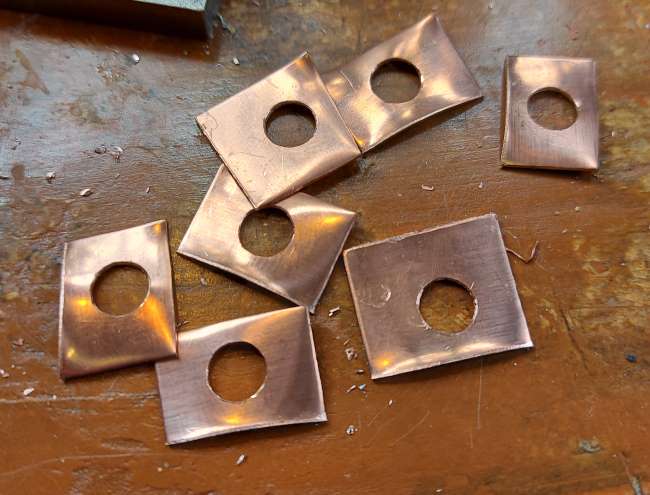

    Cut them into pieces

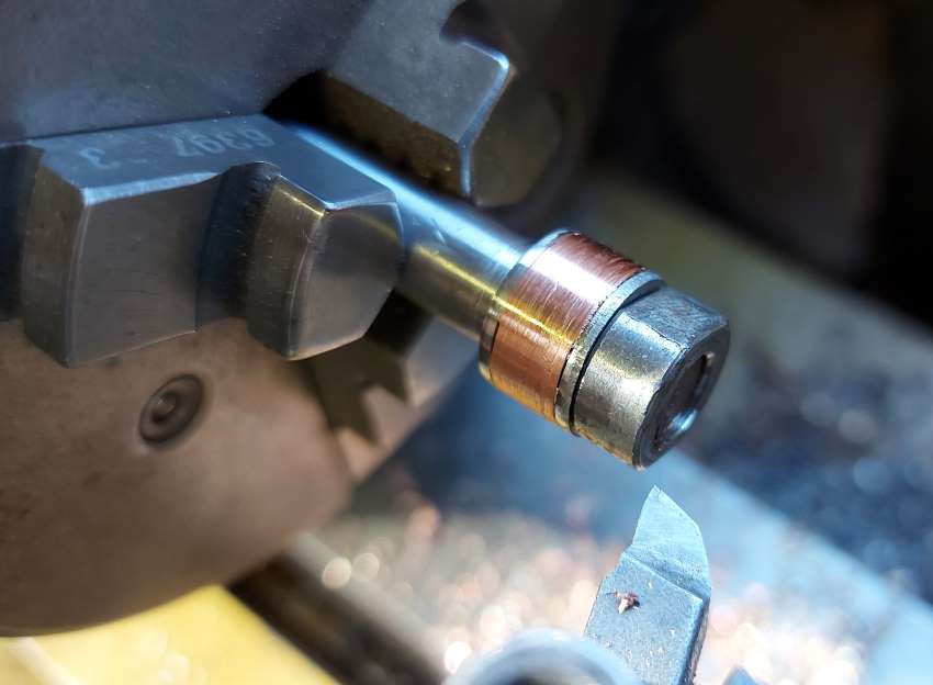

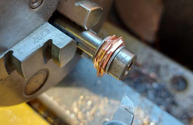

    Fit them onto a mandrel in the lathe and clamp them between two washers
    Turn them to size

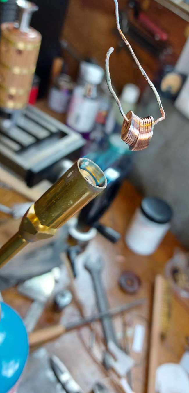

    Then you just need to deburr them and finally anneal them. Annealing copper is easy, heat it up to dull red and dump them in water

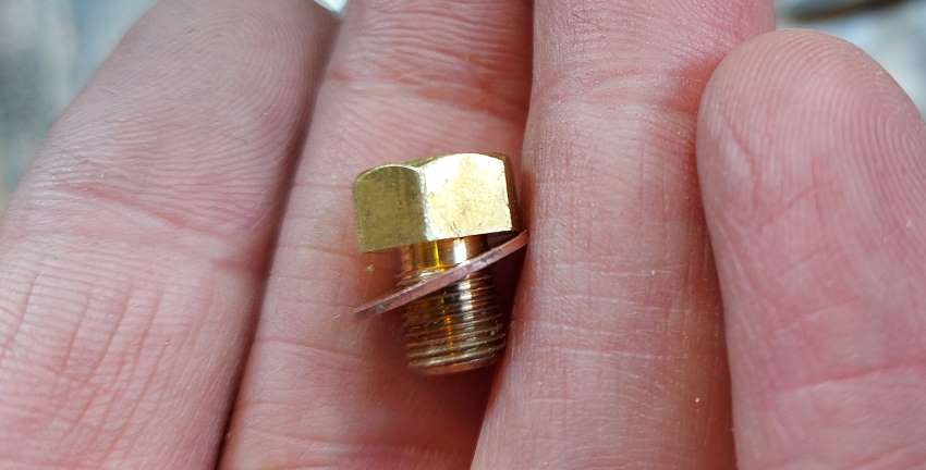

    I then have a soft copper washer that will form a great seal on my steam boiler

    Quote Originally Posted by editor@glue-it.com View Post
    A simple article to take people through my way of making soft copper washers:
    Dumping copper in water after heating to dull red is not necessary, if left to air cool it will suffice.

    Quote Originally Posted by katy View Post
    Hi Katy, agree, air cooling is fine. I dump in water as I'm often in a hurry.....But air cooling afterwards still anneals the copper. Thanks, Nigel

    "Dumping copper in water after heating to dull red is not necessary, if left to air cool it will suffice." True but dropping into cold water has two benefits. 1: It cools down fast ready for immediate use. 2: Most of the Oxides slough off leaving a clean surface.
    If you wanted to make real nice you could soak in White vinegar for a while to brighten.
