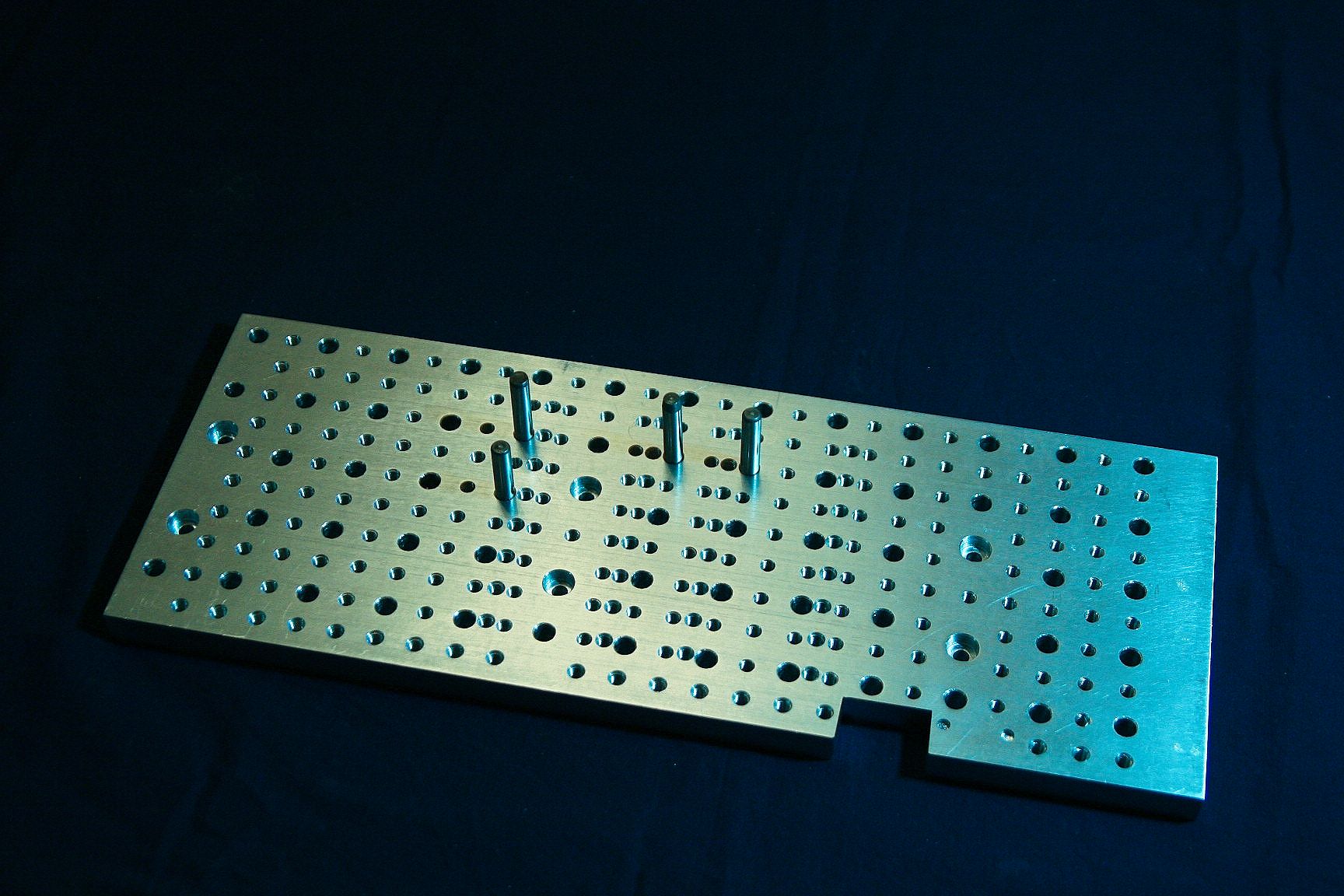

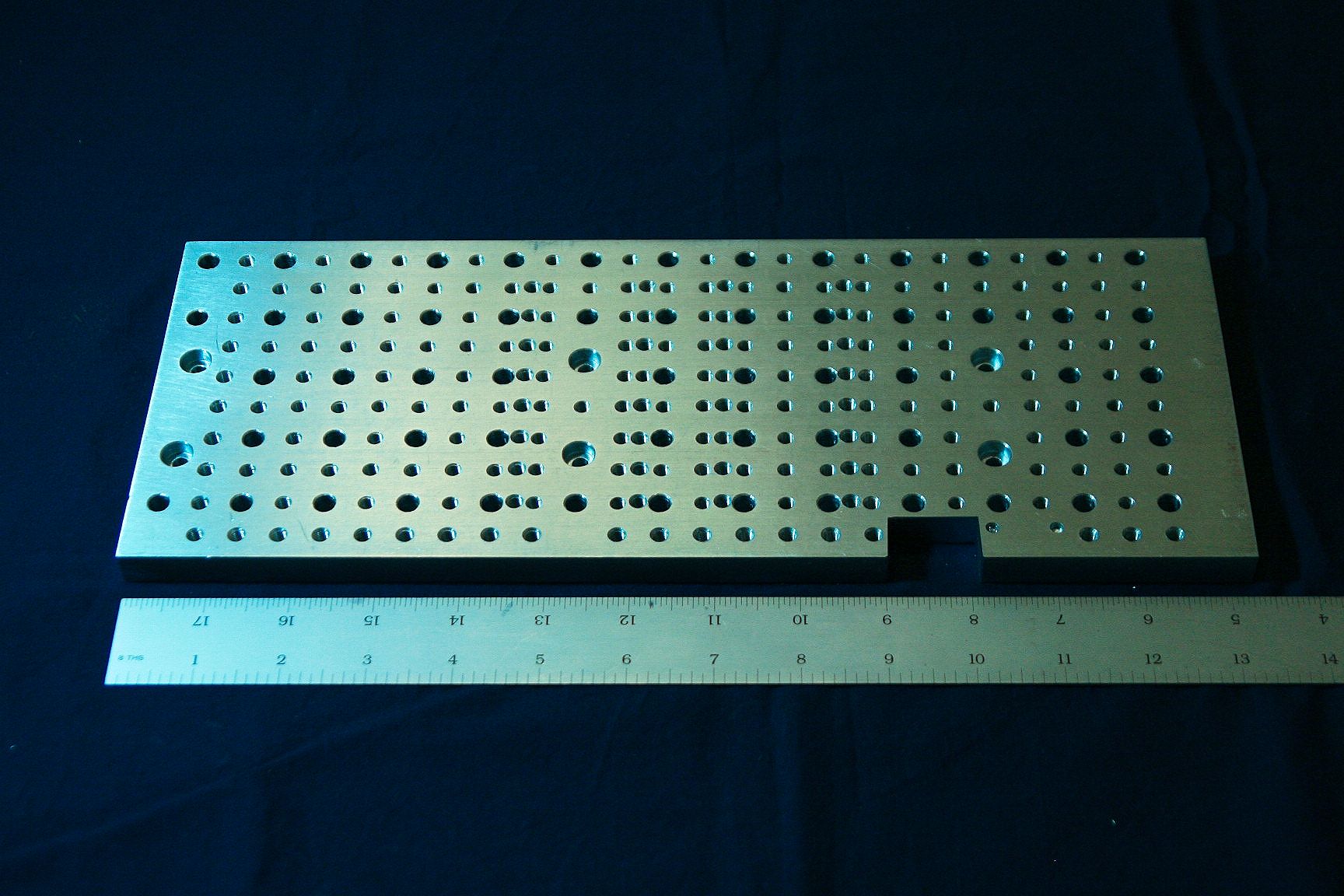

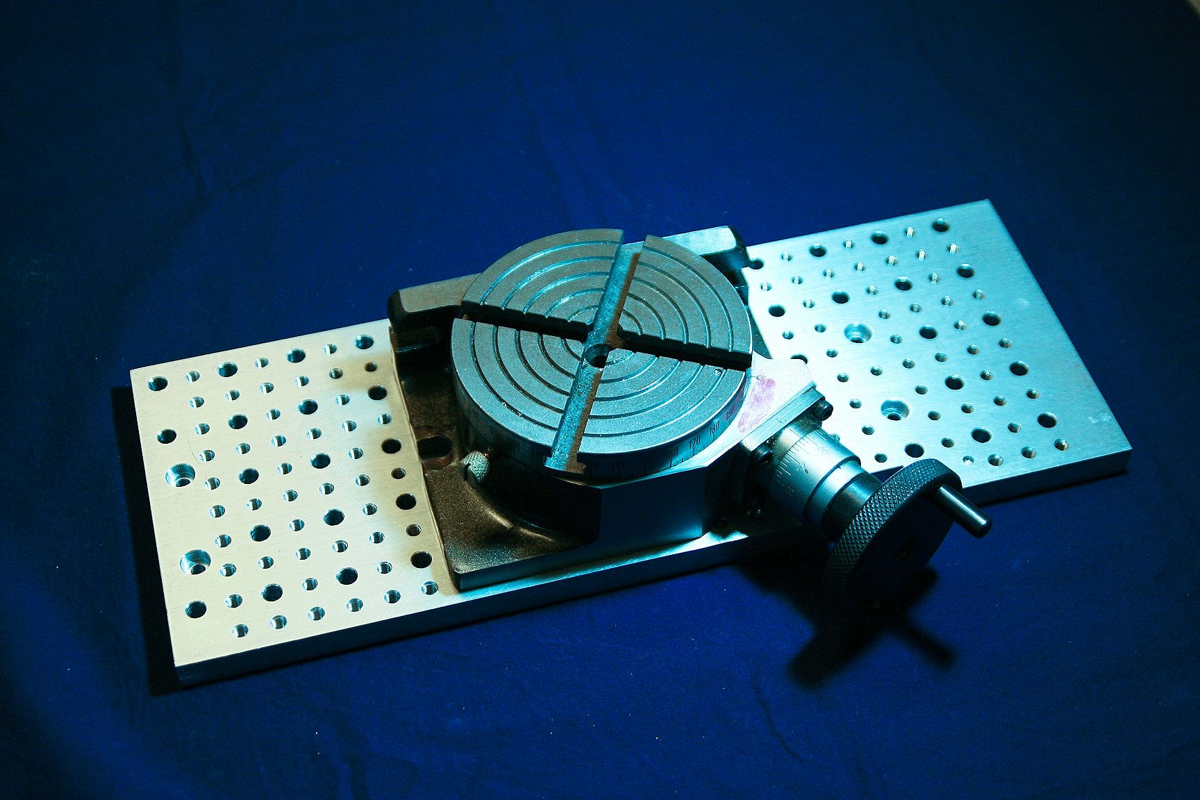

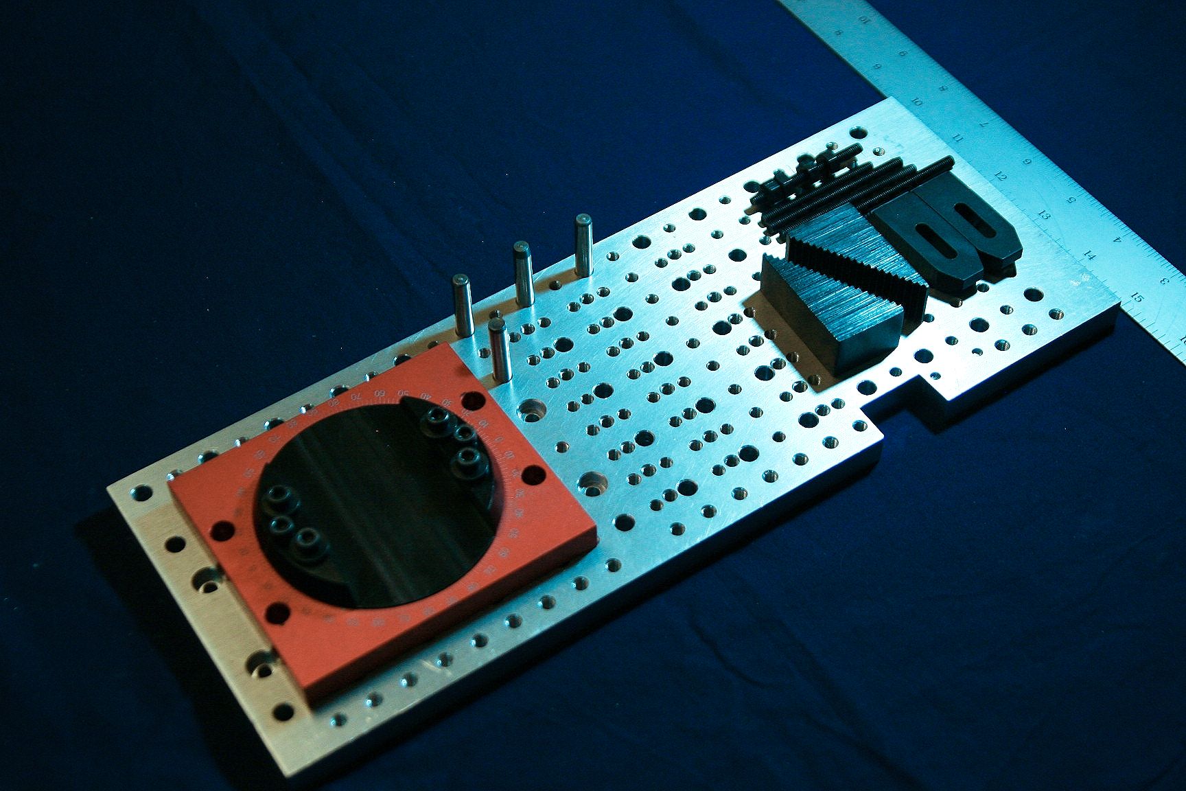

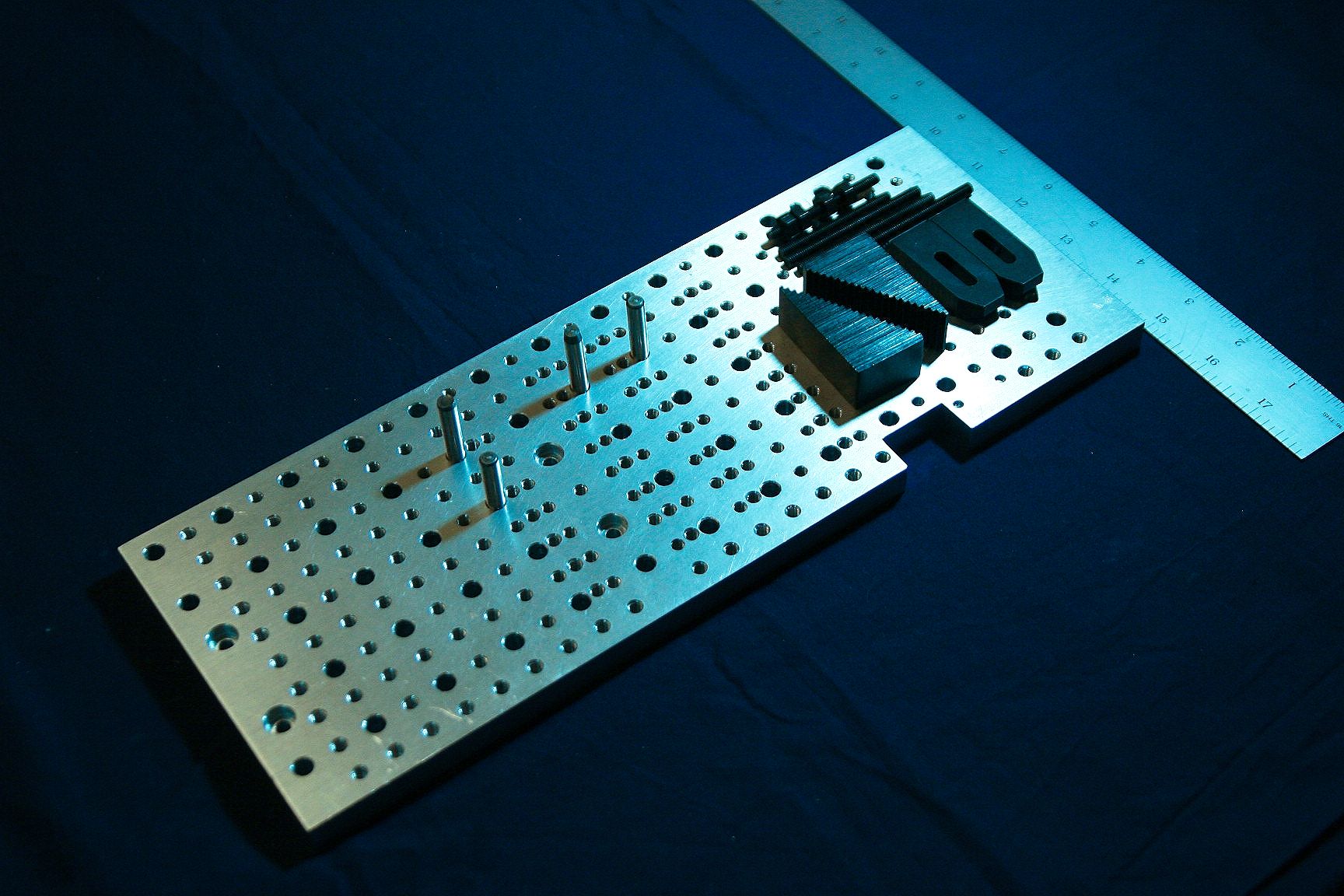

    I already had this little 4" rotary table which is a bit different than the one Sherline sells but I wanted to use it on my 2000 mill.
    Many other clamping needs with other fixtures was also a driving factor. The mill table has two long T-Slots 1.5" on centers.
    Once the pallet was trammed in I wanted to be able to quickly index a flat part that would be clamped using step blocks and strap clamps.
    The .250" dia holes in a 1" square grid are just for the alignment dowels.
    Main features are the .5" hole spacing for most of the 10-32 tapped holes for the clamping of fixtures to the pallet.
    The pallet is .500" thick and 5.125" by 13.250"
    A few fixtures needed some holes with .250" spacing(rotary table and milling vise rotary plate. These can be seen
    in the center section of the pallet. Holes for dowel pins are spaced 1" apart. Handy for quick indexing a part on the pallet.
    Six counter bored .196" holes for 10-32 allen cap screws for holding the pallet to the mill table using it's T-slots.
    Screws are selected to be long enough but also not too long so they touch the mill table, only the T-nuts.
    Small notch in one end is for access to the oil cup for the xy axis. Nice feature that my other mill does not have.
    One more note about tapping so many holes. I used a gun tap so the chips were pushed out the bottom of the holes.
    Works fine but a bit slow when running the tap by hand. So I made up a short set of power tapping tap holders.
    Reduced a days worth of tapping to 2 hours of tapping. These power tap adapters can be used in a portable drill motor
    or the mill or drill press. I found it very fast to use the battery powered drill motor. Saved my shoulders from a lot of hurt!
    Here is a link to the power tap adapters.
    http://www.homemadetools.net/forum/p...567#post107829

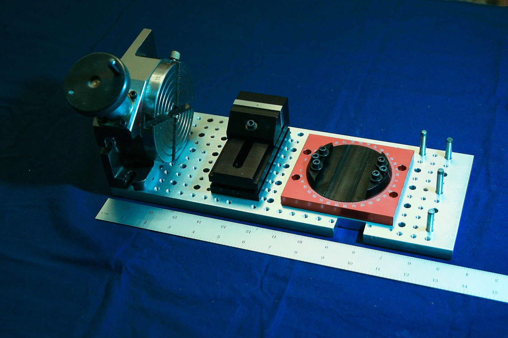

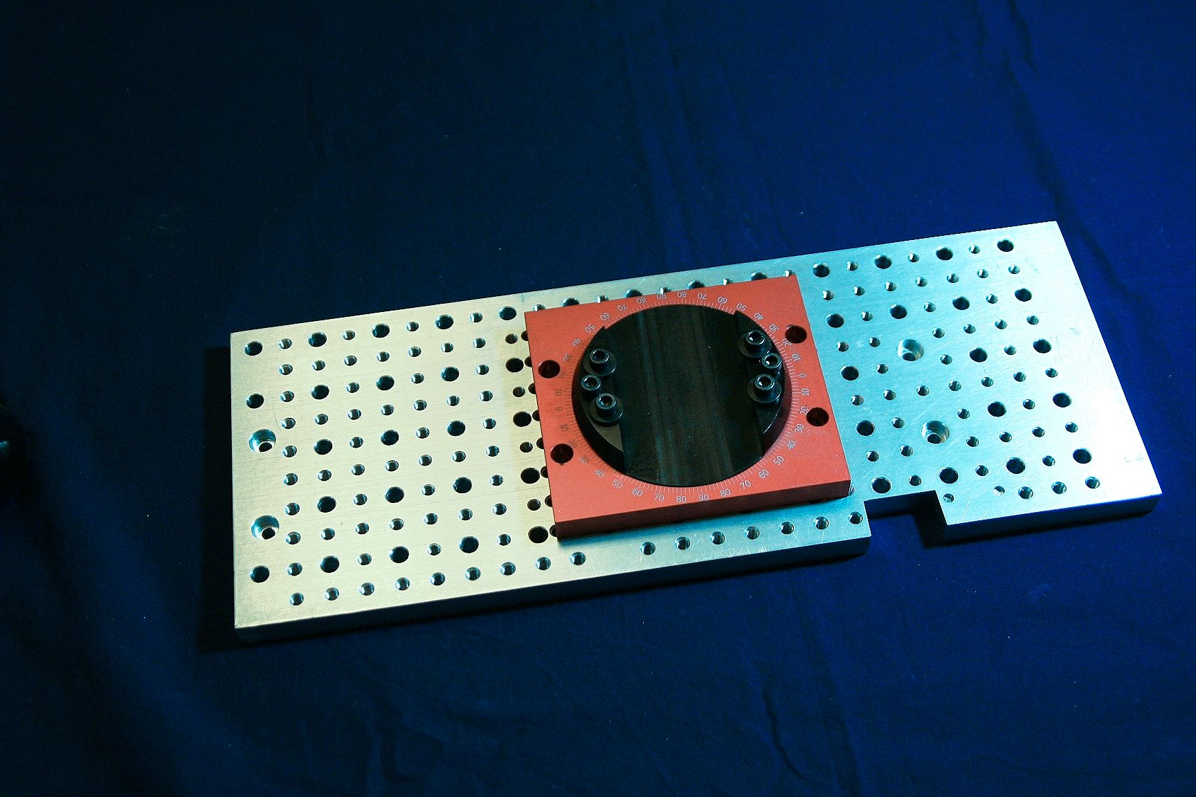

    A few pictures showing some of the fixtures that I will clamp to this pallet.
    See post 10 for a copy of the DXF file.
    Cheers, JR

    Thanks Homeengineer, I do prefer the spiral taps most of the time, they cut with so much less force. However most of mine are standard 3 or 4 flute taps.
    I have used them for "power tapping" but the spirals are soooooo much better.
    Actually spiral tap fits names the tap a lot better than "gun tap". Over on this side of the pond they seem to be called by both names. Why they are called "gun taps" is not known by me but I am sure someone knows!
    Cheers, JR

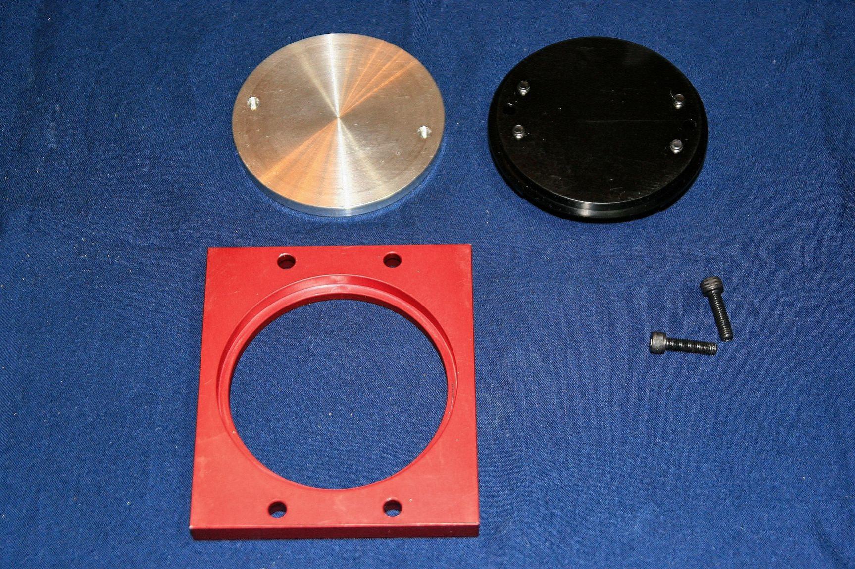

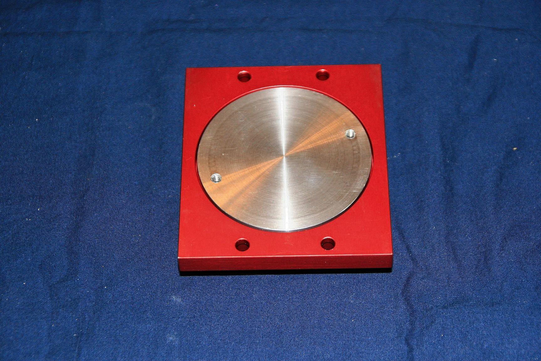

    Really well thought out and executed JR. Nice write up too. Lots of options for sure. Can you please tell us what the small Orange degree clamping piece is? I haven't seen one like that but looks real handy for small non precision jobs and likely a cheerful price. For a possible future project...maybe a tail stock to go with your rotory table...would give you a lot more options if you have the height. Thanks for sharing another fine design and build.

    Sure can PJ;
    Here are two pics showing how it is made and a link to the Sherline product info sheet.
    I bought one in Feburary at a rather high price for what it is however it is quite precise.
    The rotary portion is a very close fit. It was on sale in Feb but even the sale price is a bit high.
    Unlike some of the import stuff this part is finished and complete without any mods.
    I bought one, but will make more and use the design for other tools.
    The principal is the same as the cross slide mount on my mini lathe, but functionally this one works better.
    Does not take much on the two clamp screws to lock it down since there is such a large area for friction between the rotor and base.
    https://sherline.com/Wordpress/wp-co...2/3570inst.pdf
    Cheers, JR
