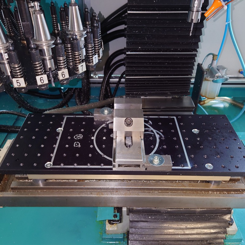

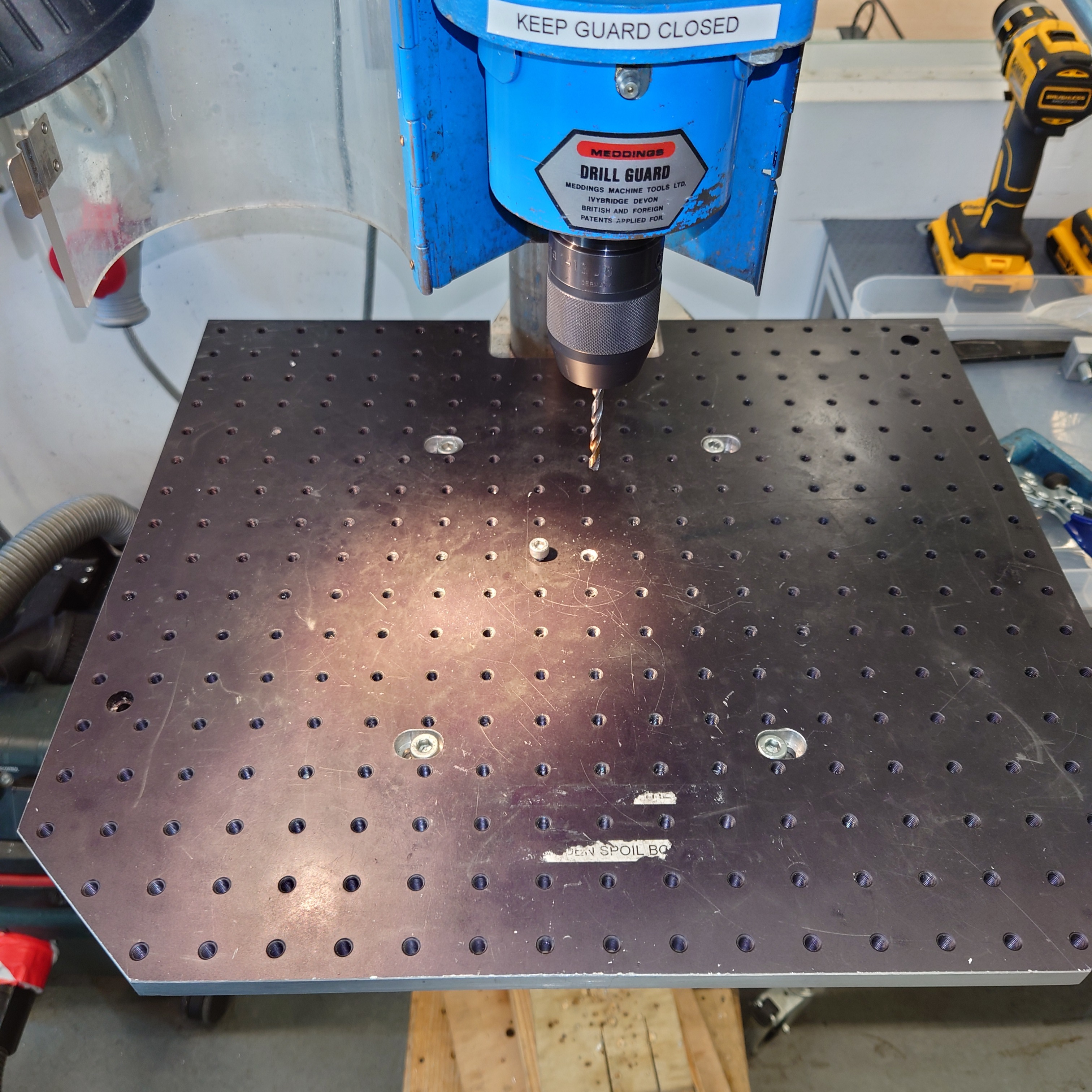

    We use off cuts of optical plates to make ours, and drill table tops Mini Pallet for Sherline 2000 Mill and others-20220224_151205.jpgMini Pallet for Sherline 2000 Mill and others-millpallet.jpg

    Spiral flute taps eject chips in same manner as a drill bit. Not suitable for every material, but within those 'we' use.
    Gun taps eject (shoot) chips forward, also good for general work within one limitation, they don't like bottoming in blind holes. If you are big on cleaning out tapped holes, those are more difficult to pick out as well. They haven't any relation to firearms work.
    They work fine on holes with a bit of extra drilled depth, and ideal for through holes.

    I recently acquired a Sherline 2000 18" version mill out of an estate. Mine doens't have the tool pallet, so I read your entry with great interest. I anticipate wanting/needing the tool pallet for securing tools and work to the machine.
    Questions, if you'd be so kind:
    Did you purchase the pallet blank as raw 1/2" stock & machine it flat yourself (fly cutter or face mill?), or was it flat enough as acquired, or possibly purchased it as a machined flat piece?
    I've seen other, similar tooling plates that had the tapped holes in a diamond pattern rather than square; wondering if there may be a significant advantage to one over the other.
    Again, beautiful work!
    The general standard for aluminum tooling plate is named that. In use, most call it a sub-plate. Typically, these are sacrificial, drilled and milled into, not supported by parallels, sometimes to gain room below spindle when a vise is too high. Can't recall a certain alloy grade, but it machines like cast aluminum, of which #356 is common. Aluminum has a finish similar to cold rolled steel, being lighter weight not difficult to check flatness, but parallelism is more important. Flycutting the absolute minimum will reveal and correct that reasonably well, within restraints of ''Y'' axis, that ''X'' will not be so reliable. No machine with table overhang on saddle (Abbe' error) can.
    Another limitation occurs by extending ''Z'' from spindle housing. If quill housing to table perpendicularity cannot be trammed, I wouldn't mill the plate.
    There is no conventional matrix pattern to distribute tapped holes, aside from sufficiently accurate alignment to travel, IF adding dowel holes to register parts. After all, real benefit of palletizing isn't to simplify clamping, it's to register parts on a common datum, not particularly identical parts.
    All holes create a problem when they collect chips, so a well-perforated plate while looking real downtown big time, and source of irritation. Plug tapped holes with short slotted headless screws, dowel spots with barely loose, minimally chamfered (face off & break edges) cold-rolled steel rods, extract those with a magnet.
    If I were to fabricate pallets, they'd be raw tooling plate, toe clamped (or counter-bored for cap screws) to table slots at each end.
    Drill & chamfer both sides, tapped through for a coarse thread, dowel spots blind.
    The pattern would be offset 1/2 distance of adjacent row along ''X'' but less in ''Y'' axis. o o o o o o o o
    o o o o o o o
    The spacing deter mined by length of toe clamps to be used, not full size 1/2" clamping, more like 3/8" even 1/4" I'd make from flat steel bar, above C1018 grade, that mills so poorly.
